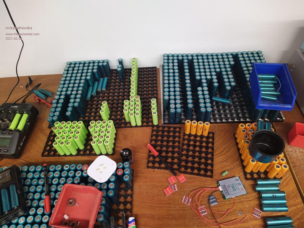

Situation, I have about 3200 lifepo4 of the newer (orange color) 18650 type of valance cells to recombine as battery packs. They all measure ranging from 1250 to 1400mAh each, each are capacity tested.
I also own the older (blueish color) out of 2006 batteries, ready for another 5 to 6 packs, more then 1600 cells capacity tested, they are from 700-1300mAh. I know maybe not worth the effort. But they still hold charge for more then 2 years. I ruined a few original battery packs a couple of years ago, I fully charged them and put away for a long time, watching the self dicharge. Then they had a full capacity test. These I want to use for a home battery at my parents, because rules changed in Belgium, we will get 3-4,5ct/kwh for injecting and we will pay about 25ct/kWh for using. So a battery of about 5-6kWh can pay itself when no more then 100eu/kWh is payed, in about 3 years.

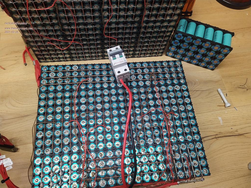

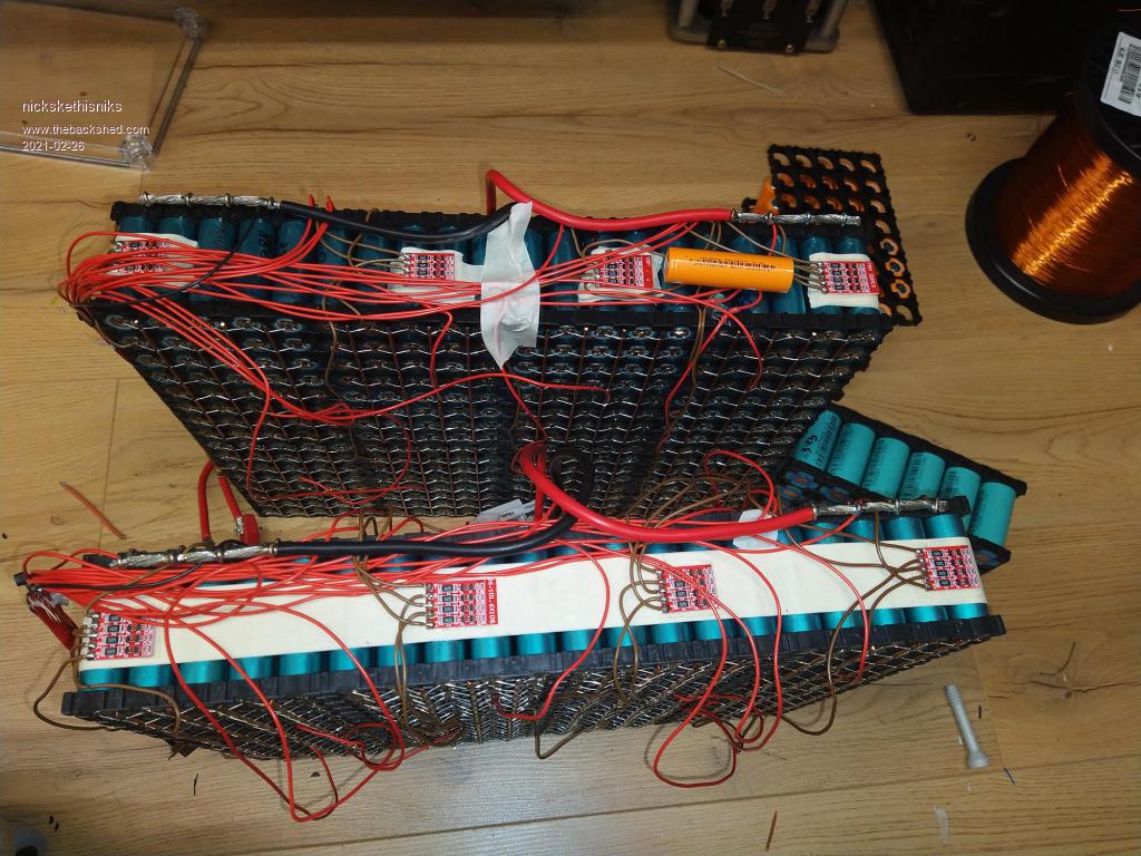

This is how 2 prototypes are looking at this stage:
What do you think, any suggestions are welcome.

Looks like a lot of nice work there, I haven't seen many of these in Lifepo4 apart from some of the A123 type, (I let the smoke out of one) but should work ok.
16 nice square bricks of 24 cells, I looked at all this a few times to be sure, the 3 wire bus bars joining each brick together should handle the power quite well, are they 2 or 3mm copper rod?
Doing it this way looks like it might be a lot to look after and keep balanced, but with all those balances it may well take care of it self,
I have noticed and others have said that lifepo4 cells tend to runaway when they get close to full charge or there about's, Where as the Lion type are not so fast or drastic around full charge, so the charge controller settings would have to be very strict.
I would have made them as parallel groups, would require less but bigger balance's, however the setup you have looks like it will perform better with that many separate balances, and you could also disconnect 1 brick (for service) while keeping the rest in place working.
looking forward to see how it performs
great work once again.
Cheers Aaron

Hi, since these are old cells I want to use them for some long, low power, probably constant loads max 4-5A for the pack, about 1/5 C. So I used 2.5mm^2 and 4mm^2 wire, that's 10 to 12 mm^2 combined, so a bit overkill but this wires are leftovers from my home electricity.

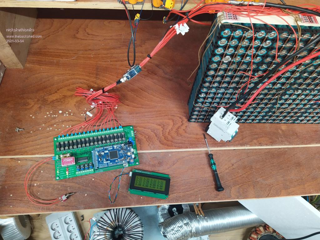

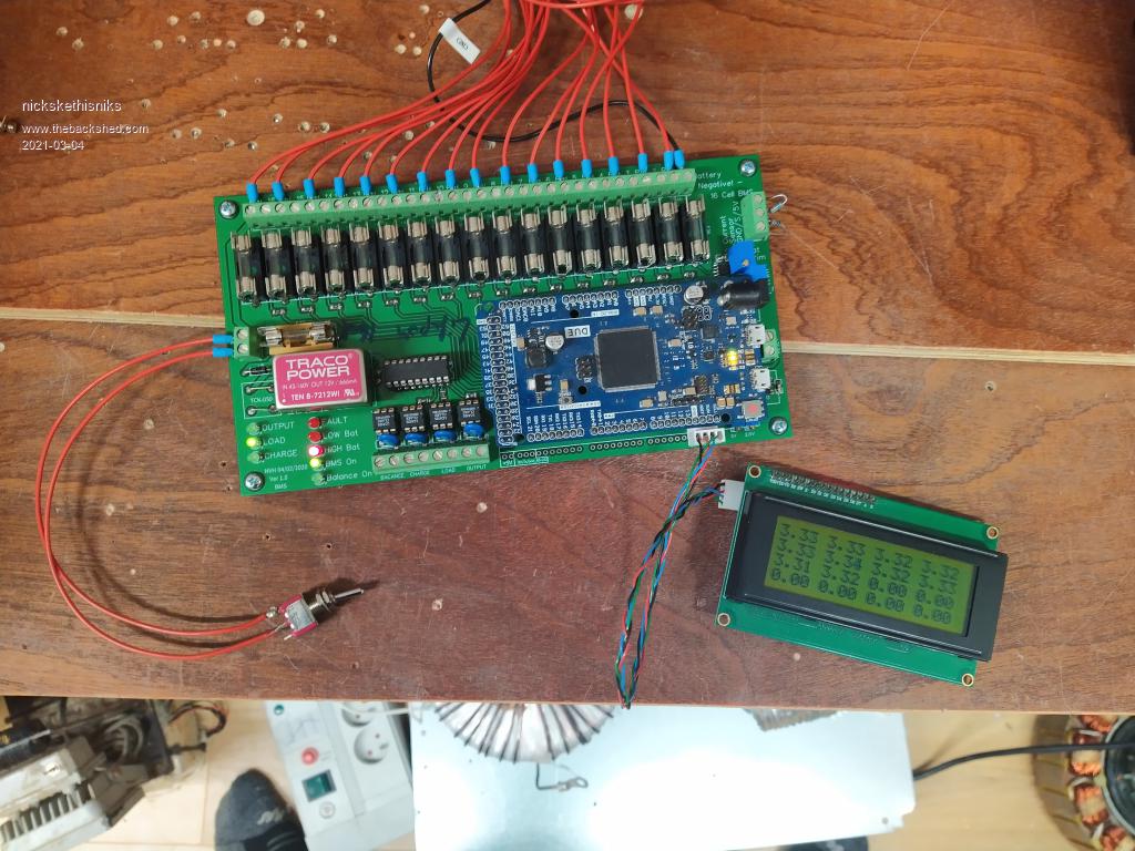

I did solder some extra measuring wires connected to a db25 connector, this way I can read the voltages of the parallel bricks. And maybe add some temperature sensors.
I did design a "universal" bms, this one is loaded with firmeware for a 10cell lto battery. Changing the dcdc makes it suitable for each battery with 4 to 16 cells.
Yes, the downside doing 48v bricks is, it makes the bms part more complicated.
The plan was to connect each measuring db25 connector parallel but with a PTC/fuse in series.
But it got me thinking to build a smaller "budget" bms to add to each pack and do communication with a central isolated uC.
I don't know yet.
