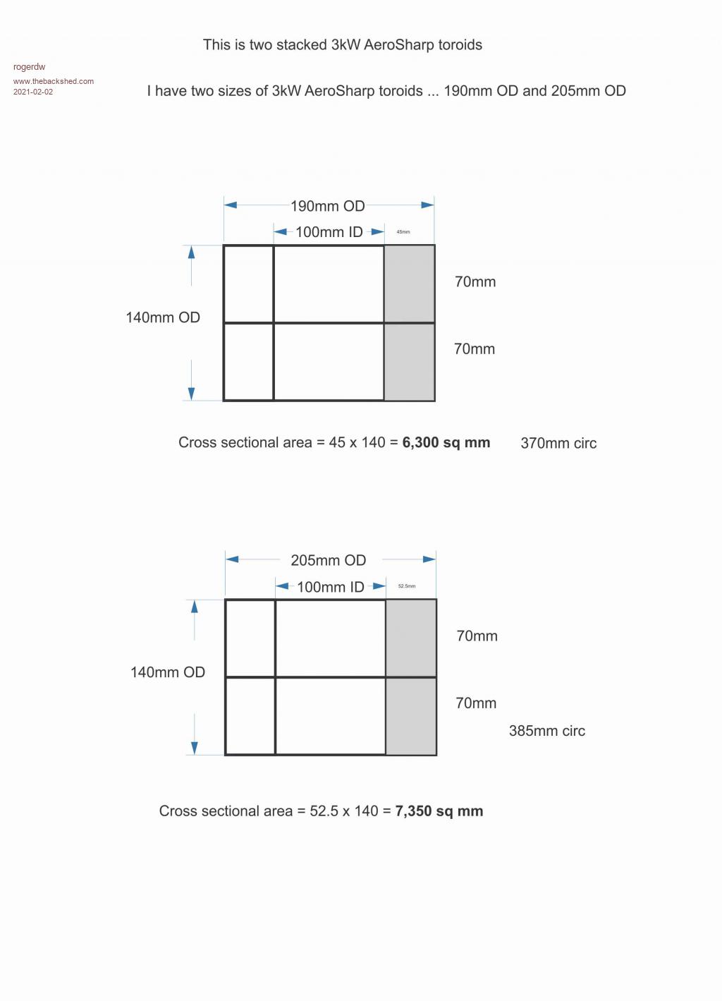

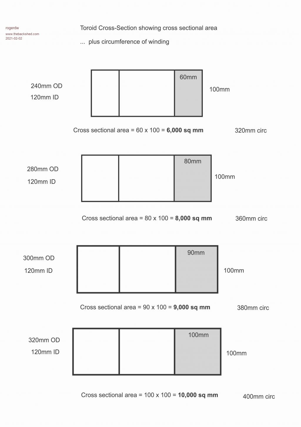

That's very helpful thanks Tony. I know it hasn't been proven yet but I have to make a start sooner or later  ...  and very handy to have some numbers to aim for.
I created a couple graphics showing the cross sectional area of 2 stacked 3kW Aero-Sharp toroids  ...  one pair at 190mm OD and another at 205mm OD
...  and the circumference of the winding area.
Then another graphic showing increasing diameters at 100mm high.
Cheers,  Roger

O/k, let's think about this logically.
We start with a 120mm hole, and if we allow for equal copper areas primary and secondary, the secondary should fill up the hole, leaving 70% of the original hole remaining (actually 0.7071 or root two).
So that we end up with a hole 84mm diameter after winding on the secondary.
We have 18mm + 18mm available for the secondary (120mm - 84mm = 36mm) and we are going to lose 5mm with our spacer. So 13mm depth of copper on the secondary.
If 1.8mm wire is used, six layers might be possible in practice.
1.8mm wire is 2.5mm squared. At four amps per mm/sq ten amps per layer. Wow !!
However many layers we can fit, the last final layer of the secondary will have a diameter of 84mm, and a circumference of roughly 263.9mm.  That is going to be our tightest secondary layer, so that sets the limit for all the preceding secondary layers.
With 1.8mm wire that would in a perfect world be about 146 turns. My guess is a genius may be able to get about 135 turns on max on the tightest last layer.
Anyhow, lets look at how many turns we actually need.
We go to our trusty Flux calculater :
https://daycounter.com/Calculators/Max-Flux-Density-Calculator.phtml
and plug in the numbers:
Secondary voltage 225v for the largest transformer.
Frequency .00005 Mhz (four zeros for 50Hz)
Number of turns by trial and error = 101 turns
Core cross section 10cm x 10cm = 100 cm square
Press the magic button and we get 10,035 Gauss  = 1.0035 Teslas our target flux density.
So five or six layers of 1.8 wire and 101 nominal turns will fit very easily.
We may need to go up or down a few turns to get the turns ratio exactly right, but 101 +/- a few turns would be our initial first guess.
In fact you could probably go down to a 110mm hole.
Should be capable of fifty amps easy for the whole inverter or around 11.75 Kw.
Maybe that is too big for you ?
If so, rinse and repeat with a smaller core, maybe 90mm x 90mm cross section ???
And fewer 10 amp layers.
But remember, a smaller core requires more turns, and the walls can quickly close in on you.
Smaller is always cheaper, and easier to work with.
If you go through this exercise a few times, with a bit of guessing about what will fit, being EXTREMELY conservative, its possible to come up with some numbers that look reasonable.

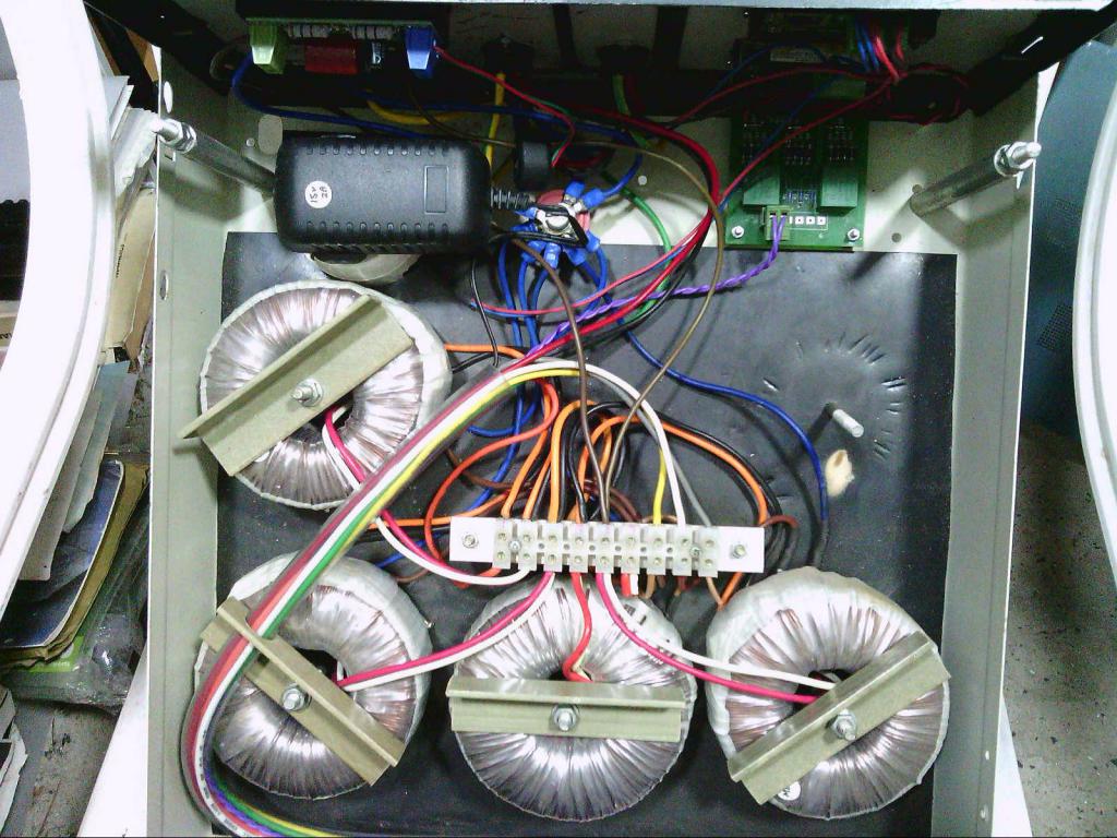

I used 300 watt commercial toroids in mine with 230v primaries.
Main transformer not needed because I was switching +/- 225v dc directly.
Then 3 x 300watt transformers = 900 watts
Then 1 x 300 watt transformer
And 1 x 100 watt transformer (removed for another project in the picture below)
I would not recommend anyone doing it this way.  Having no large transformer can send 225v dc to your house appliances if you have an inverter failure. That happened and did a lot of damage. Never again !!
Edited 2021-02-03 09:49 by Warpspeed

Ok, so if I order a 300mm OD x 120mm ID x 100mm high for Tx #1  ...  that will give a cross sectional area of 90cm sq
...  and if I use 44V as my lowest voltage  ...
The online calculator gives 112T for the Secondary
112 x 44/225 = 21.9  ...  so 22T for the Primary
Tx #2  ...  a 3kW toroid  ...  cross sectional area of 36.75cm sq
The online calculator gives 92T for the Secondary
92 x 44/75 = 53.97  ...  so 54T for the Primary
Tx #3  ...  a 1.5kW toroid  ...  cross sectional area of 26.08cm sq
The online calculator gives 43T for the Secondary
43 x 44/25 = 75.68  ...
If drop to 42T for Sec  ...
42 x 44/25 =73.92  ...  so 74T for the Primary
I haven't fully unwound my #4 Tx so not sure of the dimensions yet.
I wasn't really aiming for ridiculous levels, but if I'm going to do this I'd rather do it just the once and do it well. It sounds like I should be able to fit 6 layers for each of the secondary's  ...  so that's 60 amps. Phew!!!
Am I on the right track Tony, or am I off in the scrub somewhere?
