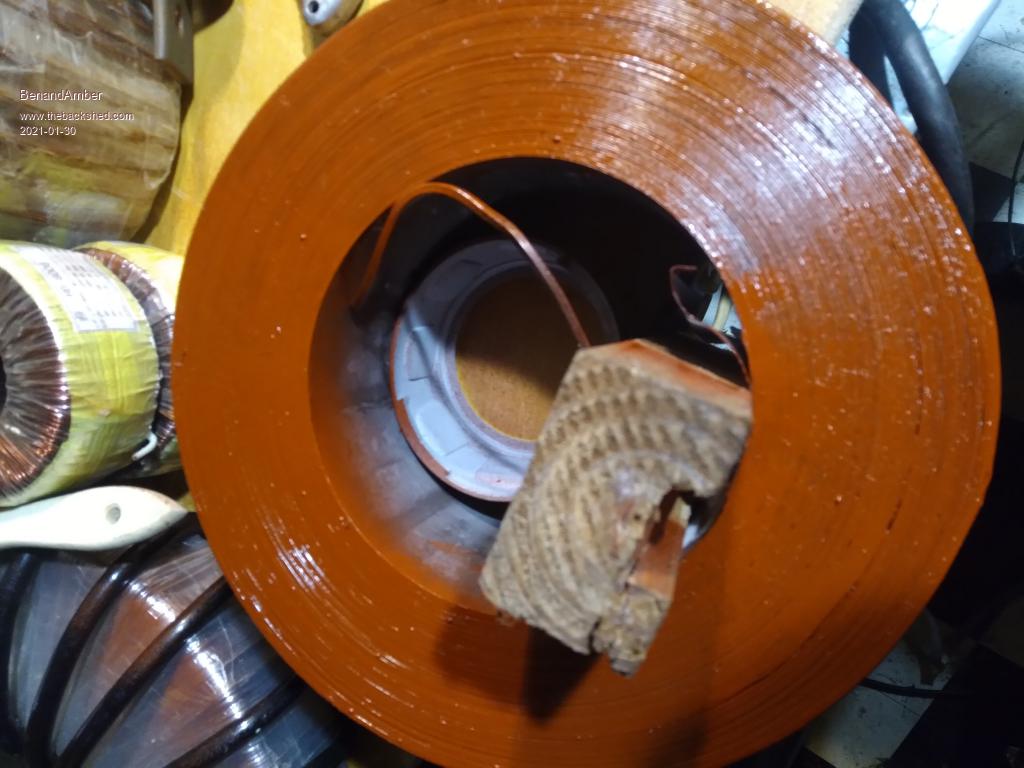

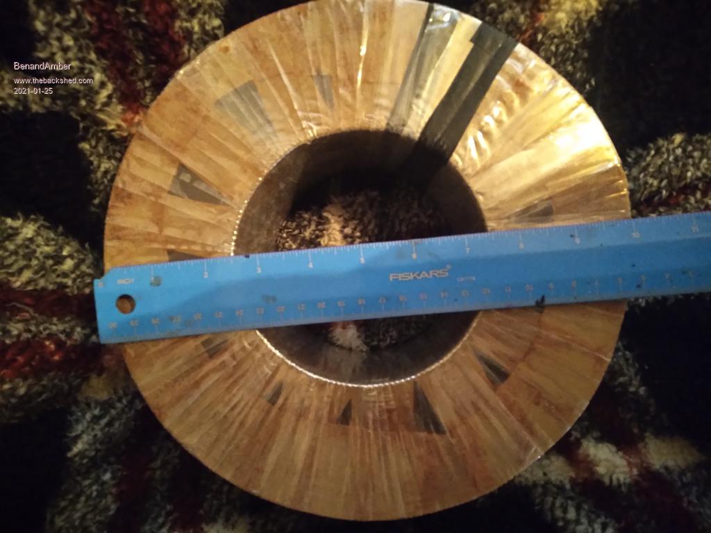

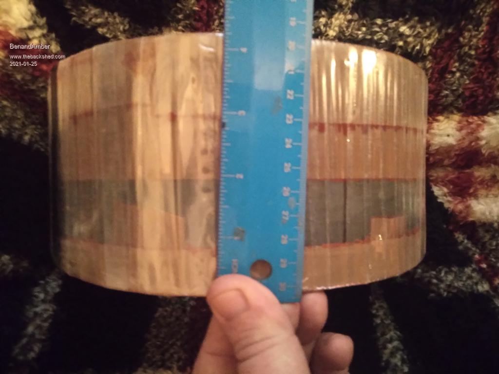

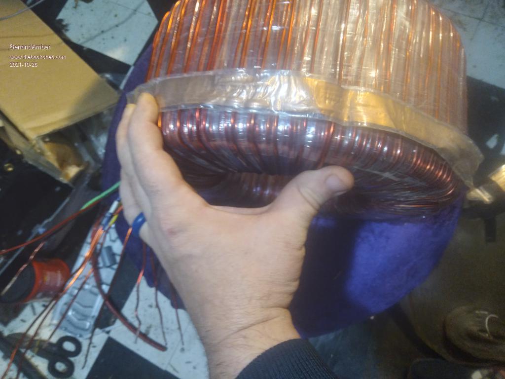

I ordered 23 pounds of 12awg wire to go with what I already have
I am thinking about removing some of the core to make more room for wire
This is definitely overkill for me
A few pounds out of the hole i think would make for a better tranny
It would allow me to wind on more copper
After winding a bunch of trannys for testing and lots of help from the people on here i have fingered a few things out
It is all about how much heat will be in the core
If you dont like using fans you will need a bigger core
If you want to use a leaf blower you can use a small core with more copper
For myself i hate hearing fans and think dust is bad
I think oil will be the future of inverters but that is just a opinion

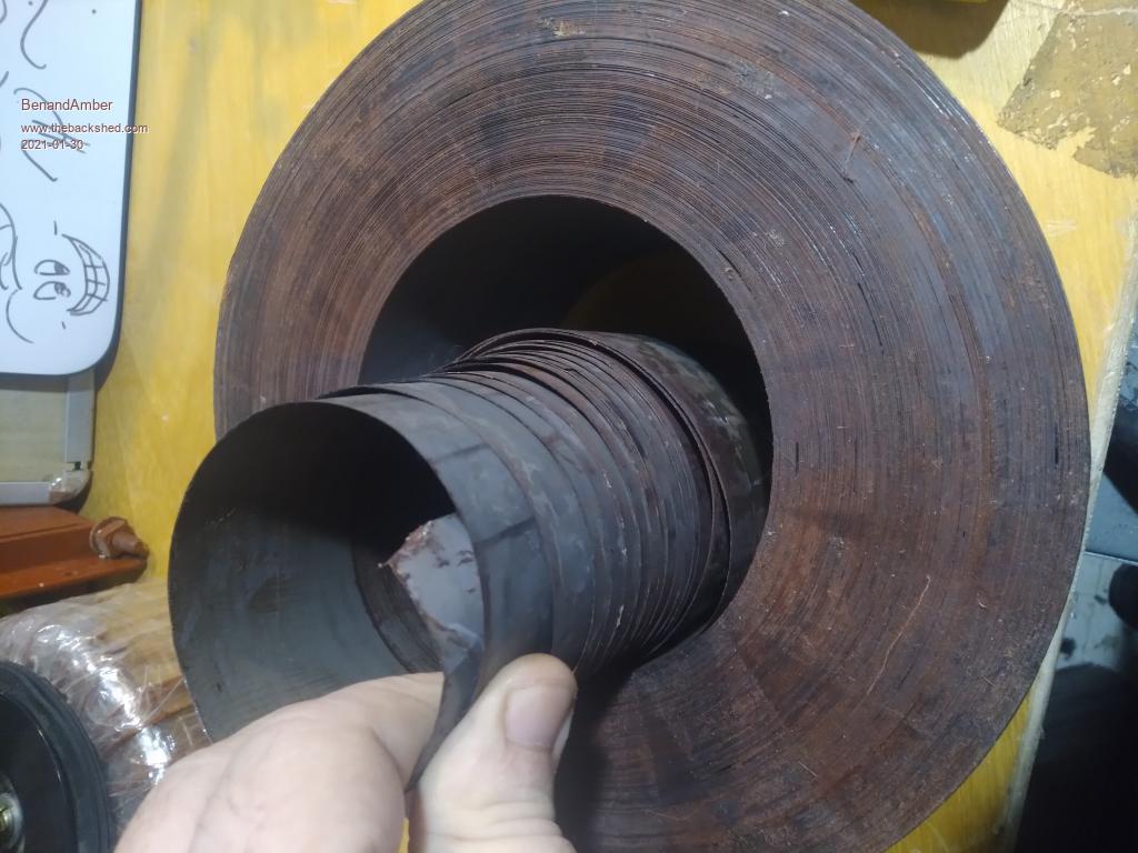

Sid a friend gave me the core
I think it is a 20k Power Jack core
I took some metal out of the center
I wanted more room for copper

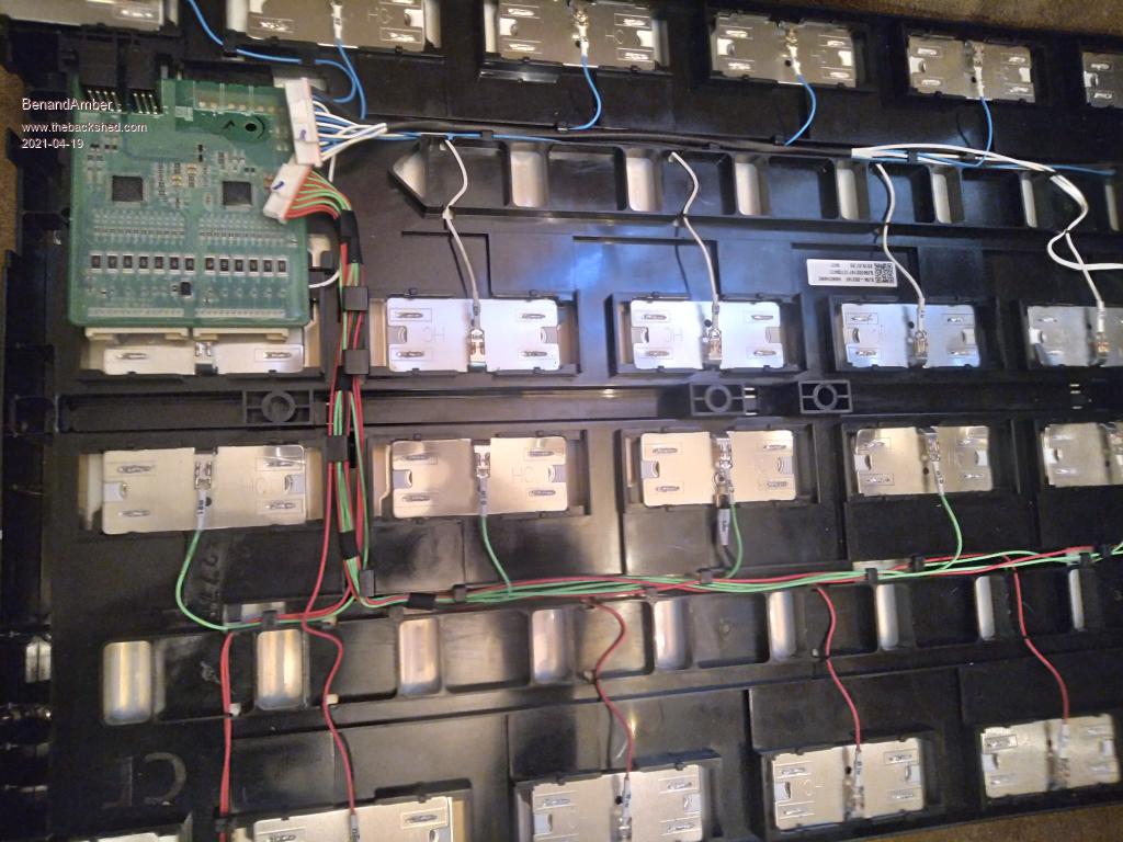

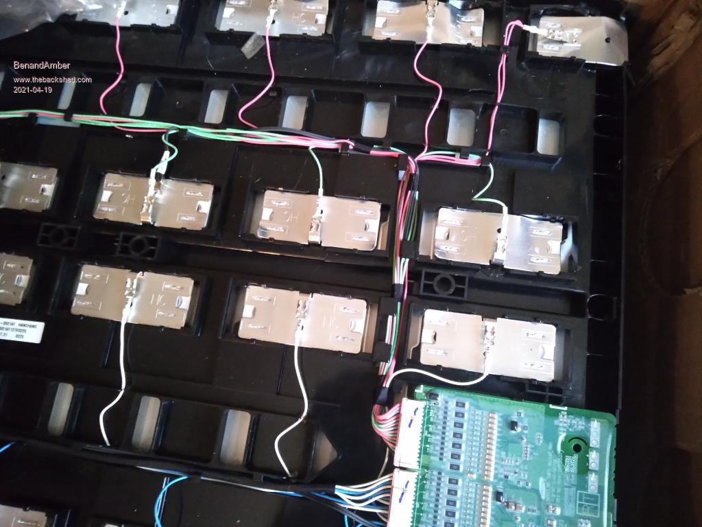

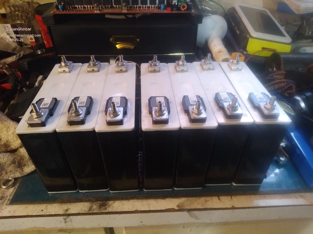

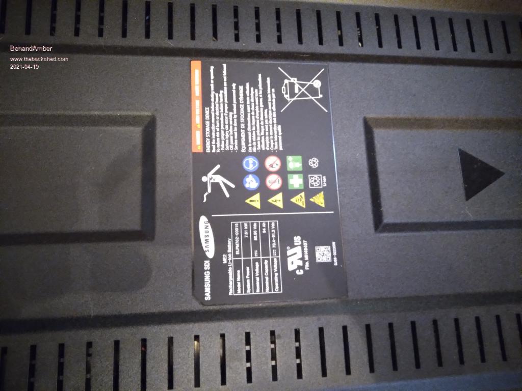

My new batteries arrived one of the modules is a little damaged
The cases are made extremely well
I am not that picky so I didn't make a claim
My new power cv cc supply  came in also
Maybe with it I won't be melting the solder off the legs of my hy5608 lol

I will most likely make my new batteries 14s they come as 22s
I have been thinking about 16s but that may just make things more difficult
The higher the voltage the better is my opinion
I got a good deal on these brand new never opened batteries
The specs are really good no long waiting and hoping they are in the us
So I couldn't pass them up
My buddy's balancers will be up for sell soon so I will be using them
They are capable of many amps so can keep big banks balanced
I can give the link if anyone is interested in the batteries or balancers

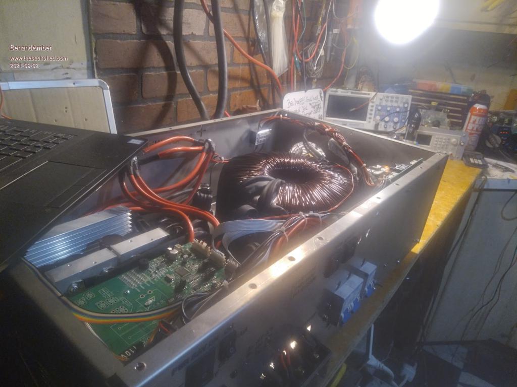

Ok I got a good one for ya then

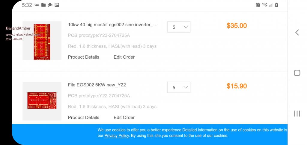

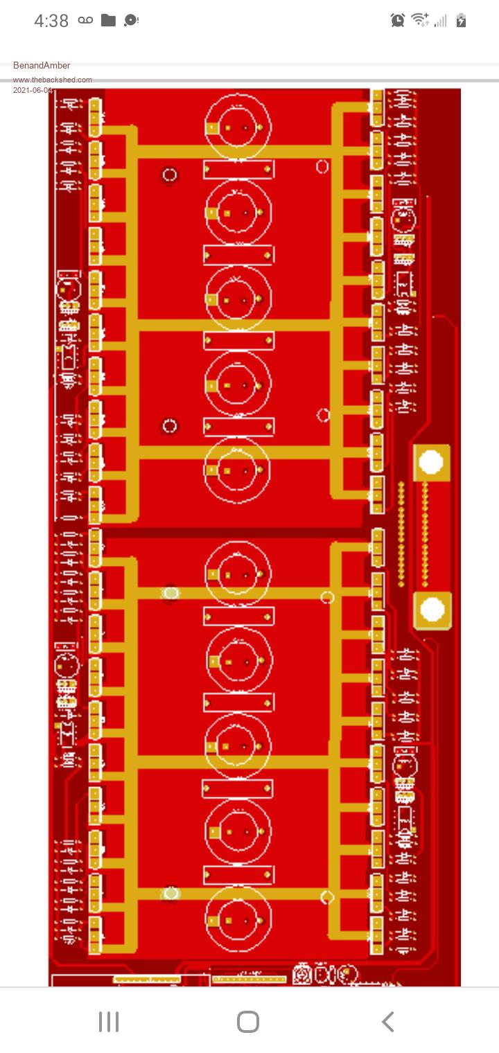

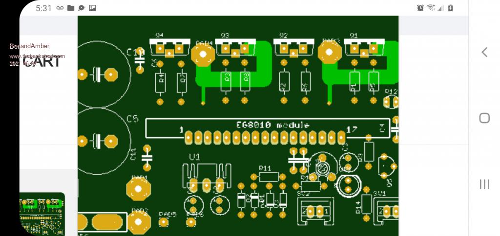

And with all the talk lately about shoot through with paralleling mosfets it may get a laugh
Only 36 bucks for 5 boards jlcpcb lol
Yes I uploaded Gerber for kicks and giggles
I was thinking about sending a few out to get a laugh

If you didn't like that one maybe th his one is more your speed
The 40 mosfet one was 35 bucks

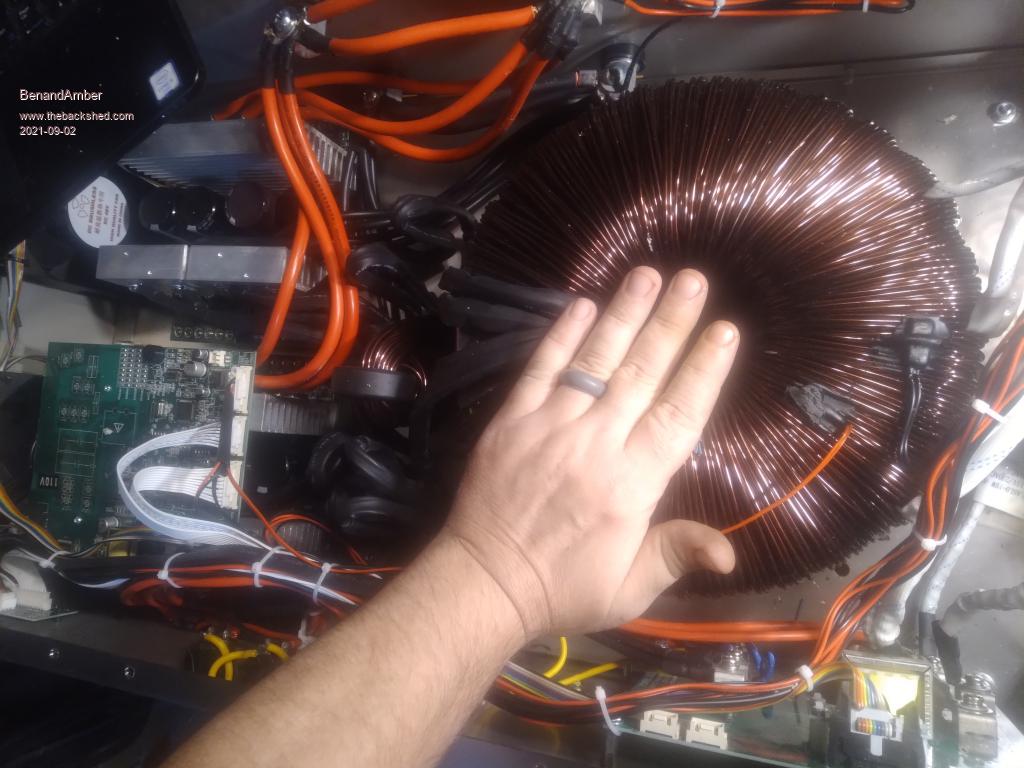

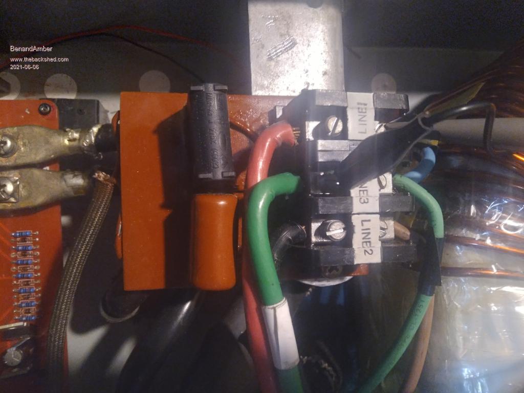

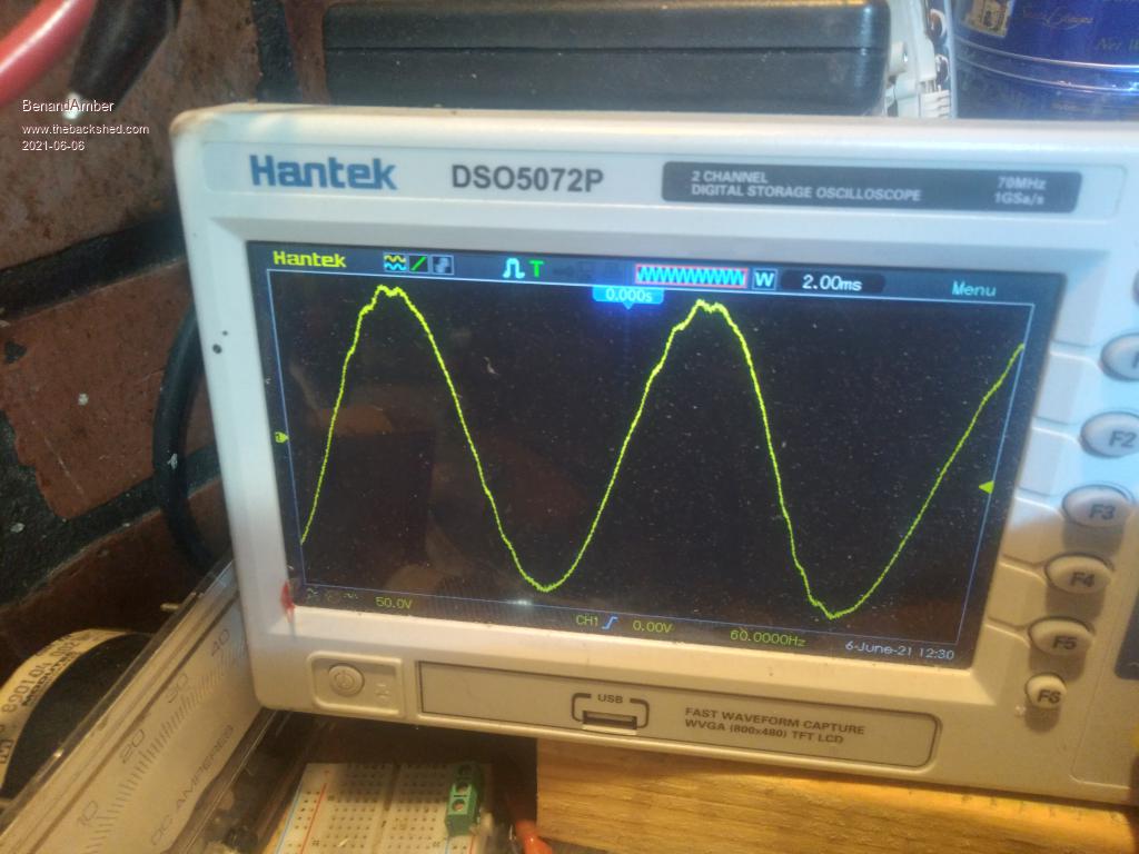

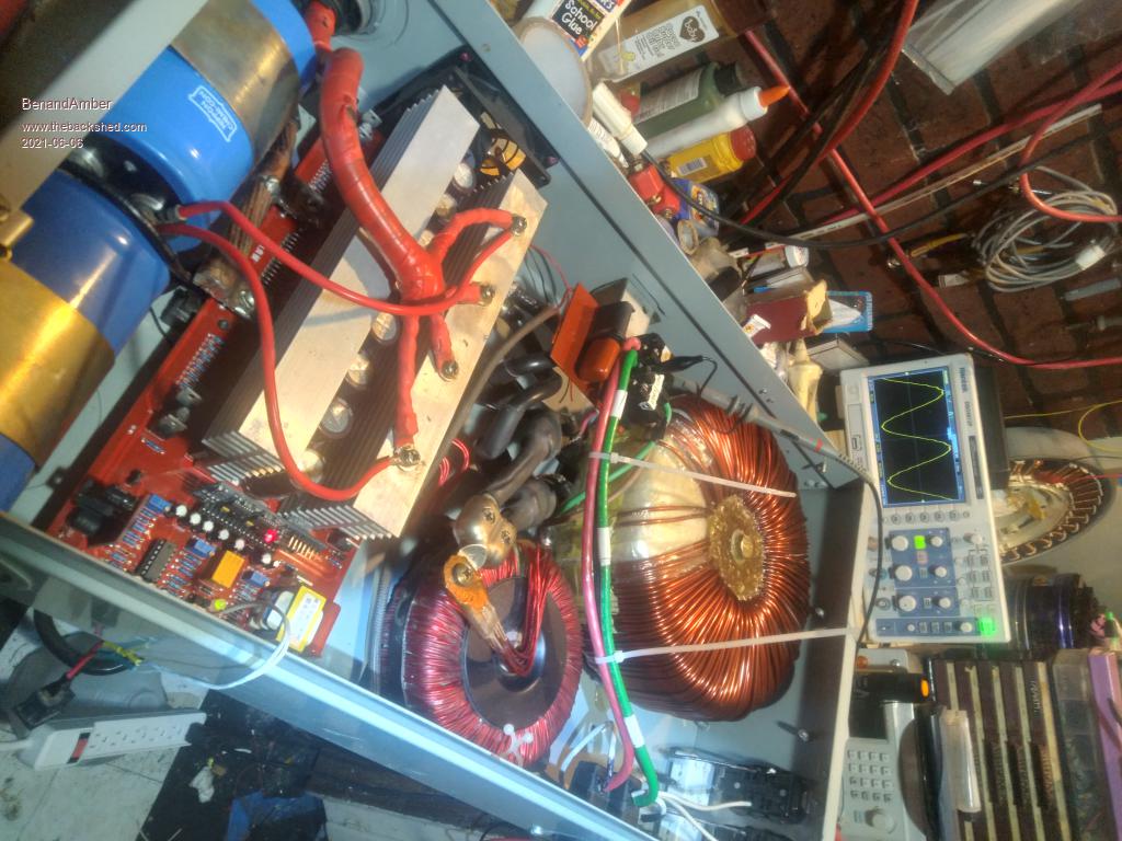

There is a wiggle at top and bottom as seen seen in pics
It kinda seems like it is pulsing by the very low hum and how it looks live on scope
Kind of a little rev up and down but it could be in my head lol
I took three pics the wiggles almost not there in one pic another just had wiggle on top
I uploaded the third pic
The back ground of inverter pic also happens to have wiggle top and bottom

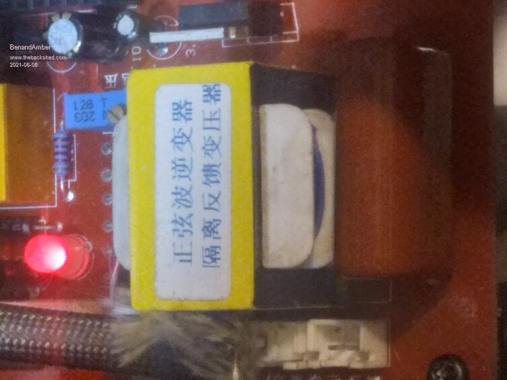

There is a filter cap on the inverter board by the little step down voltage feedback transformer
There is two two pin plugs side by side that seems to be for voltage feedback
They have continuity in between them with the beep test
Farthest right pin of first plug and farthest left pin of second plug  beep then the two inside pins one from each plug beep
Even though they shere continuity could only one plug go through the on board filter cap?
The small red board close to tranny that has two filter caps on it and a three way screw down connector
The three terminal screw down connector
Joins the tranny two the outlets
Each of the two filter caps on this small board have a leg going to the center tap zero volts of tranny
the other leg of each going to opposite 120 volt legs of tranny output
The voltage feed back is not hooked to the center tap it is 240 volts back to the board
Out put voltage dose move around a little
but not even a volt
maybe my volt meter is not fast enough to catch it if it is fluctuating more than 1/2  volt
I am trying to figure out why any ideas?

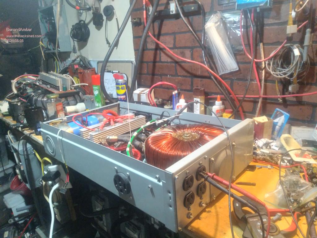

I have used this inverter for a long time
It was 120 volt only the last year or two
I rewired it for 240 volts and added some big dc input caps
The idle is not to bad
But the wiggles bother me
I also put two outlets in it one off each leg of 120 volts and each have resetable fuses
The bus plugs into the big 240 plug
Edited 2021-06-06 15:06 by BenandAmber
BenandAmber
Joined: 16/02/2019
Posts: 961
Posted: 05:22am 06 Jun 2021

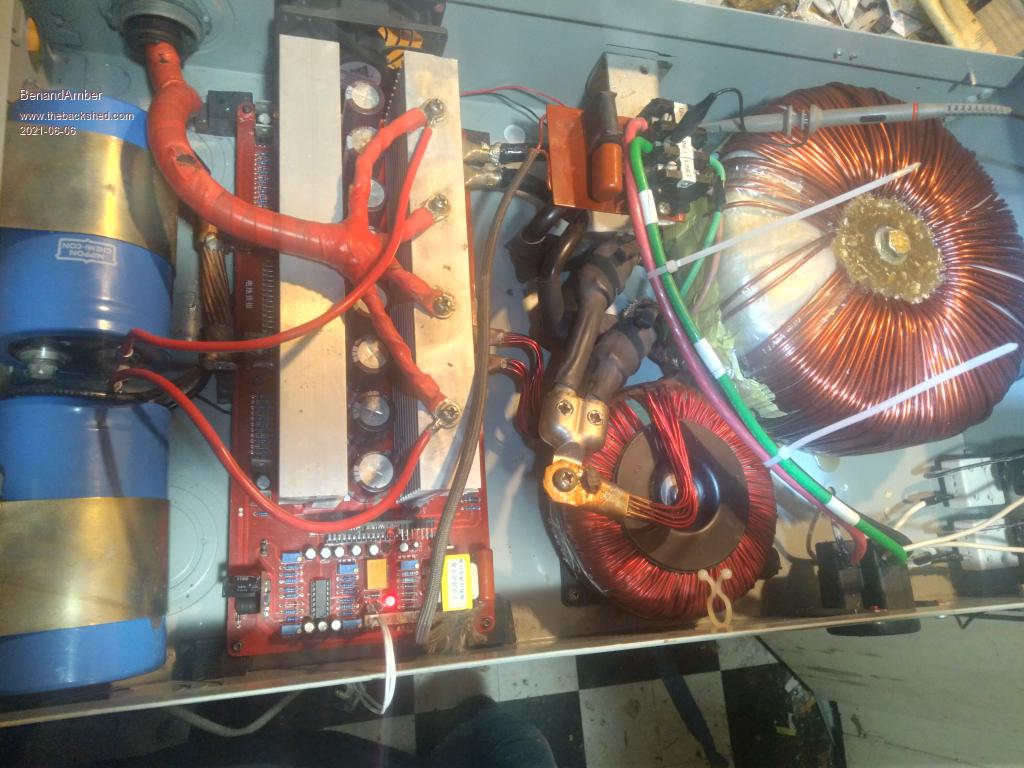

It definitely sounds like it is revving up and down
tranny is so quite you almost have to put ear on it to hear it hum
I didn't wind this tanny the ones I have wound don't hum at all at idle
Warpspeed instructed me to wind transformers
His way makes a salient tranny with lowest possible idle loss
I am very grateful he told me 5 billion times until I finally understood!!!
This inverter didn't do this pulsing the last year or two when hooked up as 120 volt only
I used the builtin on board filter cap and another across 120 volt out of tranny
This is the same tranny
Before the two windings was paralleled
Now they are hooked in series with one wire of each winding being center tap
Got to love usa electrical system
I always check dot with ligh bulb switch trick before hooking winding in series or parallel
As I was taught on here
The inverter is putting out 120 on both legs and 240 across both legs
This inverter board has a current shunt built into the board on the negative side
The big caps are hooked in after that shunt on negative bus bar on bottom of the board
The positive is hooked into positive heat sink
I used sawdust in resin when potting tranny
I am thinking the backfeed circuit is not getting filtered enough
But I would really appreciate some input from you guys
Thanks everyone I appreciate you guys!!

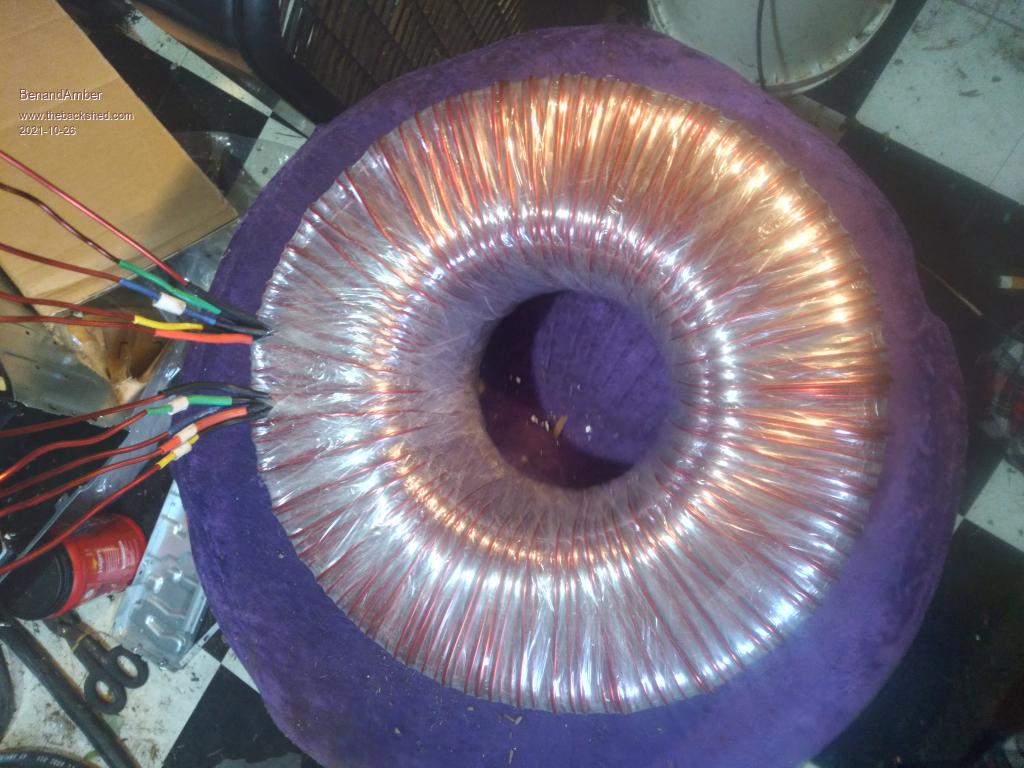

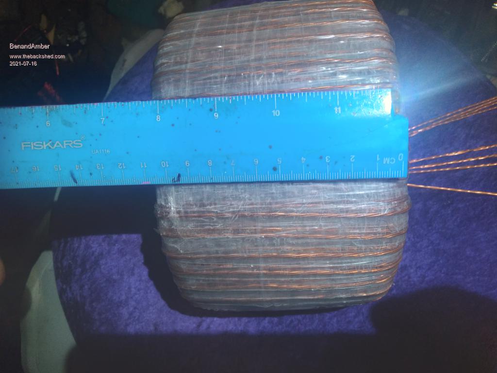

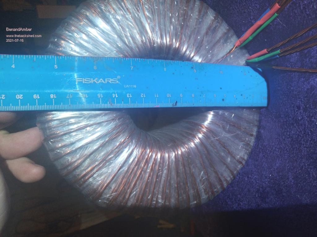

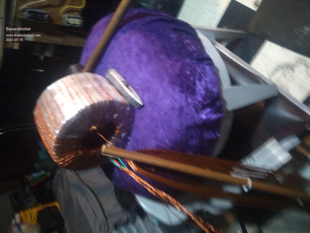

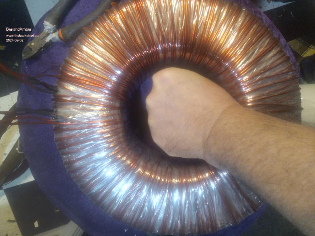

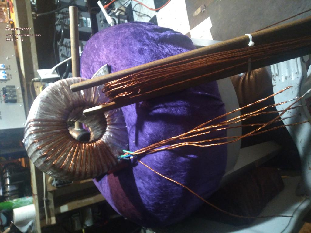

A good friend's tranny I wound for his 8k power jack
He wanted it to do 5k
I twisted 4 around 1mm wires together to make each wire
All of them are 120 volt windings that will need put together for center tap so it will be 120 volt and 240 volt
No low side yet but the low side is fast and easy if there is enough hole
This will be a tight one like usual
I am happy if I have room for a bolt lol

BenandAmber
Joined: 16/02/2019
Posts: 961
Posted: 06:48am 02 Sep 2021
This tranny is over 100 pounds
I think it is a 25k pj
We have 4 or five sets of fets plan on seeing what it will do with a genetry solar driver board fun fun fun
I might get the chance to test and try to blow up a 12k genetry solar inverter before there ever on the market
can't wait!!!
There driver and wifi board is incredible and is tougher than nails it has everything and you can custom change anything from your phone
it even has built
In oscilloscope it will do 12 24 36 or 48 volt batterys And voltages in-between all those and likly higher than 48 volt bank
With out buying nothing muti tap tranny
A long while back I was trying hard to break the GS wifi and controler board
you should have seen felt and heard a over 70 pound tranny dancing and shaking my whole shop when I shorted the high side out to its self and powered it up
It was a awe inspiring moment!!!
I melted the solder off the legs of 360 amp hy5608 mosfets I beat that thing to death we nick named it un blowable
the mosfet drivers pushes 8 amps
After that sid turned on over wifi the protection stuff that would not let it happen again lol
Like I said it is tough!!!
Friends big pj inverter
Tranny for my next inverter it is going to be stupid heavy
Plenty of hole for 4 more 2.3 mm windings making 8 in total may do ten and then the low side winding
Edited 2021-09-02 17:43 by BenandAmber
