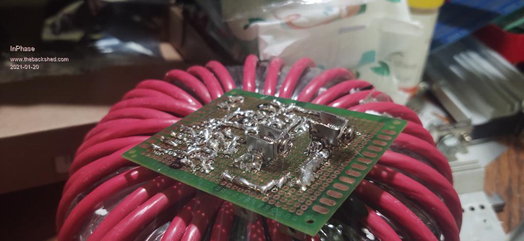

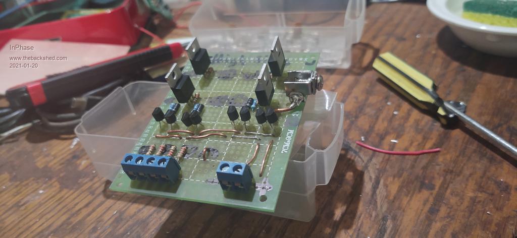

Just finished putting a small fet test board together. Those mosfets are rated at 95 amps, but I don't know how big of a heatsink I can get on there. We'll see. I only had 7 cm x 9 cm perf board, so I didn't have room for the opto isolators I want to use. I'll put those on another board that plugs into this one. The totem pole driver is made from 2n2222/2n2907 complementary BJTs. More to come!

I had so little room on the small board that I had to put the primary output on the under side... Don't judge me!

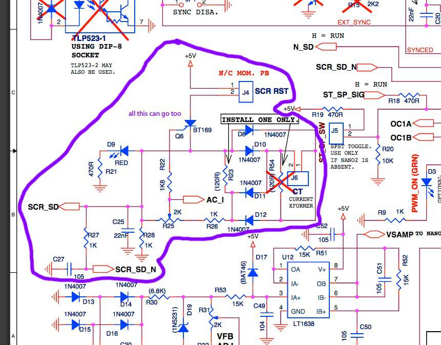

Had a little time to get on to this forum. I don't know if this is still needed. Crossed out components are not needed for dual nano basic operation. It was a long time ago, so this is what I remember, I hope others will check for errors. See attached pdf

Tinyt: the pdf is correct. put the jumper on sync disable to ensure it stays LOW.
And if you will not be using SCR OC shutdown, which I don't, no need for the below.

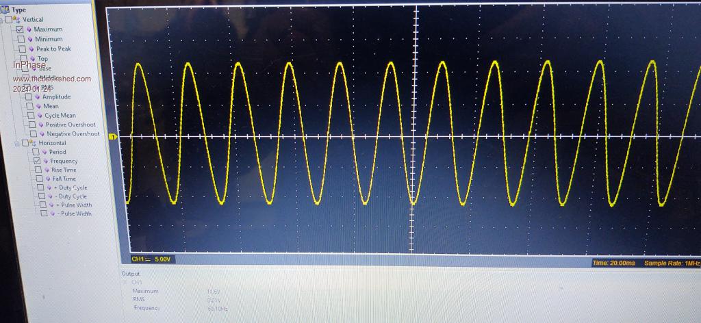

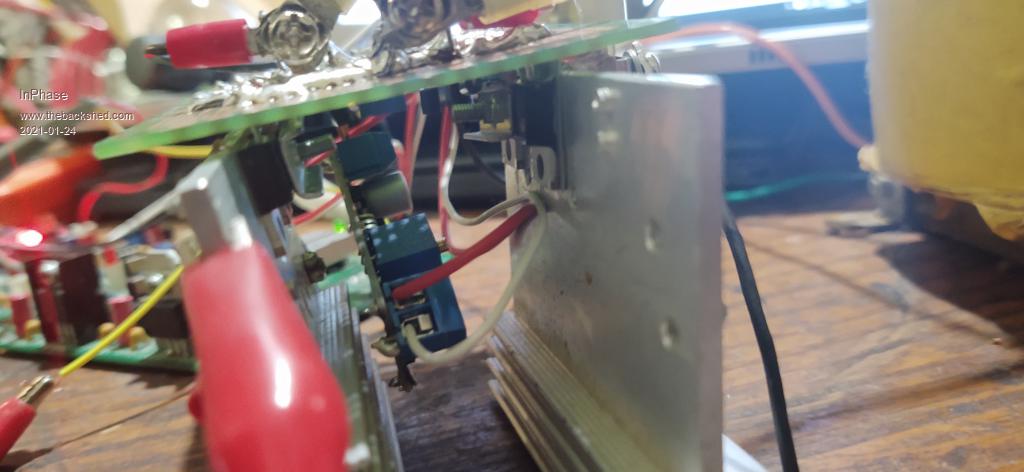

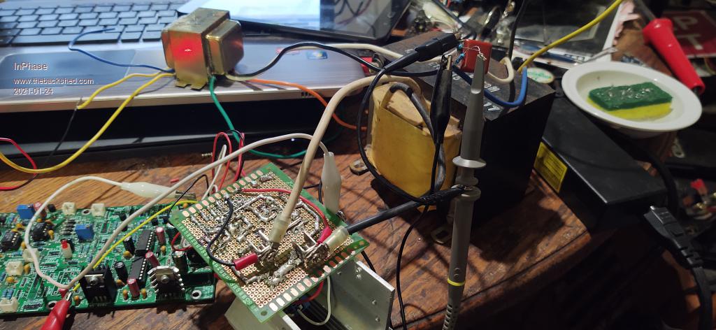

Hey thanks tinyt and Peter! I've just today gotten a Nanoverter into a condition to output power. It is an utter mess, but it works. I only have a 20 volt power supply on the bench, but it performs nicely with the limits of that source. The 60 Hz sine wave is rock solid except when I push the VFB all the way up. I have to back off of max a couple of turns on the pot else a strange ripple choices through the sine wave. But that's OK, because I was just testing the limits.
I'll get some better pics when it isn't live and I take it apart.
