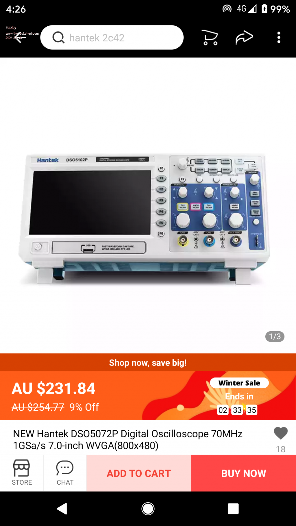

This is the one I got, haven't used it hardly, but it has plenty of features and not pricey.
Cheers Caveman Mark
Off grid eastern Melb
Posted: 07:41am 16 Jan 2021
That looks like an excellent buy Mark.
