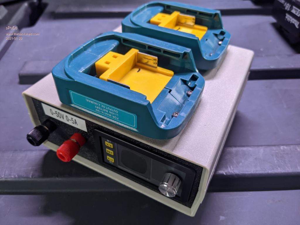

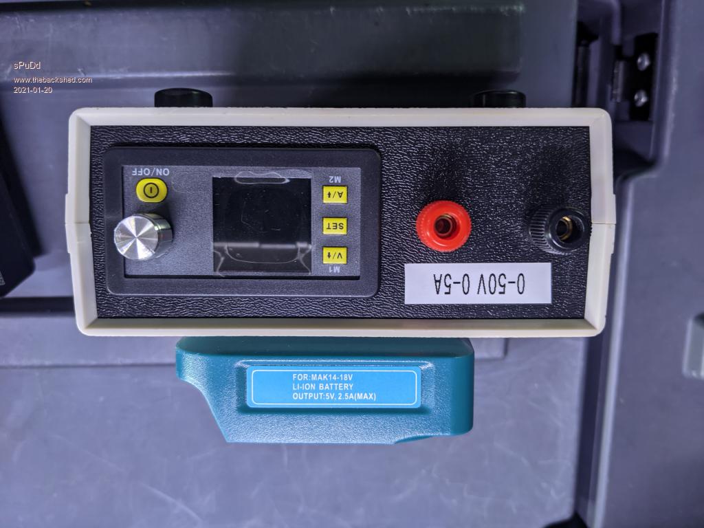

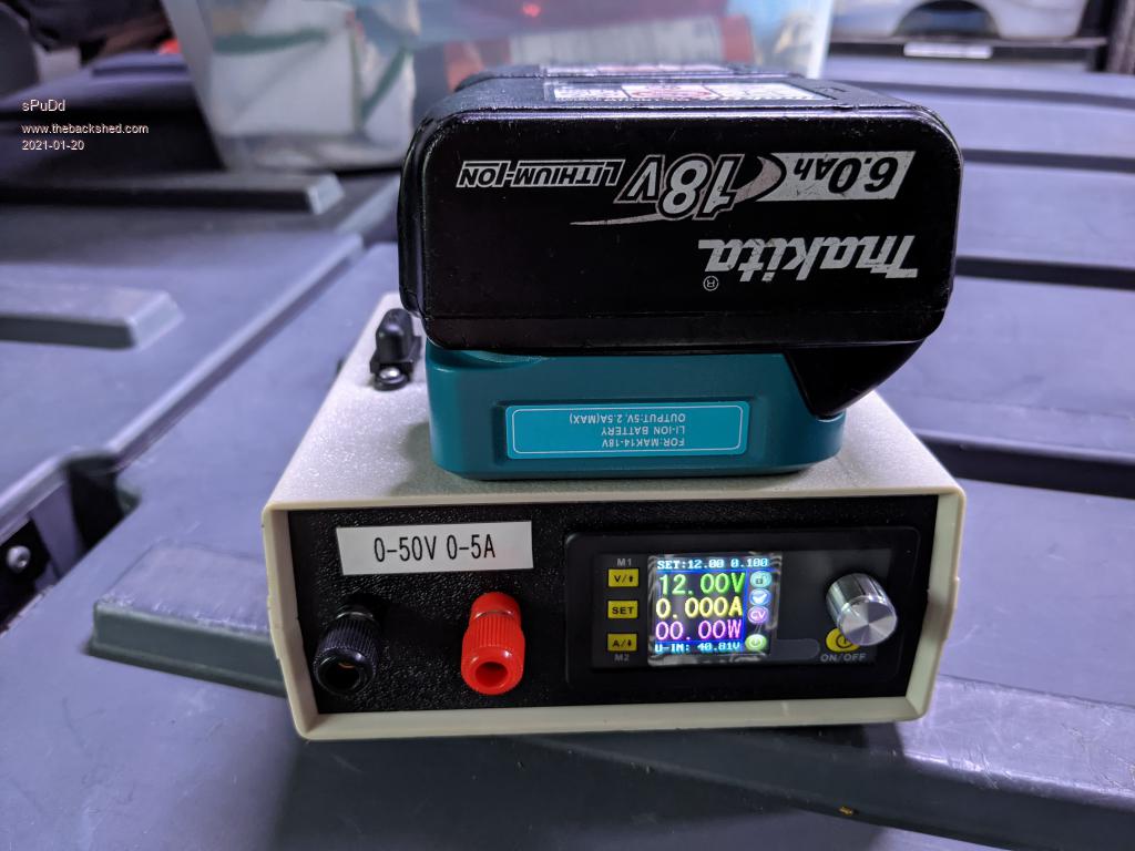

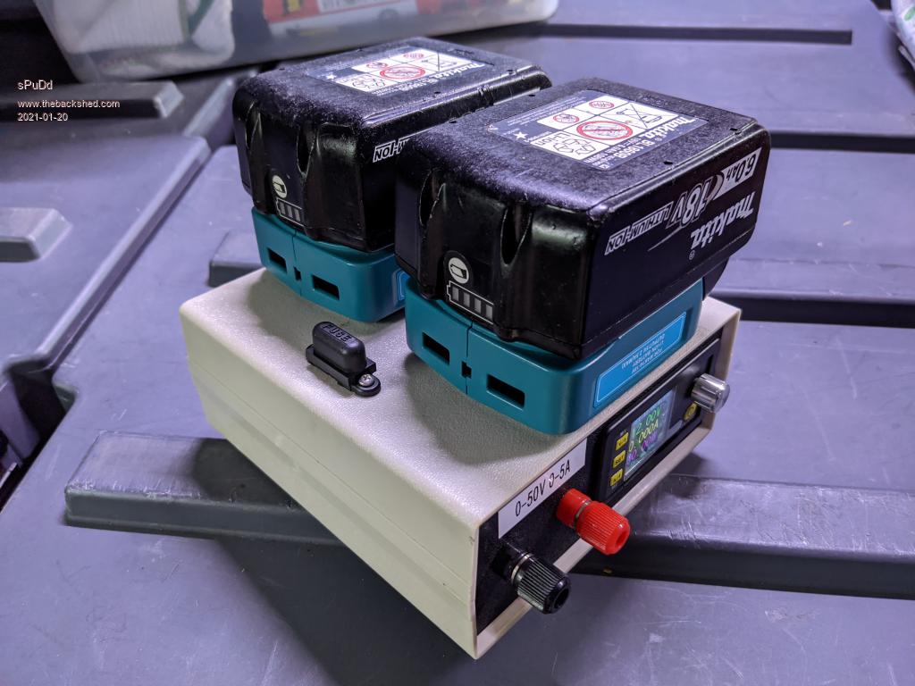

  it makes sense that it would use a boost DC driver for the LEDs. Can you try driving the LEDs with your bench supply? Maybe a few batteries in series with a resistor if field testing is difficult.
I made a field battery powered test supply using a DPH5005 50V 5A buck/boost PSU from the usual suspects driven by two Makita 18V battery packs in series. It's proven to be very useful at work and home.
Project case, Makita knock-off USB adaptors, inline fuse, all good.

Cheers on the little field PSU. Only took about an hour to fit it into the case & wire up. I'm on the Makita platform so I used them, but the same thing would work with any brand, or even some other kind of portable battery.
