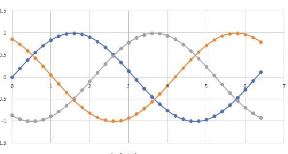

It is simple to generate the 3 SPWM (sinewave pulse width modulation)
and to have them output 120 degrees phase difference to each other.

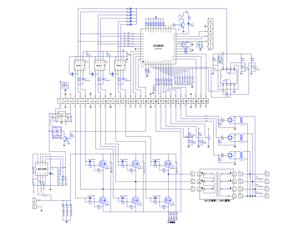

There are already ICs that do this, the EG8030 but you and I know it's
far more fun to do it yourself. And you get to control everything about the inverter
behaviour.

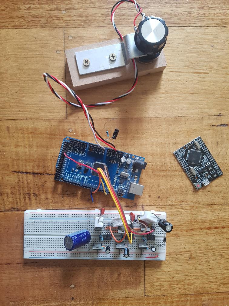

here is the test setup, with the new type Mega board at the right for size comparison.
These boards cost $18 from ebay, probably 1/3 that from aliexpress

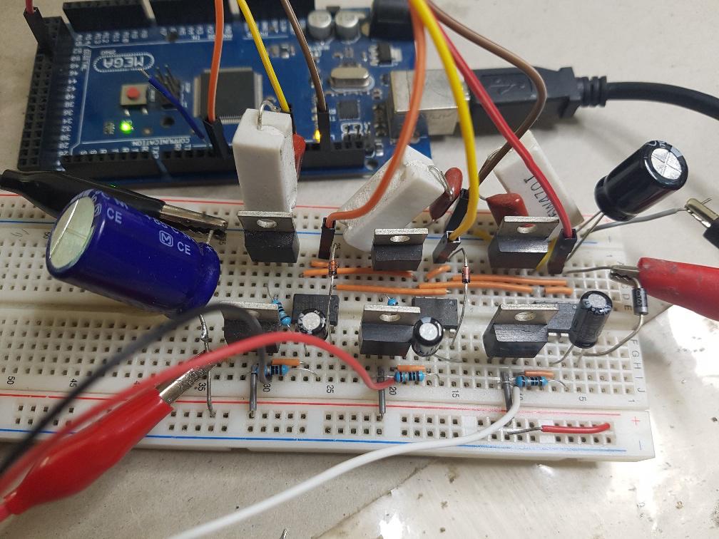

and the 3 half bridge MOSFET drives. I use IR2004 1/2 bridge drivers since I had them here already. Each 1/2 bridge has a low side MOSFET and a high side MOSFET.
The high side FETs need the diode/cap charge pump.
When running this with about 1.5 Amps at 25V into the AC servo motor the MOSFETS
remain at room temperature. That is a sign of fast switching.
There are 3 x RC snubbers on the low side. They help a bit to reduce
problems from doing this on a breadboard.
Motor DC supply on the left. 12V IR2004 IC supply on the right.

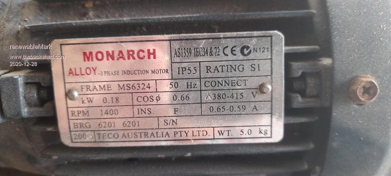

  poida said  I was thinking during the after dinner walk:
maybe you could use something that did mppt on a solar array, put that power into
a large capacitor or small SLA bank, then a 3 phase inverter to drive the pump.
Only run the pump when enough solar power is present.
I need a tame 3 phase fractional HP induction motor.
Ebay? gumtree? There are two available at work but we reopen there
on 12 Jan and I can't wait that long.

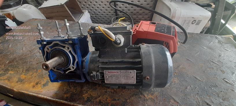

I have a small 3phase in the garage, I'll try and find it.
Cheers Caveman Mark

poida
Joined: 02/02/2017
Posts: 1507
Posted: 11:05am 28 Dec 2020
renewableMark:
that motor seems ideal for testing.
I Think I would like that motor very much.

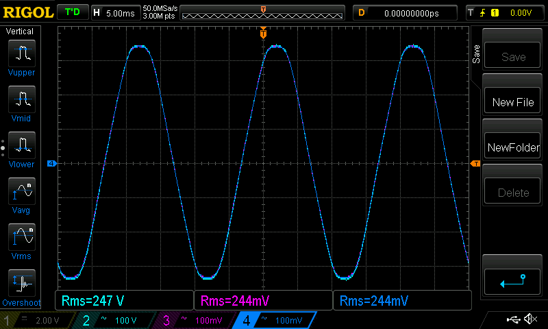

In other news I have spent a couple of hours calibrating the
Tektronix A6902B Isolator.
What is that?
It gives you 2 channels of isolated inputs. Each input may be +/- 500V from ground.
You can connect the ground lead clips to any voltage +/- 500V and see the voltage
on the tip relative to their ground clip.
(All CROs and DSOs have the ground leads connected to each other and this is connected to mains Neutral and Earth. Isolated inputs are a good thing with power electronics)
That, plus the Pirtek DP-25 isolated differential probe will let me probe
all 3 phases with any ground reference for any of the 3 phases.
I plan to have individual AC output voltage control for all 3 phases.
Not just one phase as the inverters we have built so far.
So I need to measure all 3 phase's voltages, all referenced to the neutral,
which will probably NOT be close to DC supply ground.
Even if it was, I will want to assume it is not and be able to accommodate this.

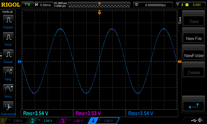

When I got the A6902B channel 2 was about 20% out in gain on channel 2. That is a lot. It was time to follow the Tek service manual instructions and calibrate it.
Now I have this:
where Light Blue is the Pirtek,
Purple and Dark Blue are the 2 channels of the A6902B
Input signal is 10V p/p sine wave 50Hz.
This is 3.53V AC RMS
They all are very close.
Undoubtedly the 3 phase inverter will  have unbalanced loads and unbalanced outputs
and I want to be able to see this to a few % or better.
here they are with mains AC voltage:
there is a bit of a difference now. I could have calibrated them with mains voltage
as input but that is a dangerous thing for me to do.
Calibration changed when I change from 2V/div to 100V/div. Oh well.
They are now all close enough so that's that.

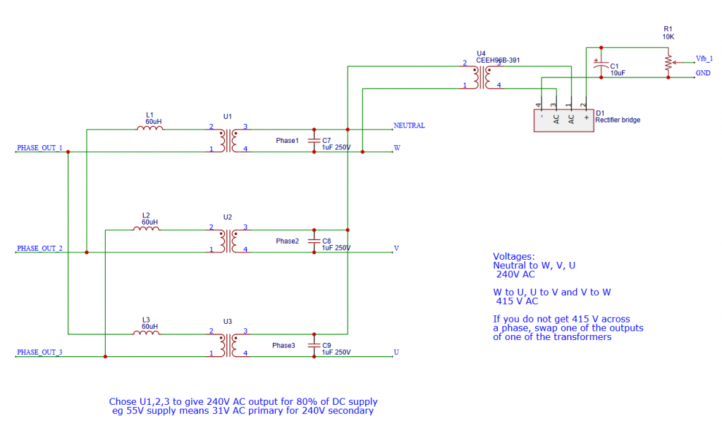

Now, the transformer.
I think I will make one using 3 toroids. I have 4 on hand, and they may not be all identical.
With individual voltage feedback control for all 3, I think it will not matter
much that the toroids are different. The feedback control will automatically
handle any differences in output voltages for each phase.
The prototype will only need to produce about 1kW per phase and probably less.
This is 4 Amps at 240V per phase.
So I intend to wire the primary in delta and the secondary in wye plus a neutral.

Revlac
Joined: 31/12/2016
Posts: 1310
Posted: 01:49pm 28 Dec 2020
That little motor looks perfect for a test rig.
I got hold of some Copper Prototype PCB Board should be big enough for this, used a few already for some other nano projects
I remember checking the grid voltage when we had it here, there was 25vac difference between phases, I can see this way will be much better or perfect.
Enjoy your trip in the bush, Every morning I open the door I get used as a bird perch, claws are sharp as.
Cheers Aaron

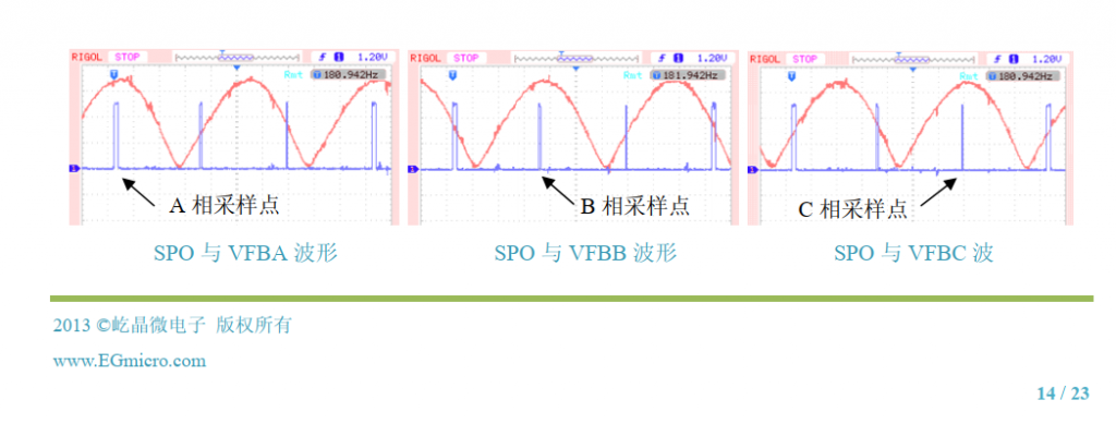

I have spent some time looking at the EG8030 documentation.
It comes in two flavours, Chinese and Russian. Google translate is helpful.
The EG8030 can run in a few different modes.
The first 4 are (all have soft start same as EG8010):
3 phase with closed loop voltage control for each of the 3 phases, so that
all 3 phases can be driven as needed to provide desired output voltage.
3 phase with closed loop voltage control taken from one phase or an external input
with all 3 phases driven in unison to provide an output.
The above but open loop. This is where the outputs are defined by the input
in a 1 to 1 mapping. When loads are applied, voltages will drop.
Other modes exist too.
And interestingly, there is a digital input used to reset the SPWM to Zero degrees
when triggered and this is used to synchronise multiple systems.
I will probably go with the first mode.
I want all 3 phases driven in a closed loop control, with each phase having it's own
feedback voltage. The output frequency will be 50 Hz for start up and a few seconds
afterwards, then reduce freq based in DC input power levels via a lookup table or something.
There will be soft start from zero power to full voltage taking about 3 seconds.
And a soft stop.
I have ordered 6 x IR2148 gate drive ICs. Only need 3 so have a spare set for when
things blow up. I need to collect a few bits - 3 x 12V transformers, chip sockets etc. And 3 good ferrite chokes, probably use the cheaper RS component ones.
Here is the suggested circuit for the EG8030
You can see the 3 1/2 bridge drives and the delta/wye transformer.
With 48V DC supply it suggests 20V AC primary winding which is a bit low to my mind.
There are no primary chokes. There are 0.47uF caps across the outputs which does not
seem right. I think we need correctly working LC filters with this but I can not see
the inductance of the transformerand the 0.47uF caps helping much.
nickskethisniks
Joined: 17/10/2017
Location: Belgium
Posts: 499
Posted: 06:39am 01 Jan 2021
Probably because they use delta to star. I think you can use star to star to use a higher primary voltage. Then you can use a 20 * 1.7 ~ 34V primary, I should think this over how things would work if there were a uneven load attached.
