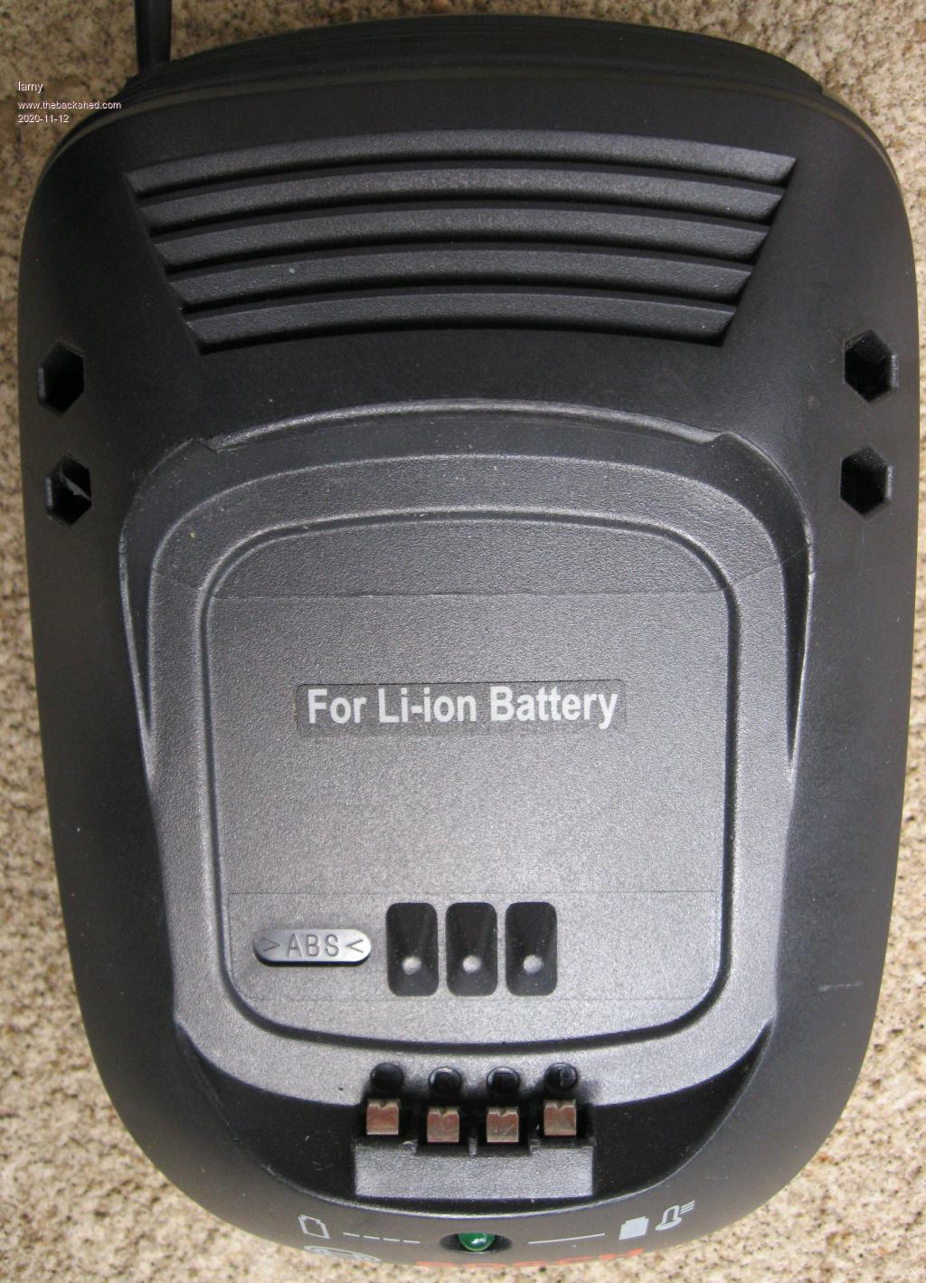

I have several Bosch battery tools that all use the same batteries & charger.  I have 2 chargers, but one failed about 2 years ago & the other one failed yesterday.  I therefore want to repair them.  But a circuit diagram (schematic) would be helpful. I did an internet search but found nothing useful.
It is a 14.4 ~ 21.6 Volt, 1.5 A charger (see the photo).  Underneath it has N153 Q061298. I searched using these numbers & found nothing.
Does anyone have a circuit for this charger?  Any assistance will be appreciated.

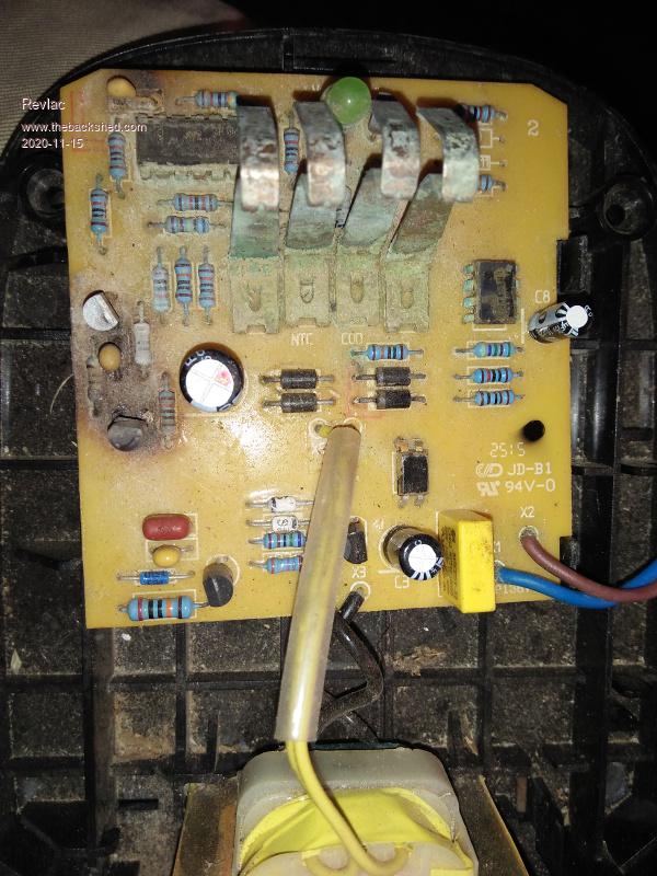

Can you remove the cover and take some photos?
My neighbour brought one around for repair, I could smell its burned inside, been wet and beyond repair.
It has the same voltage as yours but only .43 Amp output, so it may be different inside  to yours, different number as well.

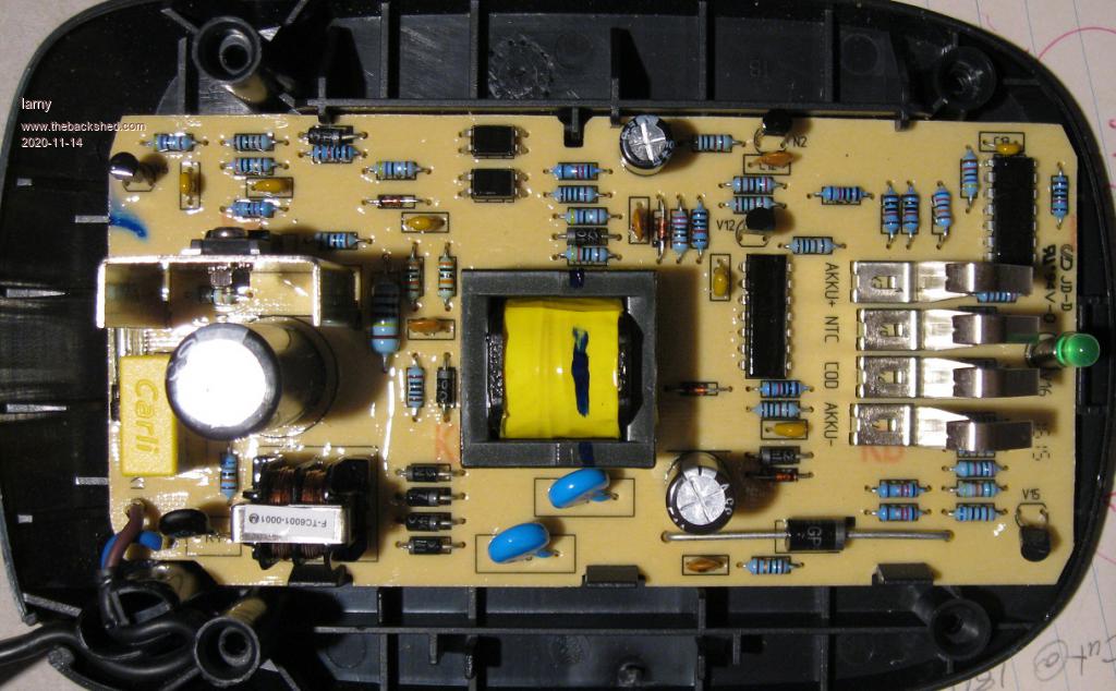

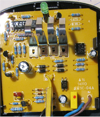

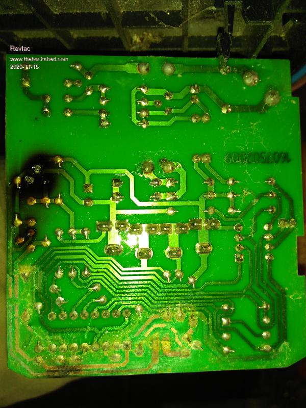

Here are photos of both.the PCBs.

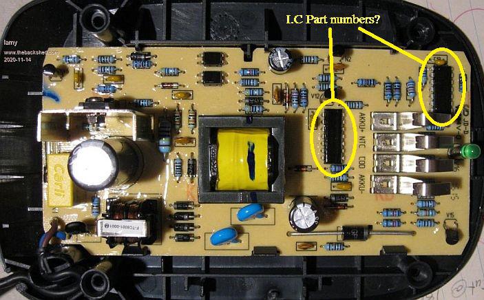

Can you tell us what these I.C numbers are?

I have no idea about the one in the second photo, just a more powerful version by the looks of.
The first one looks the same as the one here, just not as bad.
Obviously I can't help much with the component values as you can see, I looked for a schematic for this almost a year ago and found nothing either.
Time to start fault finding, check for visible damaged components, dry joints then check the transformer output see if there is power then the diode bridge and so on, follow it though and you might be lucky to find something.

Yes, the second one is higher power than the other.  I did some fault finding on the first one.  The output from the rectifier bridge 38.7 Volt.  I had a brief look for dry joints & then decided to start this thread before doing more.

The one near the transformer is a LM224 a Quad Op Amp.  But the one near the LED has 2 numbers on it 5022257 & 785 1062.  I did an internet search on both & had no result. So it must be a proprietary IC.  The other charger also has a proprietary IC in it.  That makes it difficult to see how the chargers work as I presume that much of the action is in these ICs.  Thanks for the response.

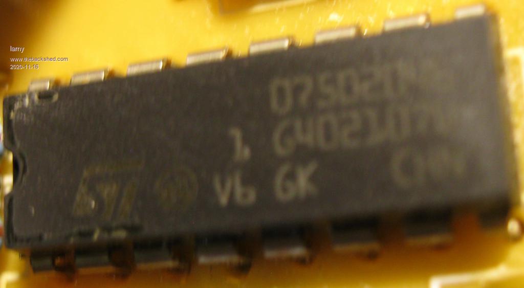

Both are on the secondary side of the supply. Can't find anything either on the second chip, guessing it's a PIC of some sort. Any chance of a close picture of it to maybe get a manufacture logo?

I've attached a better photo.  The manufacture's logo is ST.
Someone on the eda board forum said: ST means ST microelectronics, SGS, SGS Thompson.

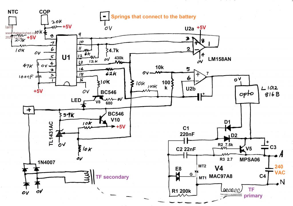

After much effort, I have drawn the circuit diagram.
I presume U1 is a microprocessor but I cannot find a data sheet for it.  So it must be proprietary.
I found the high voltage section difficult to understand.  My best guess is that on positive half cycles (where A is more positive than N) the current into C1 is set by the Opto transistor which is proportional to the current through the LED in the opto.  The DIAC (E8) conducts when the C1 voltage reaches its trigger point thus triggering the TRIAC.  A current therefore flows though R3, V4 & the primary of the transformer.  On negative half cycles, C1 charges via D2 & C3.  Again, the DIAC triggers when its trigger voltage is reached & this triggers V4.  The current through R3 causes V5 to turn on which discharges C3.  I don't know what the purpose of C2 is.  The voltage applied to the battery is therefore adjusted by the above mentioned feedback mechanism.   Any assistance will be appreciated.
