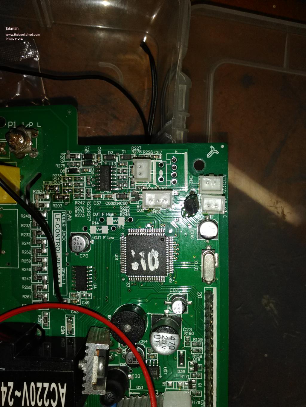

hello Everyone,
I have an old PowerJack Inverter and Support from the Chinese has much to be desired.
I purchased the LW-CONTROL-REV 3.6 A circuit board from PowerJack, with their guidance, to replace an old controller  LW-CONTROL-REV 1.2 which has failed.
The new REV 3.6A board has many extra sockets which I list below:
NTC1(2)
45/60 C
J2
J3
J1
CN4
Is it okay for these to NOT be connected or have I been supplied the wrong circuit board?

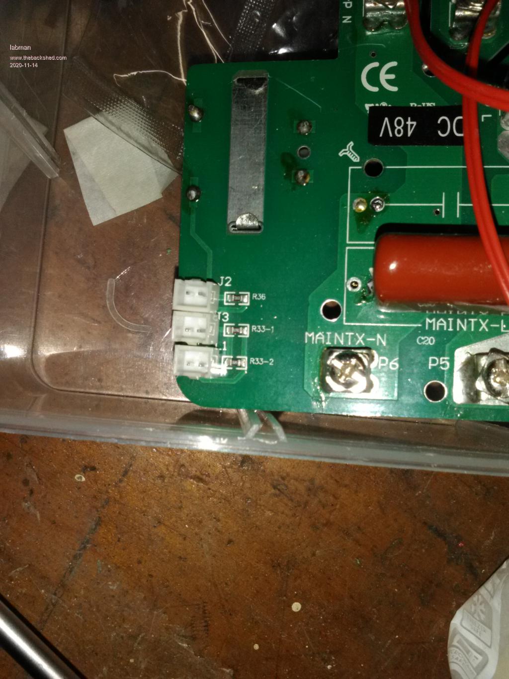

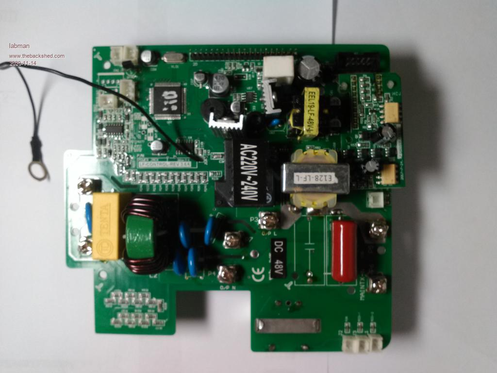

  noneyabussiness said  A picture is worth a thousand words...
Hopefully I have successfully attached some oictires.

You might have to show pics of the mainboard and if it has them the little removable mosfet boards

The MOSFETS test okay with a meter.
The main board is OLD Type without removable boards.
The Inverter is stone cold, no matter if used as an inverter or charger.
Measured a few voltages but without circuit diagrams it is difficult.
Transformers meter okay. Switches and Fuses okay.
So I ordered a new Control Board after emailing PowerJack in China.
The replacement board is very different, despite assurances that it would be compatible. Many more sockets.
I sent them photos, but no response.
Hence I am asking this forum after seeing some Powerjack discussions.

The small 2 pin socket near drive boards is for current sensor for screen on some models, should run without it. The 3 pin near cpu is for fan, some need feedback from fan, some don't.  Ntc (2) and con3 are both ntc sensors, again should run without them hooked, but you will lose temperature control. " 45-60 " no idea. . Have no idea about three 2 pin connectors bunched together.
Above is a educated guess, I had a board with similar features.. as long as you have voltage feedback and 10pin connector it should run( not counting fan feedback as some do, some don't). They are pretty tough boards, unless something wrong, you should be hard pressed to kill anything.
