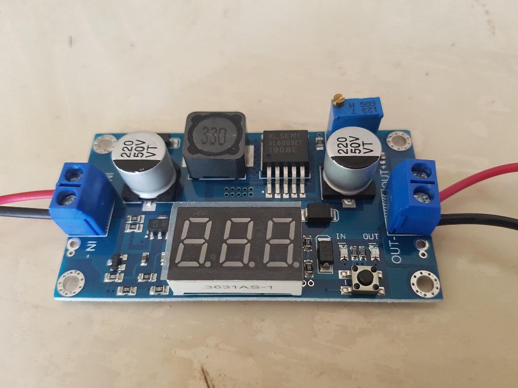

So I saw on Ali some new (to me) boost converters...
5-32V IN, 5-55V out, 2A for $2.50 US plus $0.68US postage .
they use the XL6009 converter chip.
XL6009-DC-DC-Converter-Datasheet.pdf
So I got a couple and the first thing to do is to test them.
These are promoted to be good for laptop supplies, so I tested at 18V
and 25V output both with 12.7V input. You set the output voltage via a multi turn trimpot.

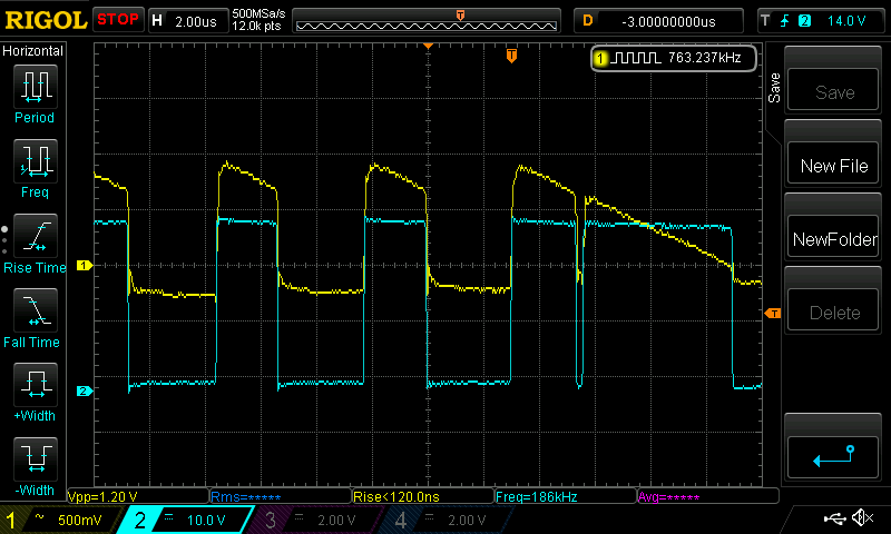

This is crap regulation. I put a probe on the output and here it is
at 1.0A at 25V output.
Yellow is output voltage, AC coupled, 0.5V/div
Light Blue is the switch node showing the boost output pin of the inductor
which clearly shows the switching frequency and gives me something to trigger off.
Not real good. Both samples performed the same.

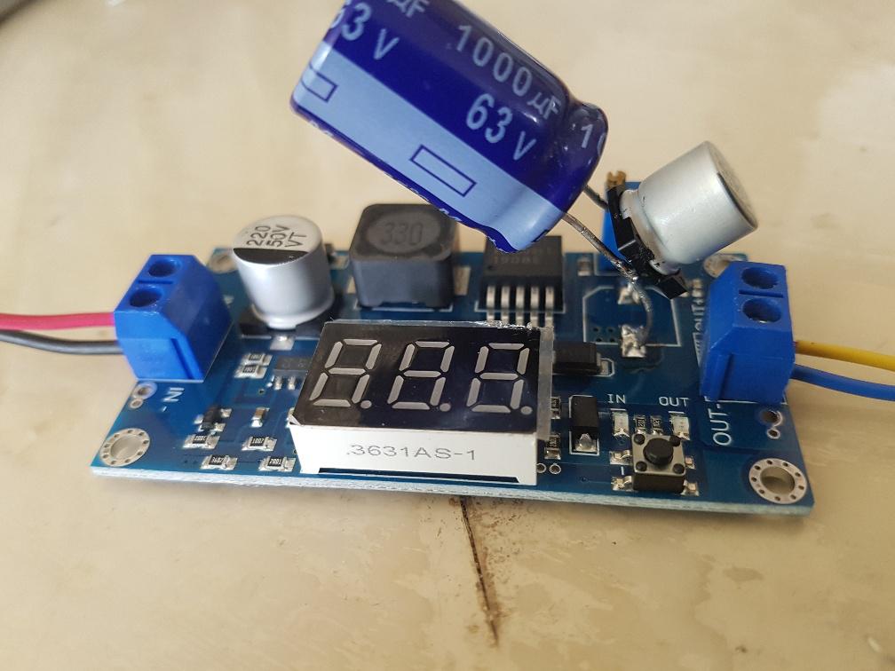

I thought the output cap was not filtering well enough so I put a bigger
one on it.
and regulation improved somewhat.

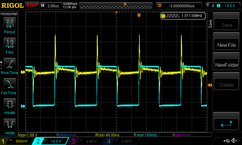

here is the output ripple now.
That is a huge change. No wonder voltage regulation was crap with
the original output filter capacitor.

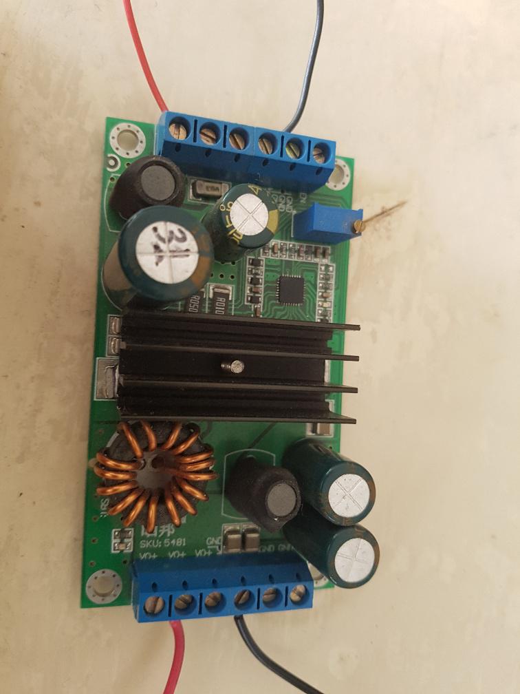

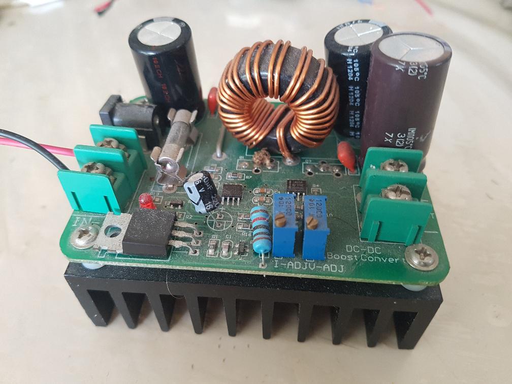

An old and dusty boost converter such as below
does +/- 0.04V regulation at 18V over 0 - 2A and
+/- 0.1V at 25V over 0 - 2A, all with 12.7V input
and a synchronous buck/boost costing a lot more is very good
+/- 0.05V at 18V and +/- 0.02V at 25V.

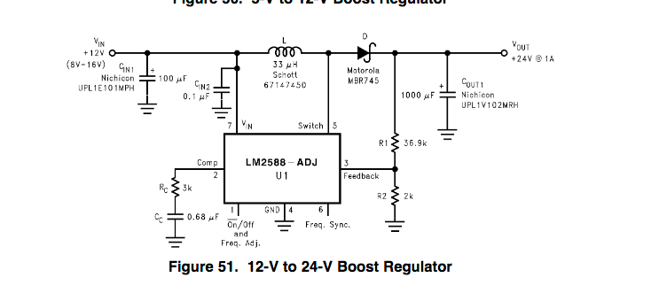

Looking at for instance the LM2588 converter chip, TI's example
circuit has a 1,000uF on the output, 4x larger and undoubtedly
about 10x better in ESR etc since it's a Nichicon

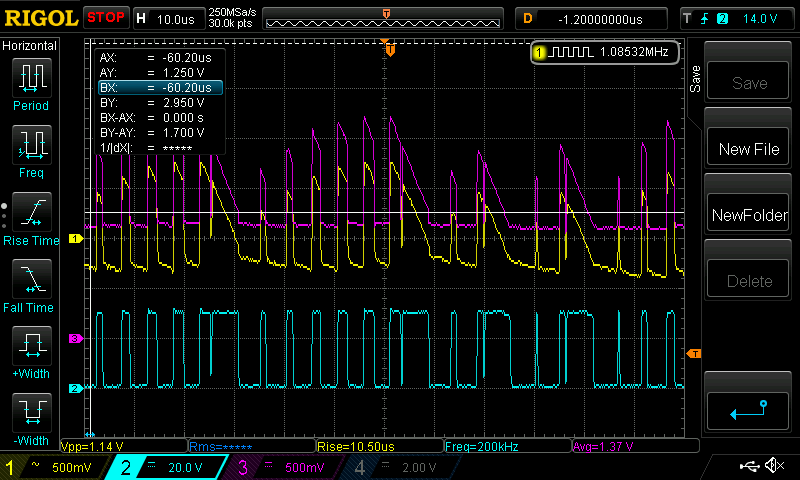

here is a look at the voltage feedback at pin 3 on the XL6009
at 12.7V in, 25V @1A out.
Purple is feedback voltage, needs to be 1.25V.
I put the White cursor on 1.25V
Light Blue is switch node.
This is so bad I can't even explain how it works at all.

The voltage feedback is connected to the output terminals, then fed into a trimpot.
So Vfb = output x some_factor with zero low pass filtering.
All it needs is an output with far less ripple.
It's likely the output cap is about 2c in cost and so has a huge ESR. I checked it's value at 100Hz with the LCR meter and it's 220uF as marked. At 10kHz it dropped to about 3uF
As far as cheap/dysfunctional clones go, the controller is an XL6009, made in China I think. What is quite possible is the XL6009 spec sheet is just thrown together and the circuits and component values may as well be for a NASA lunar probe PS that uses TI and LT parts. From what I see with the switching and control - when fitted with the extra cap - the chip seems to work well. I think if it's given a low ripple feedback, it will perform much better again.
