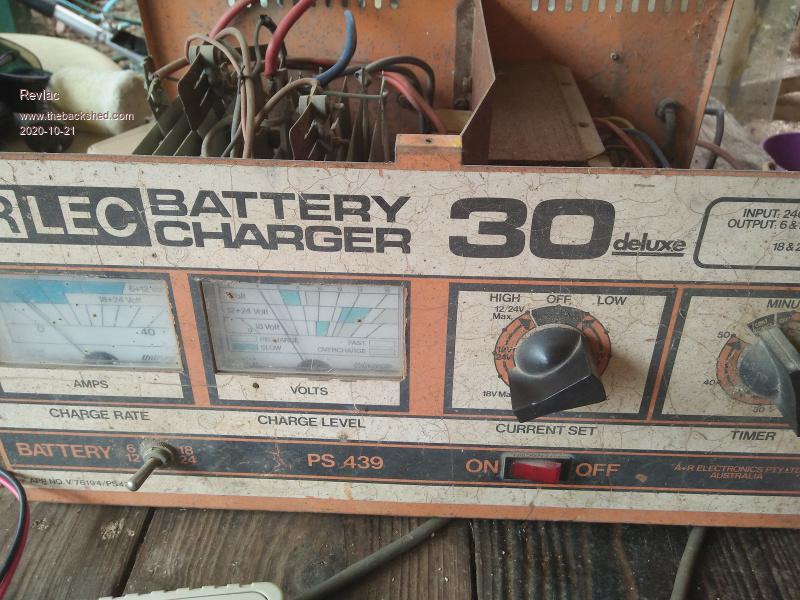

Arlec PS439

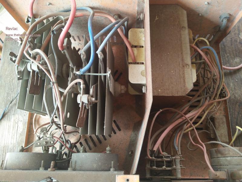

After all these years it finally gave up........Ha, the damn thing is older than me, Its had a lot of use over the years and a few repairs, voltage selector switch and so on.
Went to use it today to top up a set of 80 lithium 18650's, just to bring them up to about 4v or thereabouts, its been good for this sort of thing because of the select able voltage switch, something a smart charger does not have, or some do and I don't know about it yet.
I found it was not putting out any current when charging, and it had some stink coming out of it.
This is the guts of it, The old style  (I believe it is a) selenium rectifier.

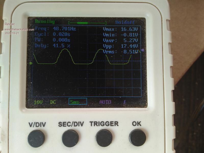

And a check of the output with the little scope revealed some nasty half wave I was putting into the battery.
The transformer appears to be ok, I should check it properly after the rectifier is removed....

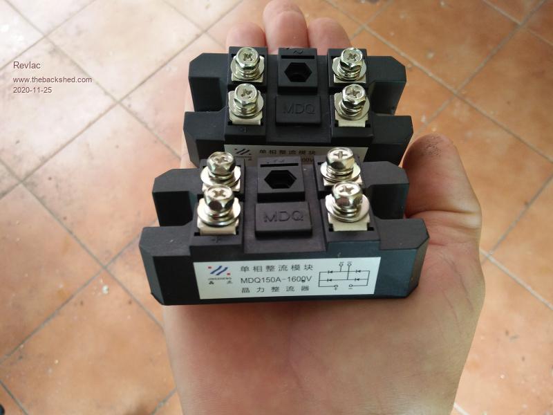

@Tony, those diode packs are nice and neat, would be good on a descent heatsink without any fan, would need a pair of them for the 2 windings

Rectifier blocks arrived today, they are nice beefy looking things, will make up some heat sinks for them, don't think they will need all that much.

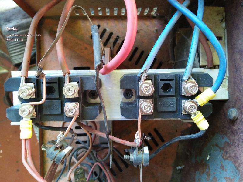

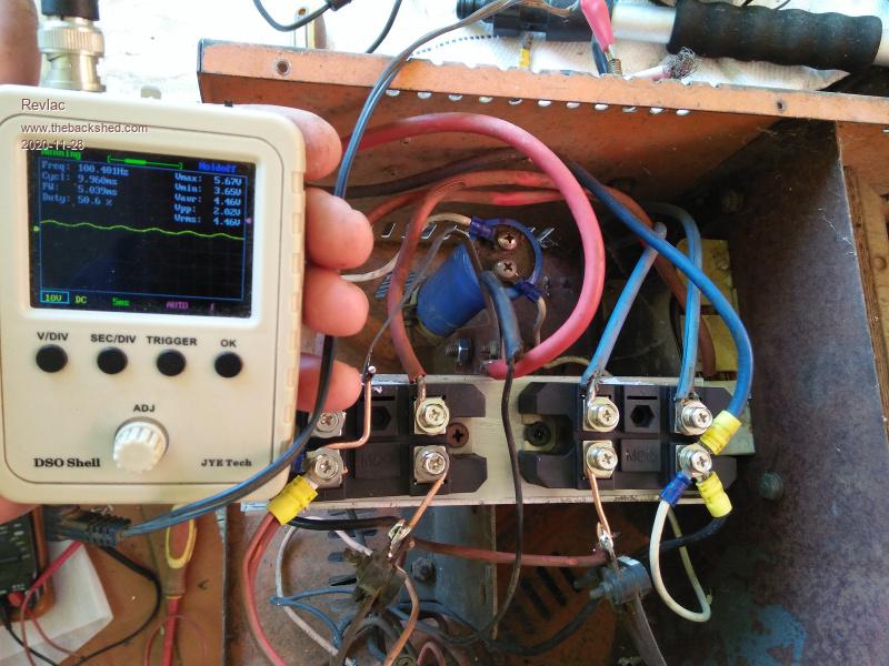

The diode blocks are in and mounted on a small heatsink.

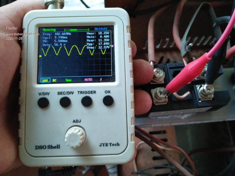

Give it test run and there is the ripple, I think the output voltage is a little higher than before.
I tried it with a capacitor on the output and that flattened it out completely but that was running without a load on it.
With the filter cap on the output and charging the battery there is some ripple but not bad at 15Amp, I could filter it a bit more.
Its also putting out more current than the old diode set, so much better, run it for half the day and confirmed my heatsink is inadequate, it not too hot but could do better also about 3 hours in I burnt through the jumper cable I had connected to the back of the charger, been using them because they had a bit more length to play with than the others that were there.

BTW, what size capacitor is that you are using? From my limited experience, you would need at least 100,000uF for 10A to get a smoother input to the battery (~ 1V p-p ripple) itself.
Also, somehow, your bottom DSO shot doesn't look right? Did you change your connection points or the load from the one immediately above?

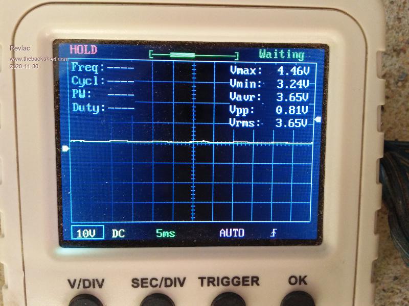

The arlec charger never had any filter in it originally, The cap I put in is 8700uf  when the picture was taken with a load, without a load and cap in place its just a straight line.
The DSO connection points are on the same wires, just on the out side of the case instead of inside.
This photo today, I added a 22000uf and its made a difference, almost flat, (I was charging a 90Ah of 3.7v lithium 18650's at 15A) perhaps it could be improved with a choke fitted also it creates a bit of a spark and burns the clamps when connecting, easy fix was to charge the caps by switching the charger on low power before using it.
