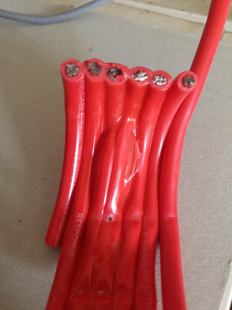

Since it was about 1 year of continuous service from the 6kW Madness powerboard & nanoverter controlled inverter it was time to have a look to see how it's going.
All OK from about 2.8 MW.hr of output over that period.
Except the choke windings.
I used the cable from here
Two chokes, 5 turns around one, 6 around the other.
The 2 chokes were wired in series.

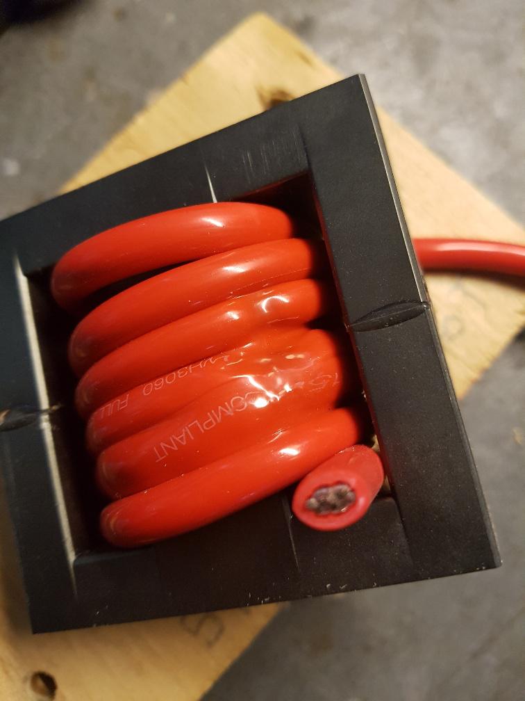

Here is the winding from the 6T choke.
It seems I need to use higher current cable and maybe something that can handle
a bit of heat.
The 5T choke was effected to a small degree, nothing like the above.
I rewound the choke to now have both cores stuck together with doublesided tape
and put enough turns in it for 70uH.
The cable used allowed 3 runs of 3mm diameter (7mm2 area) so it's probably going to be good for another year.

That's only 7.5mm2.
Maybe try 25mm2 like this one
I got it from here which isn't terribly far but more than 5km, I'm sure they deliver/post though.
