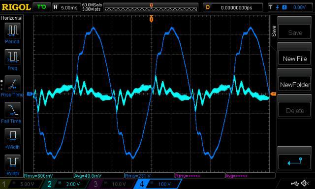

An untuned transformer will still have a natural self resonance "somewhere" that may unfortunately land right on a harmonic of the inverter 50Hz energy.
Harmonic distortion within the inverter generates outputs that may excite this resonance and create stationary wobbles on the inverter output waveform.
Its not a serious problem, but it just looks bad if the output waveform is being monitored on an oscilloscope. Not all inverters do it, on some its hardly noticeable.
Here are some nice voltage wobbles on the dark blue channel (shamelessly stolen from Poida).
Light blue would be the current, and as you can see, its ringing at probably the tenth harmonic, or 500Hz. That needs to be brought down to 75 Hz by adding capacitance across the secondary.
We cannot move this natural resonance higher, but we can easily move it lower.
Unfortunately moving it lower can make the problem worse as it may then lock onto an even lower harmonic which will have an even greater amplitude.

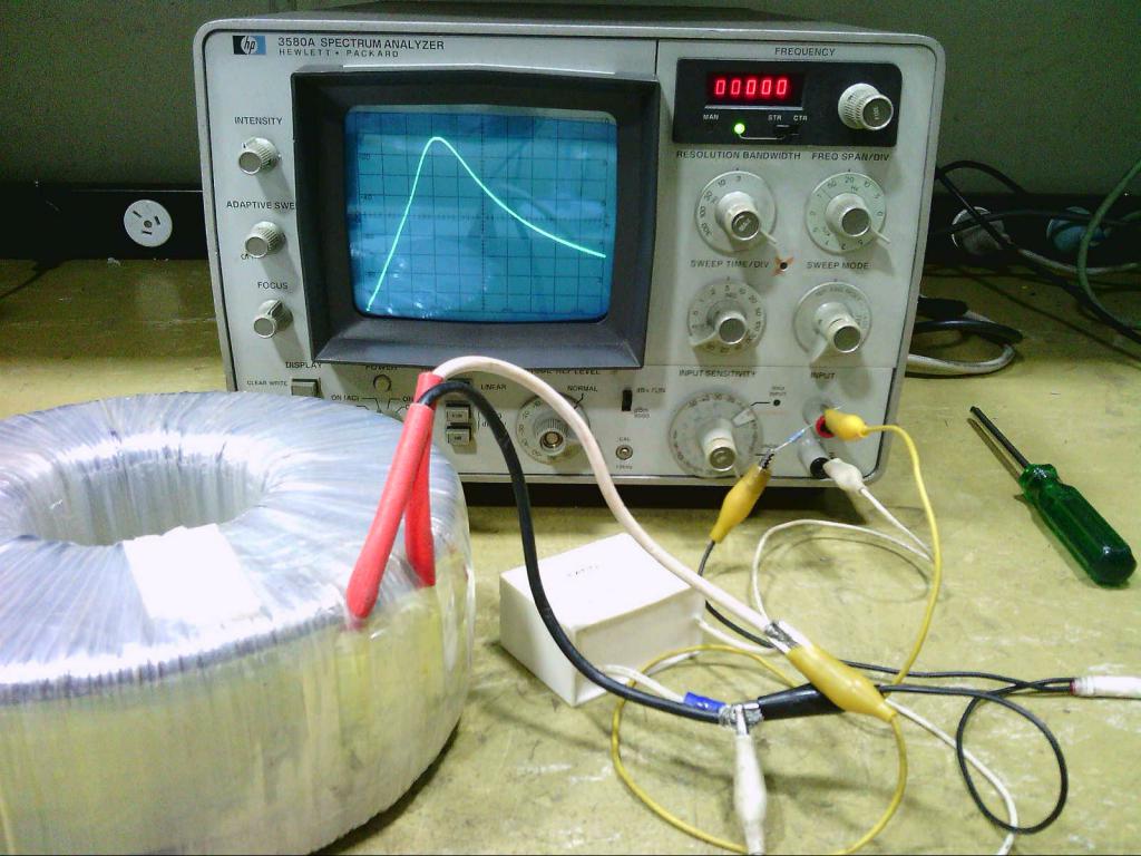

Cheap function generators generally use a potentiometer with a very dubious frequency scale marked around the knob. That will be fine, as long as you hook up a digital frequency counter to know what the true frequency really is.
Wind the sine wave amplitude flat out, and connect it to the transformer through a high value resistor, maybe 10K, but try a few different values.
Connect your CRO straight across the transformer winding.  There will be a definite peak in amplitude at some frequency, usually several hundred Hz or in the very low Khz range.
It will not be a very sharp peak, and its difficult to find the actual exact centre frequency.
Wind up the amplitude on the CRO, and shift the whole trace down off the screen, so only the very peaks are visible. Rock the frequency slightly and eyeball the peak as best you can.  With a bit of practice and some luck, its possible to repeatedly guestimate within about 1Hz where the peak actually is.
The amount of extra capacitance required will vary widely. Sometimes as low as 1.5uF, and sometimes over 10uF.  Just use whatever capacitors you have to arrive at a suitable value for the test initially.  But finally fit a good quality high voltage capacitor once you know the correct value.
I did try this test once, with my ancient old analog spectrum analyser, its set here for 20Hz per division, and the vertical amplitude scale is linear (not in db's).
As you can see there is a definite peak in amplitude at a tad over 60Hz with a 5uF capacitor.  I did not attempt to tune it properly here, just wanted to try the method.
It was not accurate enough to be useful with this spectrum analyser.
Much better and more accurate and repeatable results are possible with a manually tuned sine wave oscillator, and an oscilloscope.
