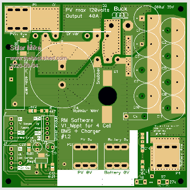

This somewhat modular design has a 4 cell input with cell hopping common voltmeter to measure and apply loads to various cells as required; that is built on one pcb. The other PCB that connects to the BMS unit measures 100 x 100mm and contains the mppt charge controller. Basic design spec for this is up to 100v input and 12v out at 20 - 30 amps max, figured the mppt unit may be useful for other projects, can make it work in non mppt mode by leaving off the electro's and bypassing the inductor if say an 18v pv panel was used.

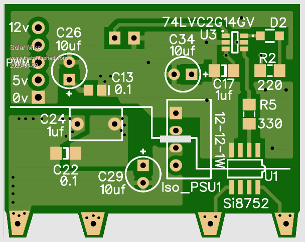

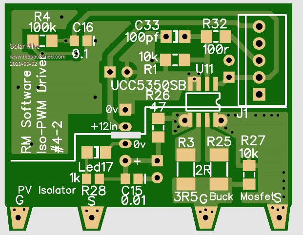

Its pretty difficult to make a small compact mppt charger board having an optimum layout, so have added a small daughter board that contains the driver part, leaving the large current carrying traces optimized on the main board.

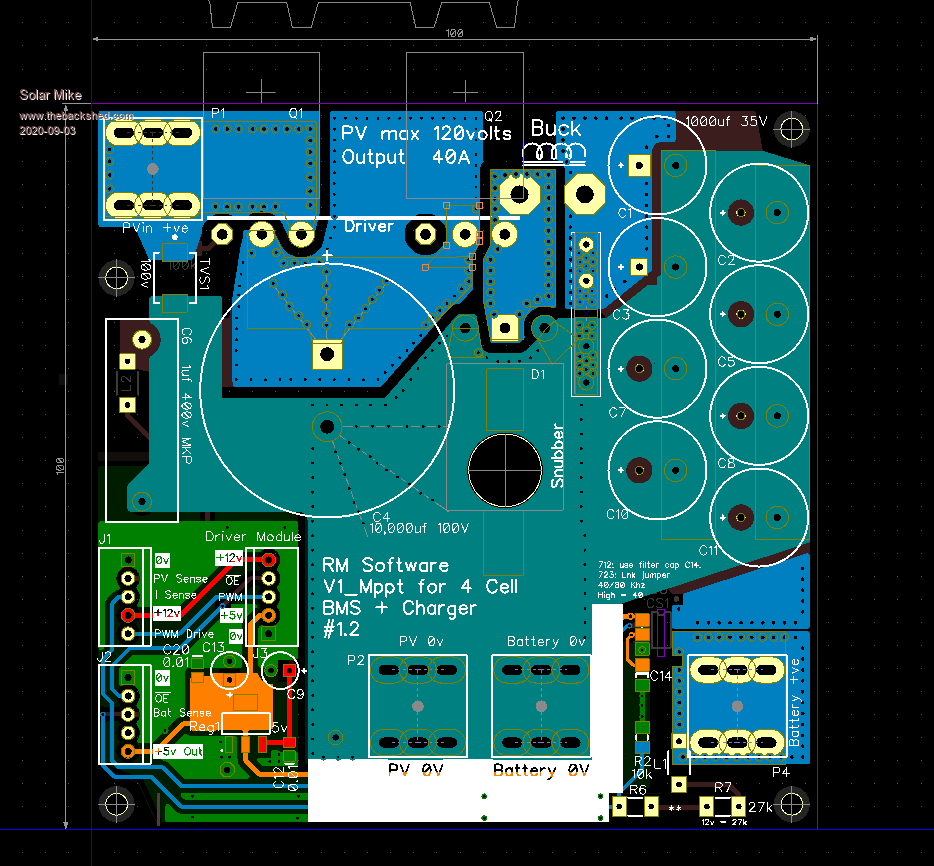

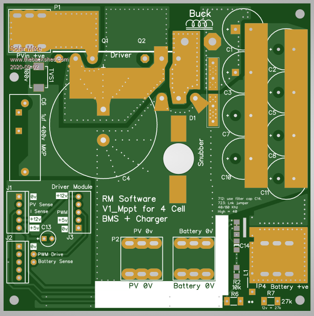

Here's the progress so far for the Mppt bit, no circuit as yet, its been designed direct to pcb layout, will create a schematic to check later. The 2 mosfets and schottky rectifier mount under the pcb on the alloy case.
Driver:

Few changes made to the Mppt power board:
Added a 5 volt regulator rather than pass it in from the BMS controller.
Added an active low, PWM Output drive enable input, the mosfet driver chip has this input, so have passed it through to the input connector, can be used to shut down the drive on over current by using a fast comparator, external to the CPU control.
Increased the high voltage track spacing to 1.4mm, so input\output voltages up to 120 or so can be used, daughter driver board also has increased spacing.
Cad Layout:

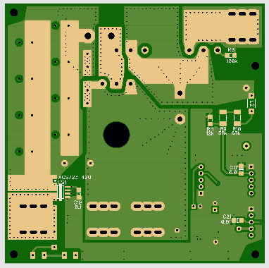

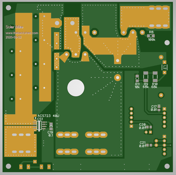

Full size 100x100 PCB:
Using 1oz copper 30 amps will be ok, if tinned area's are solder blobbed, no reason why 40 amps would work fine without over heating; each of the small output caps have a current rating of approx 2 amps, so @40A max output and 20% ripple of 8 amps, in theory only 4 caps are required, see how it goes in testing.

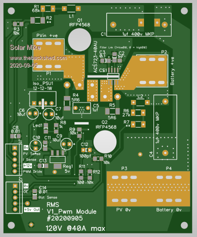

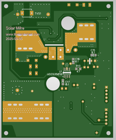

With a copy and paste + few mods a PWM variant is done also; some of the PV panels are a pretty good match to the battery voltage, so mppt isn't worth the extra expense.
The PWM version is a little smaller 100 x 82.

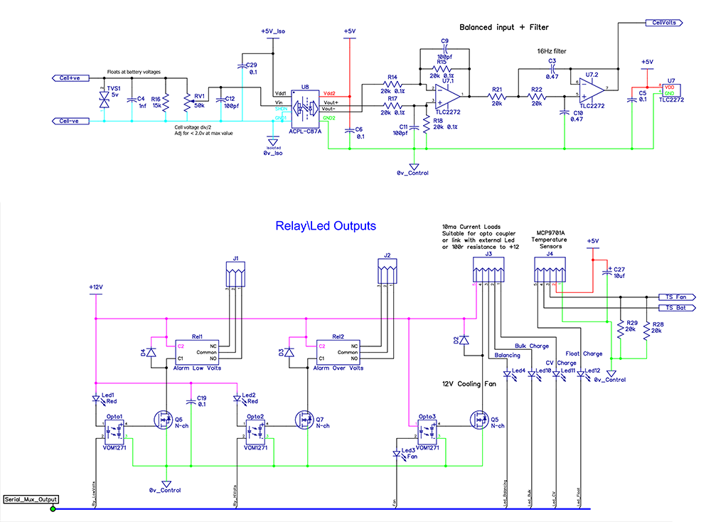

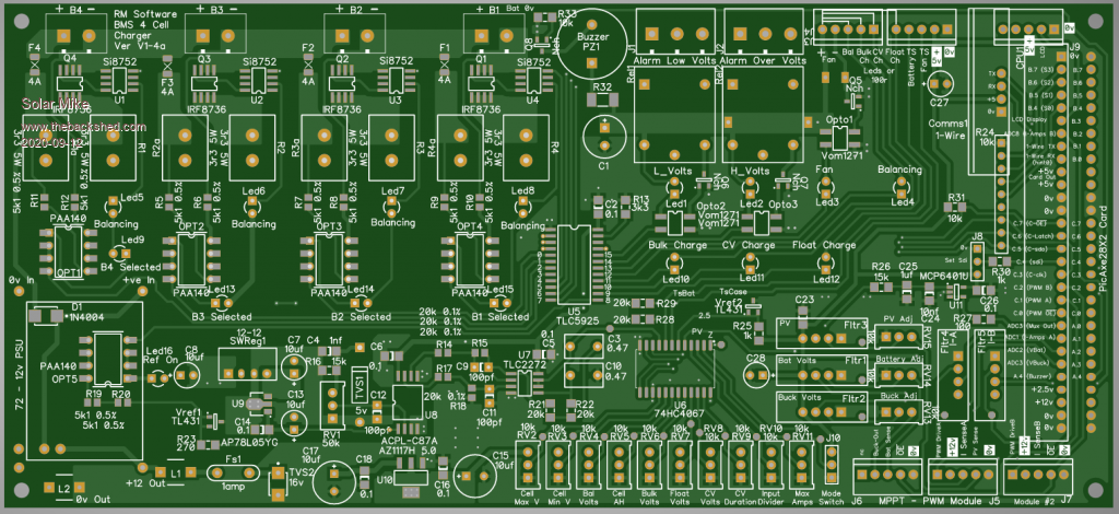

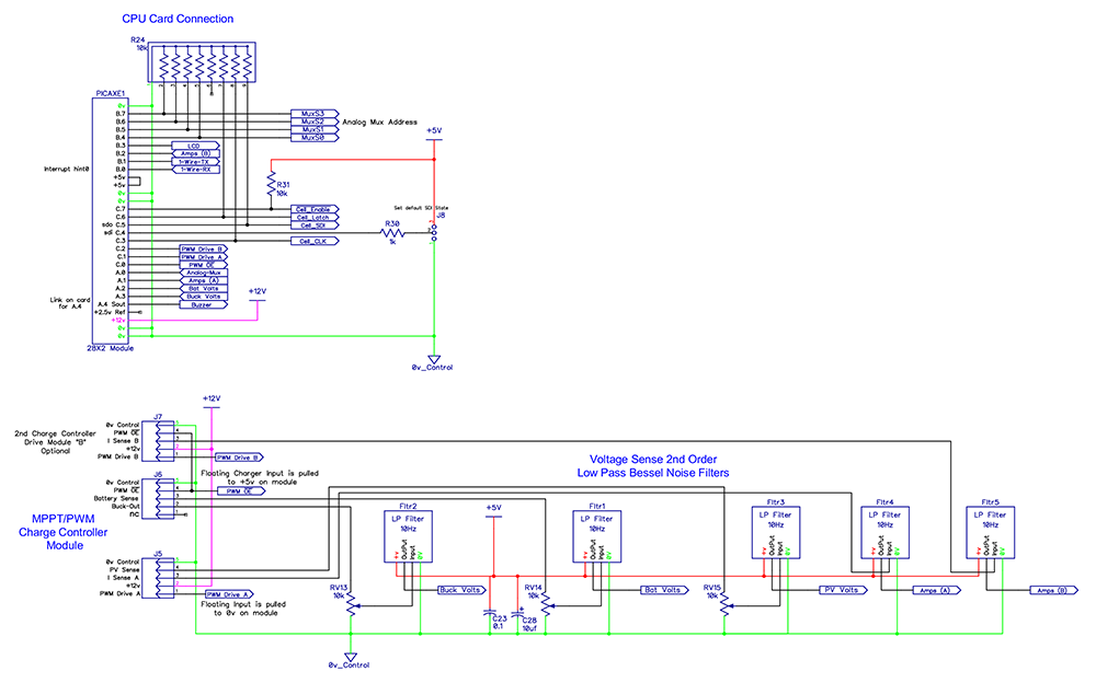

Finally completed 1st cut of the 4 cell BMS + charger, here is the design, for this project I did everything backwards and designed the pcb boards on the fly with the schematic in my head, then drew the schematic from the pcb layout.

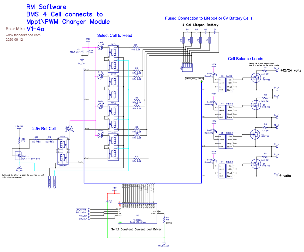

The basic BMS connects to 4 battery cells, voltage anywhere from 1.2 to 12 volts, using a flying voltmeter concept switched across the cells and isolated measurements via an isolation amp that accepts up to 2 volts input.
Optimos switches driven by a serial LED constant current driver select each cell to be measured, self calibration is achieved by switching in a 2.495V reference.
The same LED driver also turns on individual cell loads for balancing; the loads are turned off when voltage measurements made.
Isolation amp feeds a balanced to unbalanced buffer amp followed by a 2nd order 12 db\octave low pass filter to reduce noise.
Serial LED driver outputs not used for cell measurement or loads are used here to drive a couple of relays and LED status indicators.

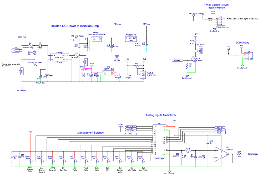

Here an analog multiplexer is used to select various voltage references that control the program set-points, bunch of 10 turn pots used here rather than a software menu system to set everything up, whether this is a good idea or not remains to be seen.
The faster dynamic voltage and current measurements are filtered as necessary and fed straight to the CPU; Picaxe 28X2 used here to make use of 64 MHz speed and interrupts. I have made provision to drive 2 mppt or pwm PV charger modules on separate phases.
CPU is mounted on a small 30pin vertical plugin pcb card, I will replace this at some stage with one of the "Mites"; again how well it goes concurrently controlling the BMS and a mppt charger remains to be seen.

Posted: 03:05am 12 Sep 2020

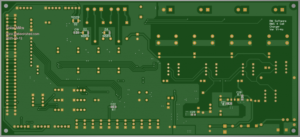

BMS + Charge Controller PCB, size 100 x 220:
