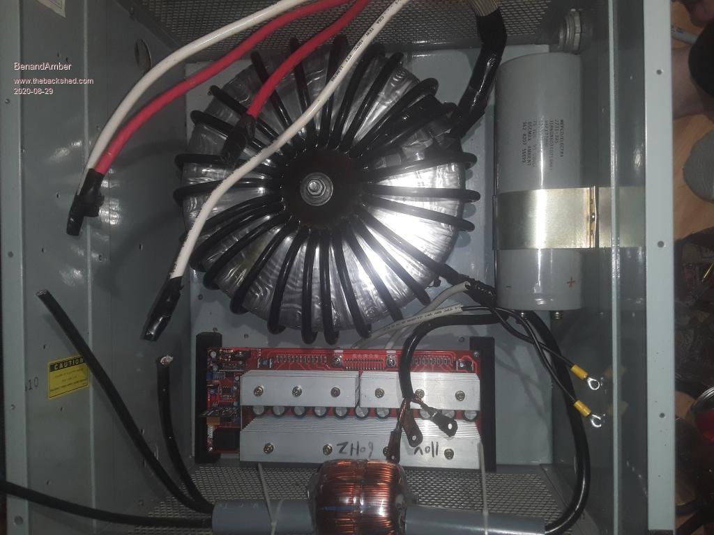

I have 130  ICR18650-28A SAMSUNG SDI batterys
I would like to build a small 48 volt battery
The battery would be for mobile use with the little China 4 mosfet inverter
The very first one we made with the help of the good people on this form
I gave it to my dad and we upgraded him with a larger inverter

I still haven't finished the farm inverter I have to buy a large drill bit and a few feet of flexible wire to finish it
That chokes heat srink is a 20 ounce soda bottle that is why I am now saving them!!

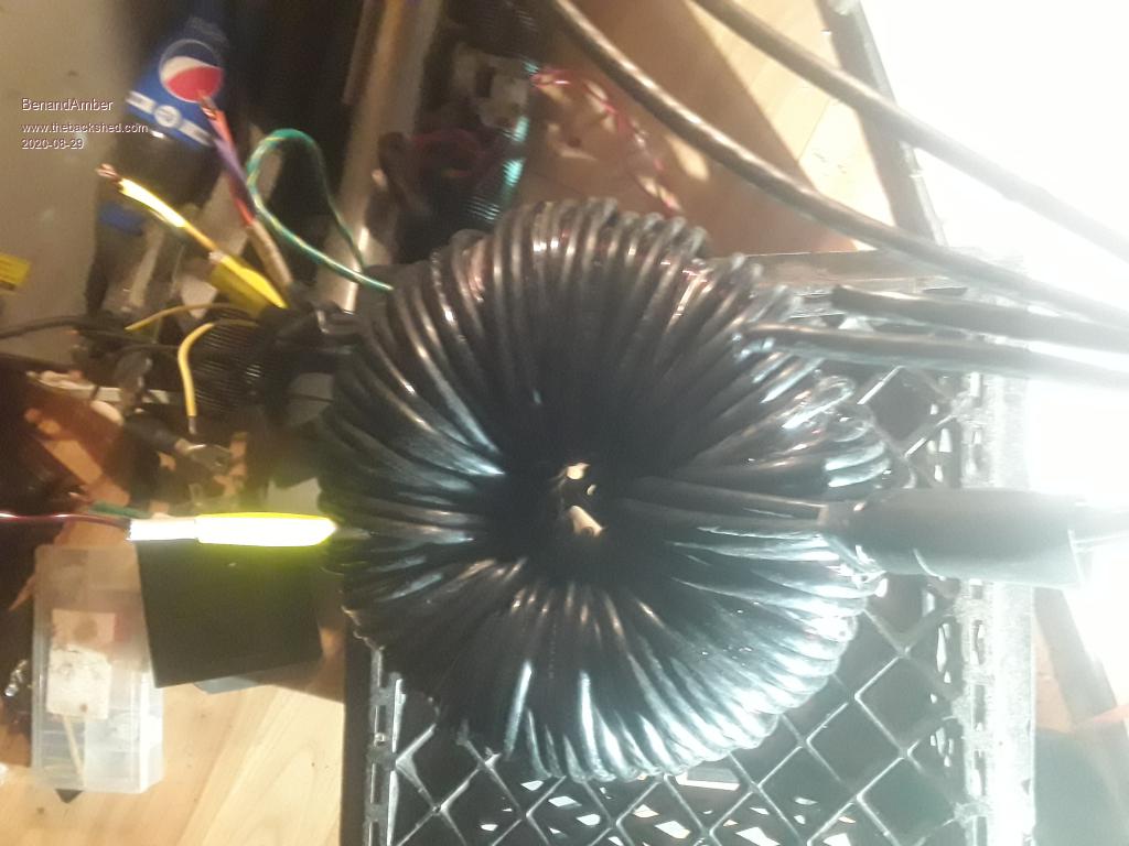

I have also wound another Transformer after the farm inverter Transformer
It is a very ugly experimental Transformer
It is 120/240 volt secondary 32/64 volt primary
The core is close the size as a power Jack as4
I have used alot bigger wire than the as4
I was told by Sid that most of the heat in the power Jack tranformer was in the wire
So big wire on smaller core I will be testing the pefomance of it very soon
I have a gut filling a few of the people on this form can tell the results before testing
It would be nice to know what to expect

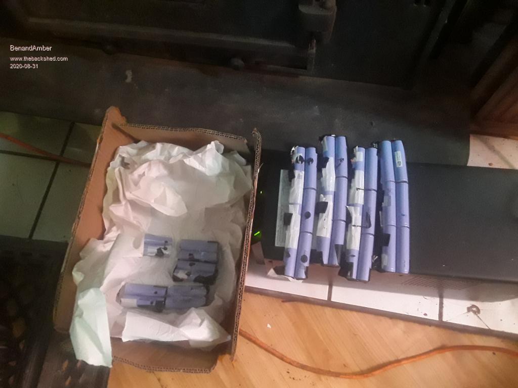

All the batteries are the same color and same writing on them

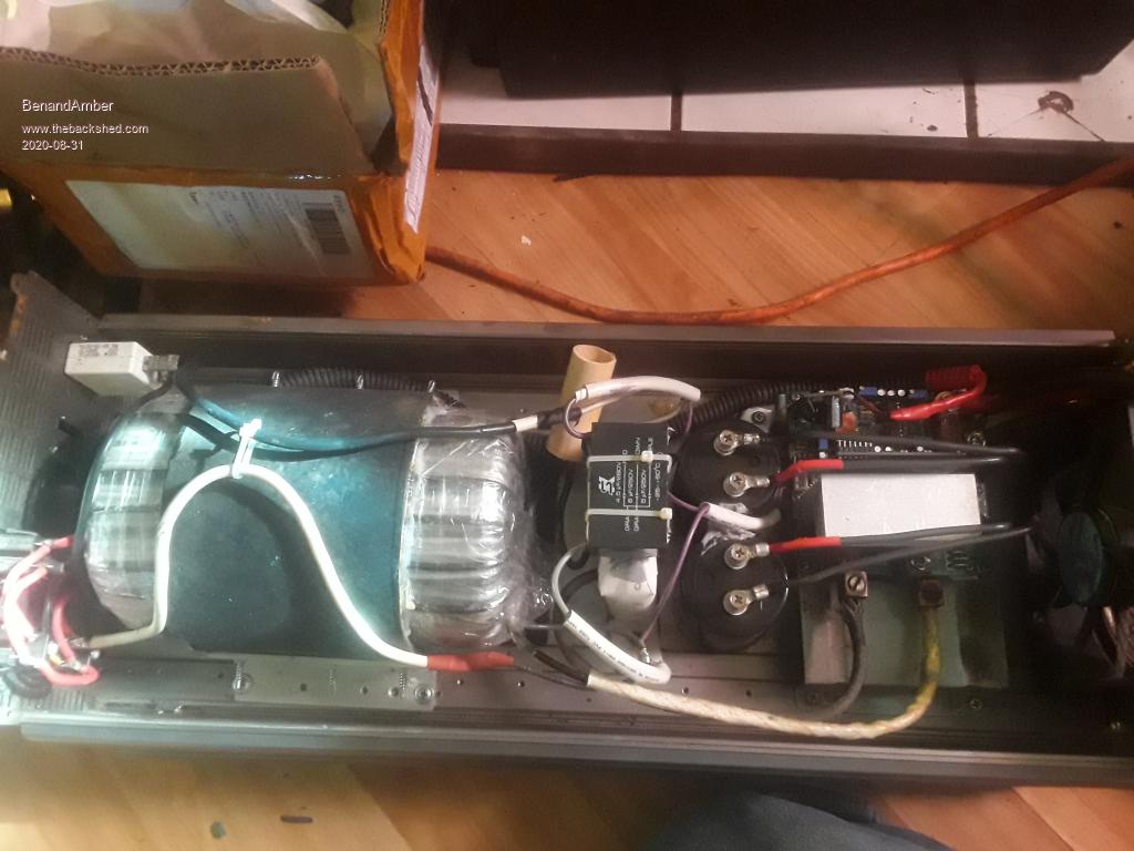

The dell laptops rate the life of the battery in them
All these batteries tested good or excellent before taking them out
Thay are still paired up three in a row
Me being scared of these batteries is a under statement
I store them in that box with paper in between and taped in that wood stove

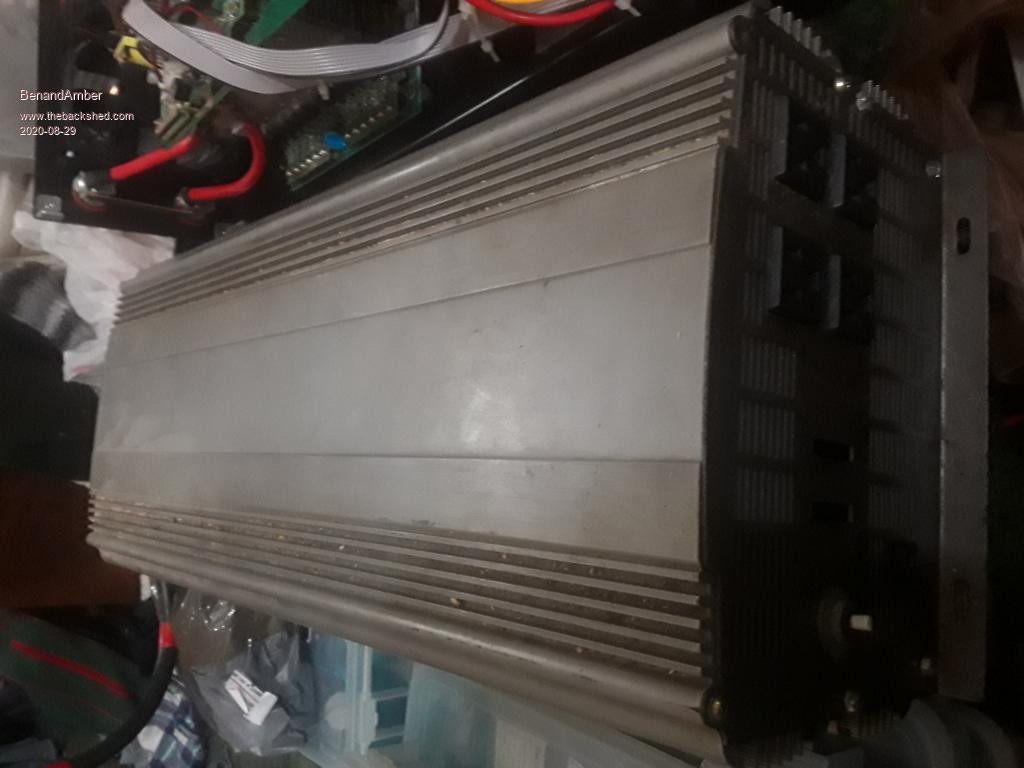

Had to clean the dust and wood chips out off the first inverter
Its idle current is 0.29 on the 48 volt battery side
I am really happy with it

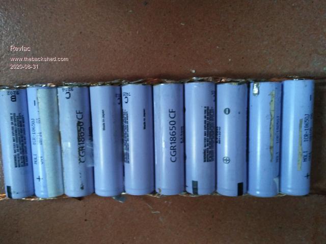

Ben, Those laptop battery cells are the same as I have, some laptops would likely have used the batteries more than others, capacity wont be identical but perhaps close enough.
Will add a picture later.

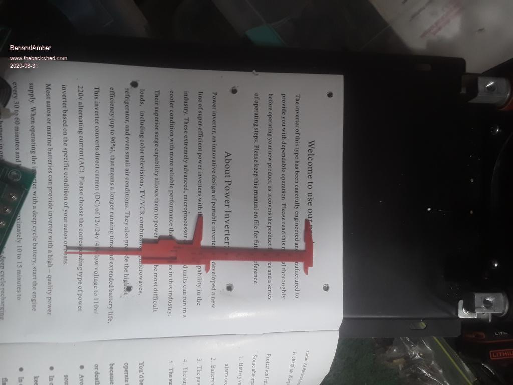

Posted: 07:39am 31 Aug 2020
I bet I am the first person to find a use for a power Jack manual
My experimental Transformer primary wires
I put the current toroid there so when I solder leads on the secondary I won't forget to slide it on
I am going to have to put hood scoops on both sides the tranny is a little to be

This is a set of 10, there would be 13 sets like this, I did them this way so I could stack them up depending on how many are available.
They should have wire strip spot welded joining them together, I soldered copper wire on to all of them and that apparently is a bad thing to do, I'm a dumb arse and Didn't know at the time, after doing this on over 2000 cells its never being any problem.

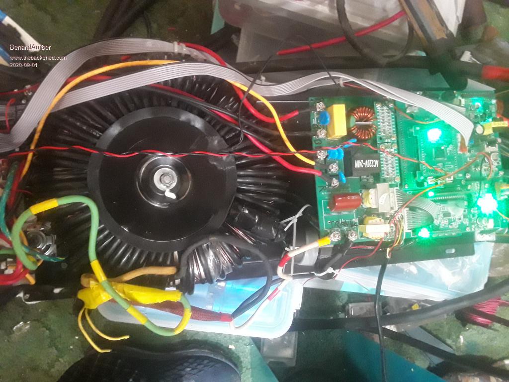

BenandAmber
Joined: 16/02/2019
Posts: 961
Posted: 06:21pm 31 Aug 2020

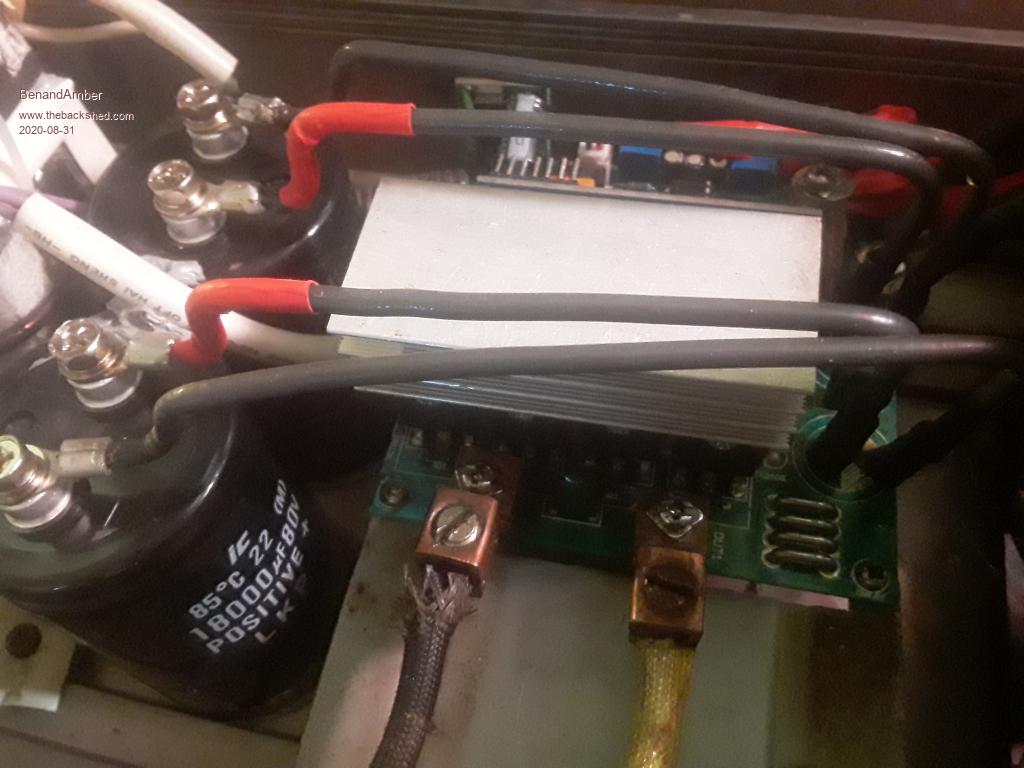

This is that power supply I made no box yet
It can be wired for 120 or 240 volts it can put out 40 or 50 amps on 240
I have a little adjustable turn off board
for it also to use it as battery charger
It breaks one side of circuit on the high side
Here it is powering the experimental tranny in the power Jack
I have to build a good choke idle current is over two and a half amps
Edited 2020-09-01 13:25 by BenandAmber
