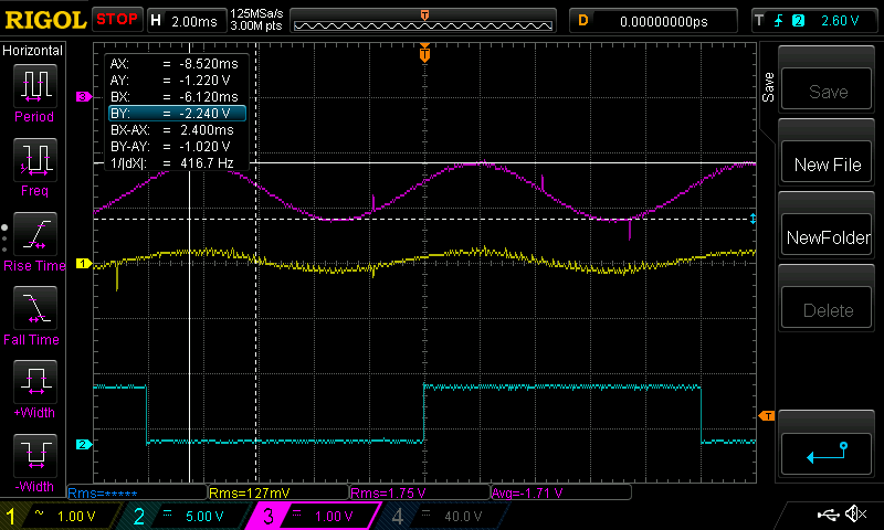

Just so we can have some picture of what's happening, here is the test inverter.
6 x 3,900uF on input. Probably not enough.
4 MOSFETs, one per leg.
50.9V DC input
240V AV output @ 50Hz
400 W AC RMS resistive load
current sensor is 0.207V / Amp and placed at the DC supply positive lead's terminal
Below
is the input voltage, AC coupled to permit 1V/div, Yellow
and the input current, 4.8A/div, Purple
and the 50Hz trigger source in Light Blue
We can see the DC current remains negative throughout the 50Hz cycle.
The input voltage has also an AC component. This input is AC coupled so there is probably a DC offset which we will not see, lower than nominal supply voltage, when running this load.
The cursor shows the current ripple, 1.92V p/p.
This is 9.2A peak to peak ripple current in the DC supply.
The DSO calculates RMS current as 1.79V or 8.6A RMS. This includes the DC offset we can see. It also looks at the Average value, which is not RMS. This average is lower.

9.2A p/p current ripple with a 400W load and 6 x 3,900uF DC capacitance.

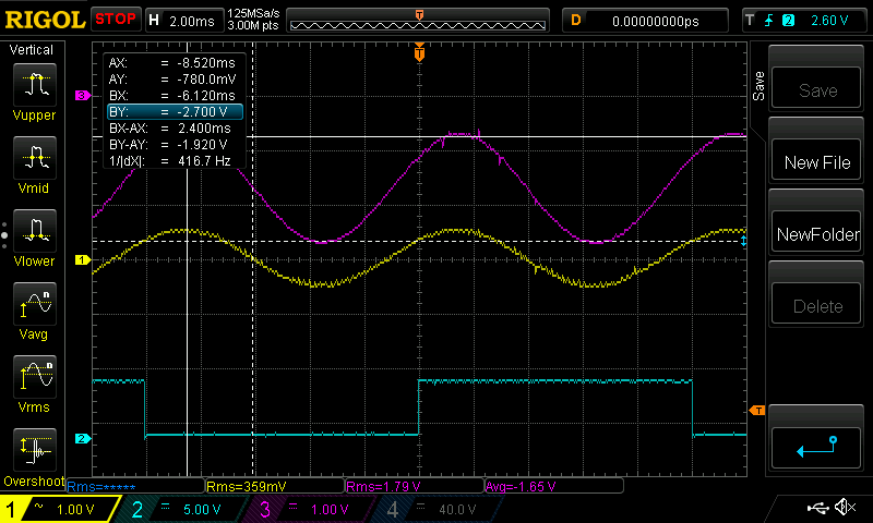

I took the 6kW Mad power board out of the spare inverter.
It has 5 x 10,000uF caps. It has 12 MOSFETs, not just the 4 fitted to the above test inverter.
Let's see the difference if any, from a 2x capacitance increase.
50.2V DC input
Same as above for everything else.
The DSO says 1.75V RMS input current, which is 8.45A RMS
Fluke shows 8.44A DC and 1.7A AC
Ripple current is a lot less now. 4.9A peak to peak ripple current.
Double the capacitance seems to halve the ripple.
This is at 400W.
I think there will be large ripple current present no matter how much capacitance you use, when driving multi kW loads. The ripple current is proportional to output power as well?

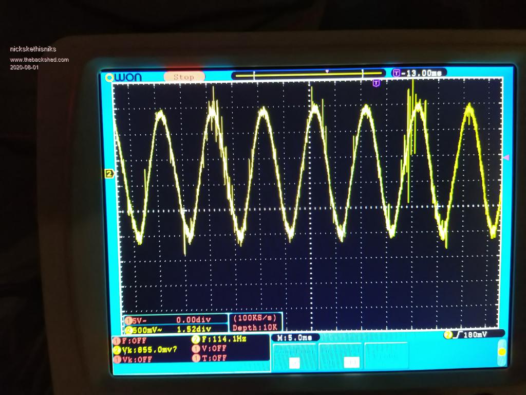

I did some scoop testing today, and I don't need to be concerned about my battery, it's to big to measure the impedance. I couldn't find a ripple higher then 20mV.I need to test individual batteries to do it properly.
What I need to be concerned about is the voltage ripple in my system. When loading with around 4500W (51V) I got 2.6V 100hz ripple on my solar controller output...
And that's not even at the input of my inverter...
I need to take some actions to improve the stability of the system, because I'm impressed about the fact it's still running after more then 4500kWh.
Biggest problem for sure, I do have long 25mm^2 cables running to my battery. So to long and underdimensioned.
I will post some scoop images after I examined them closer.

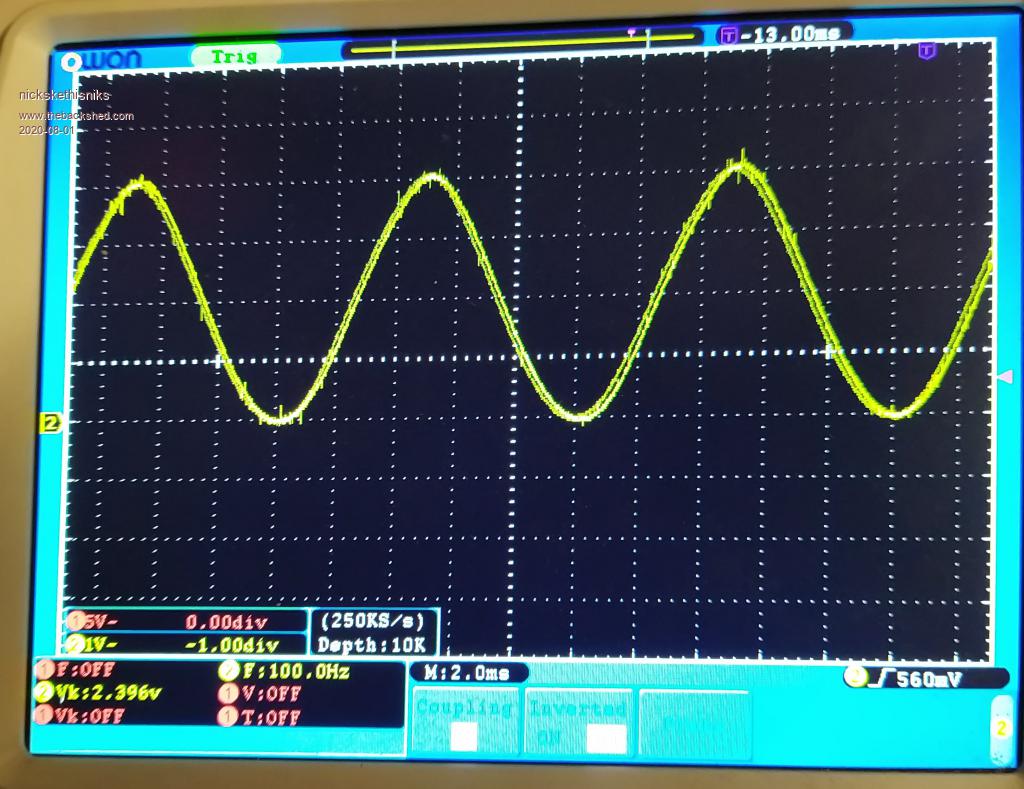

I was allways thinking there should be some kind of DC offset but there isn't... It's a DC sinewave, and I can't talk about ripple current can I?
Underneath the signal of my has200-s current sensor, 1V = 50A. The load was around 4500W on AC side with 2 resistive heaters and some led TL lighting and fans.
So about 120A peak on DC side, the reading is a little bit of, in reality a bit more I think. ( The charge controller off)
This is the output voltage (AC ripple)of my solar controller (buck topology) it was outputting 45A. And there was 4500W of load in the system. About 2.6V voltage ripple.

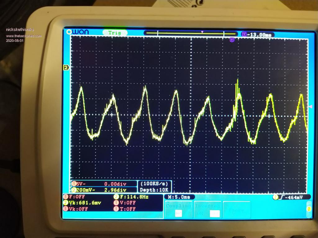

This is the output current, and that's the most interesting image I guess. I think charge controller was putting out less then 45A At that time. We have a DC offset and hugh ripple current.
This image shows me I need to make some changes to my system. Cause I think my charge controller is probably struggling and having a hard time.

Nicks, I think what you are seeing, when looking at the charge controller's battery connection is the CC output voltage is closely following the battery voltage, which is being pulled up and down by the inverter.
the CC control system (basically constant voltage closed loop) does not need to follow the 100Hz, it will give excellent results if it can follow battery changes of the order of 2-10 seconds or slower.
The CC current waveform is sort of what I would expect it to be too.
The 100Hz load of the inverter, placed on the battery alters the battery resistance a bit, depending on the current draw and the battery voltage.
As a battery gets more charged, it's resistance increases ( I discuss lead acid battery only).
So the peak current draw from the inverter will bring Bv down, and while it is down, internal resistance reduces, becoming a lesser resistance load to the dc-dc converter of the charge controller.
And the CC has not altered pwm width yet so it's output current increases as it's load resistance (battery resisitance) drops.
Then the inverter requires less power (1/2 a 100Hz cycle later) and the opposite happens. less Bat IR, less load on dc-dc converter output, so Bv goes up for 2 reasons.
