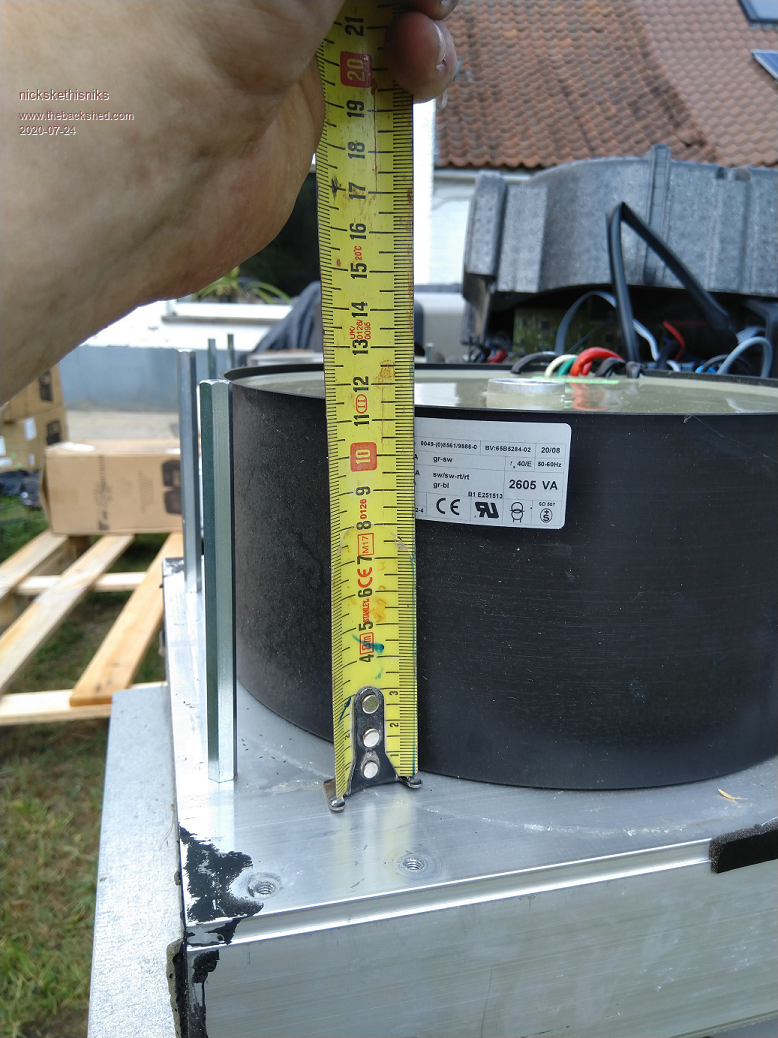

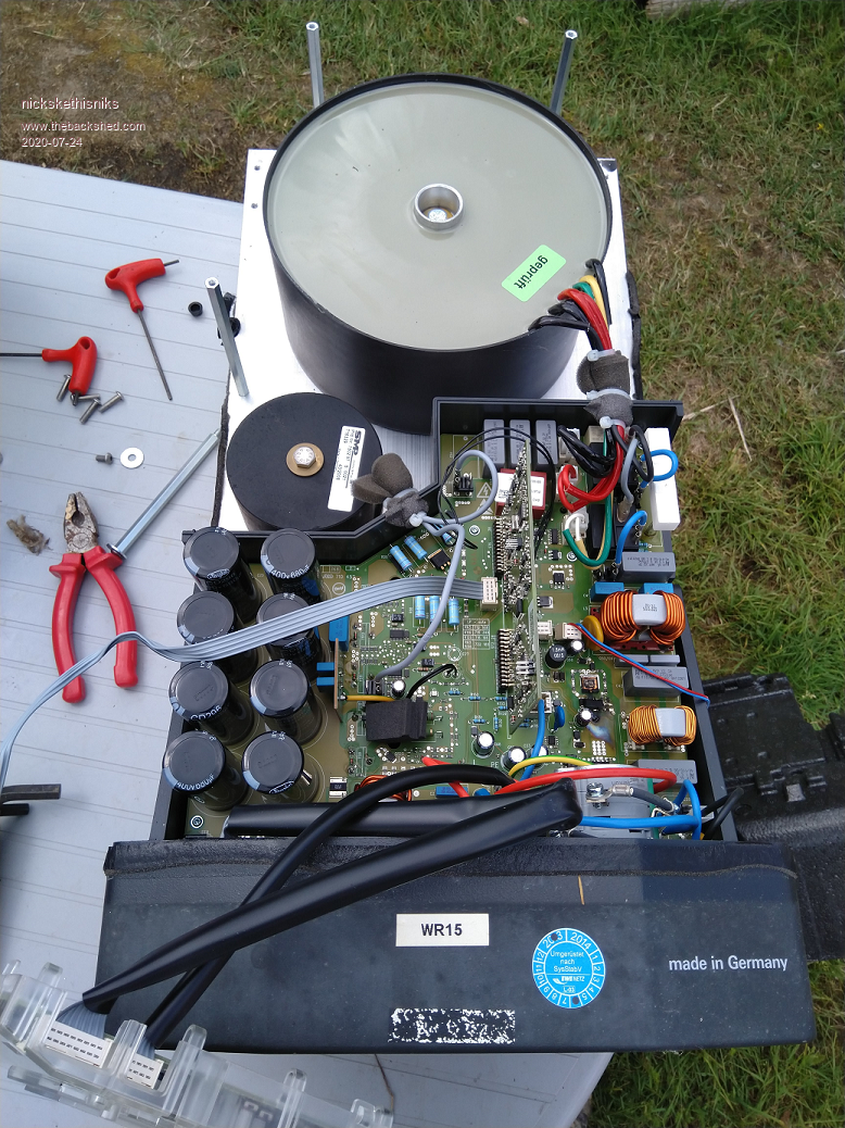

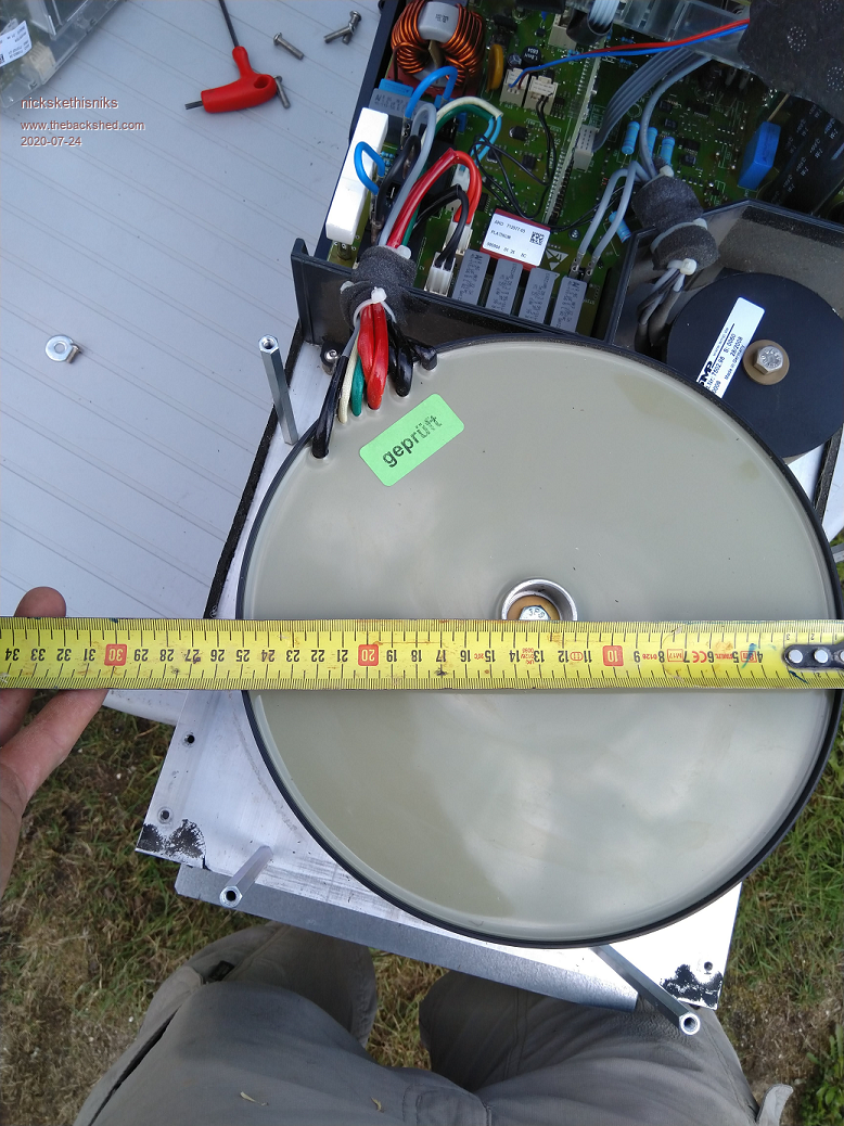

About a year ago in my quest to search for transformer cores I decided to look for old/broken solar inverters, well it wasn’t easy, there are not many here in Europe. And it’s sometimes ridiculous how much they ask for broken or used appliances.
My best chance was Ebay Germany, so I had searched for types with a toroid in them and I had a few brands/ types in mind. After a few months of active searching I found someone that was selling broken inverters, he was selling broken Diehl Platinum inverters. Downside, I had to buy a whole pallet. So 16 inverters for 570€, and inverters were between 2100S - 4601S series. Then there was another 345€ for transport, they were really heavy! So around 57€ a piece, for transformers between 1400 and 2600VA.
That time I thought the price was ok, it was the only source with a reasonable price, china was to expensive so as the EU based company’s. Now I know a source in UK recommended by Clockmanfr for 80€ excl transport(200OD, 100ID, 120H).
Although the 2100S type suggest 2100VA there was only a 1400VA ( rated for 1750W AC nomnial) transformer in it, with the 4601S there was only a 2600VA  (rated for 3800W AC nominal) transformer in it. So a little bit disappointed, another disappointment was that the transformers were incapsulated with epoxy…
But a few weeks ago I succeeded to remove the epoxy with a chisel quit easily (still about an hour of work). The outside winding is lost, but the primary stays intact.
They have an enormous heatsink as well and a pair of big igbt’s, various capacitors, filterstage, dc disconect switch,... The remarkable thing about those inverters is the fact that they are all basically the same, except for the inductor, transformer and firmware… all the rest is the same! The inverters were in fact all broken, and because they were all the same, 90% of the breakdown fault was also the same, a faulty power supply, the flyback circuit went BANG, ic’s and some zeners. I have repaired 3 of the most easy to fix, and they are now in service at my father’s place.  I think there was an overvoltage or lighting strike.
I'm using one enclosure for my solar controller, and I will make a second one as spare. Another one will be used for a spare 48VDC-240VAC inverter. I will find projects to fit in.
A few pics of the inside:
