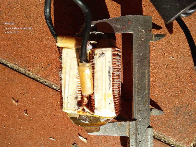

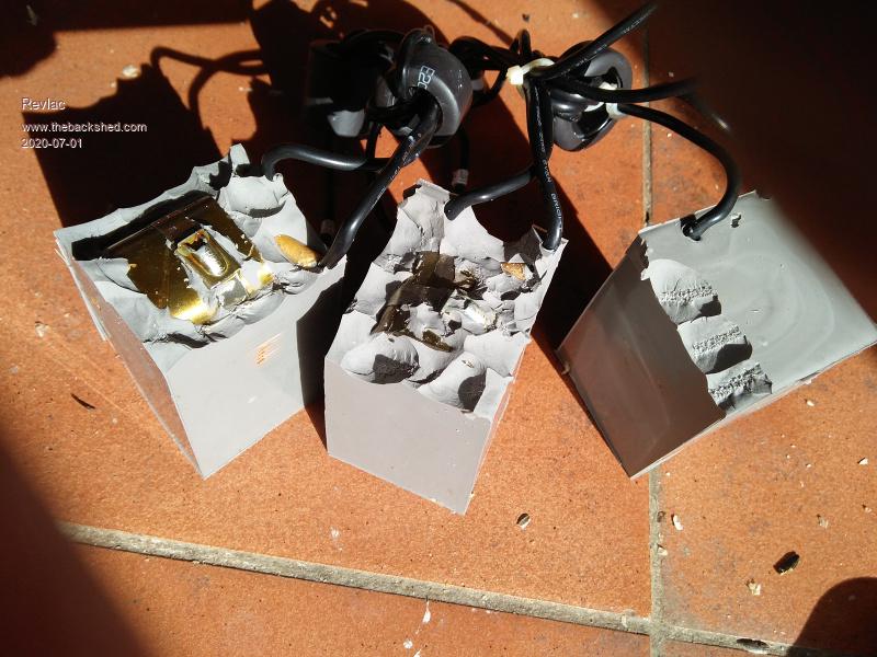

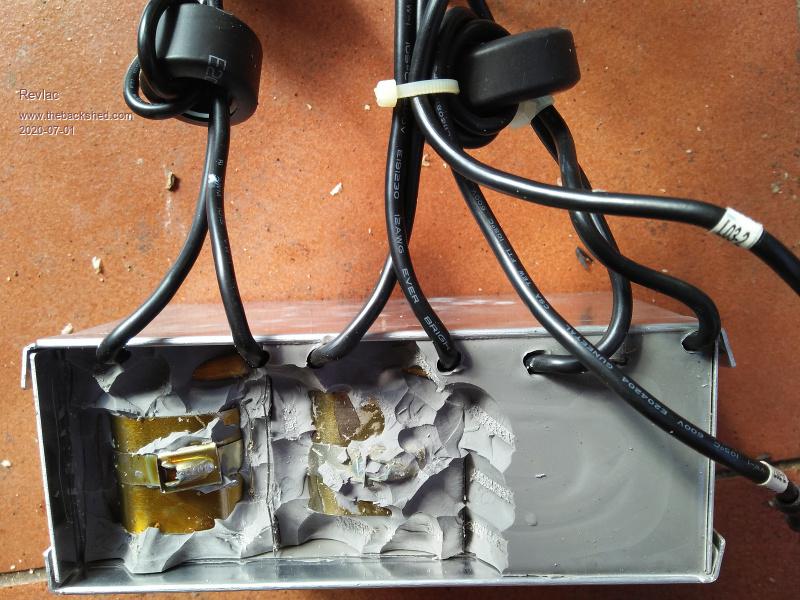

It has a aluminum box full of, Well, WTF you call it, anyway after digging some of it out I could see it has a C Core Inductor on it MPPT side.
A bit more digging and it appears to have 3 of these.
Not sure if the others are the same.
Now its out, it seems to be made of that thin flake silicon steal, the core measurements are 75mm long 30mm deep and 11mm thick core, the wire is about 1.6mm and roughly 26 turns per layer, 3 layers also both winding's seem to be parallel.

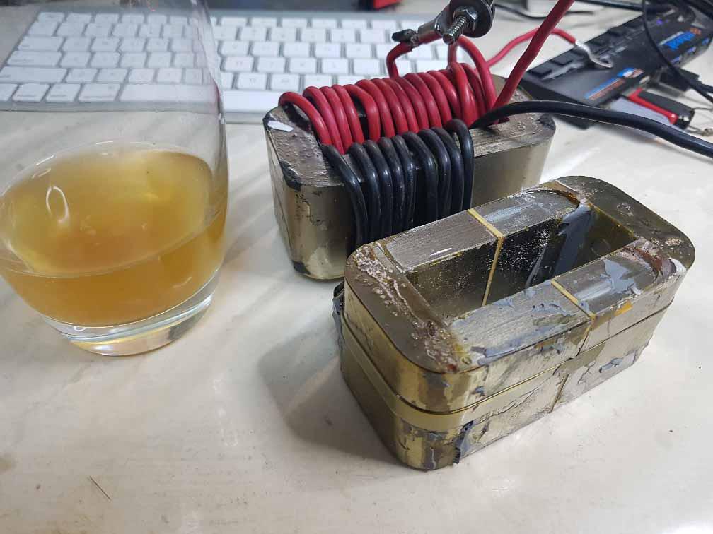

Today I got around to getting the big C core out of a large potted
thing I pulled out of one Aerosharp or the other.
It was rather like what you had but a bit bigger.
I used the 4" angle grinder to remove all copper windings, then belted
the inner part out with a hammer and drift. Now I have another one of these:
the laminations are paper thin, and that is why they work at these
high frequencies (for Si-Iron cores)
These cores are quite good, only need 20 turns for 150uH. No more Henries are needed.

Mark used two sets of those cores, with 14 turns of 20mm sq wire (10mm O.D. over the plastic) which had two layers of 7 turns around both sets of cores, which ended up being a bit of a tight fit.
That was for his 5Kw pwm inverter choke.
From what I remember, it ended up measuring as 185uH and had about 135 amps saturation with the original air gaps.
