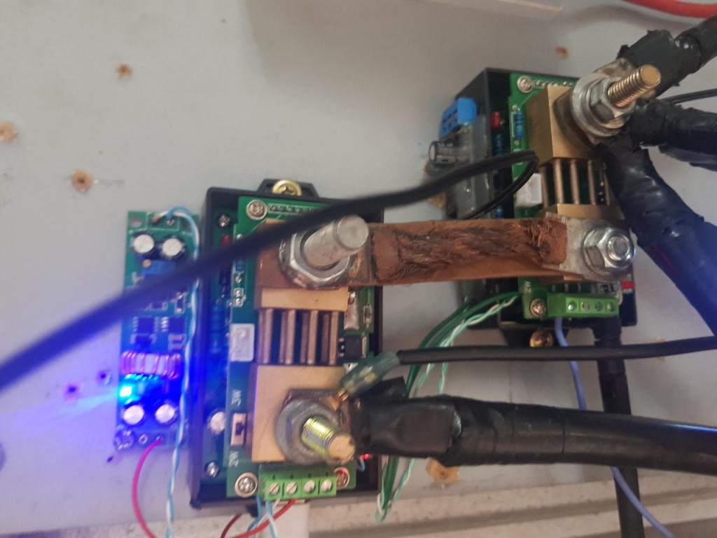

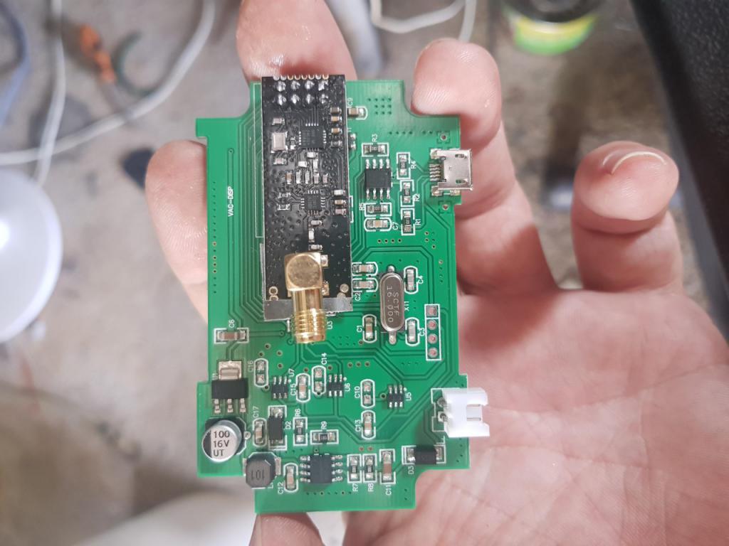

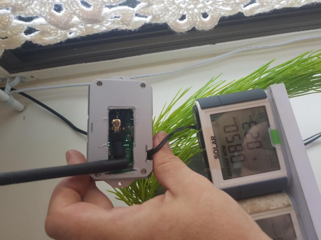

so lets fix that, it uses the standard NRF24L01 modules... sweet order some palna+ versions , like this NRF24L01 palna+
matter of squeezing them in... sorry only took finished pics, but you get the idea..

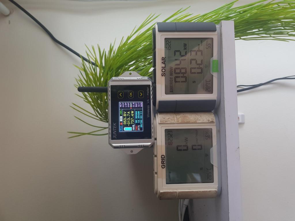

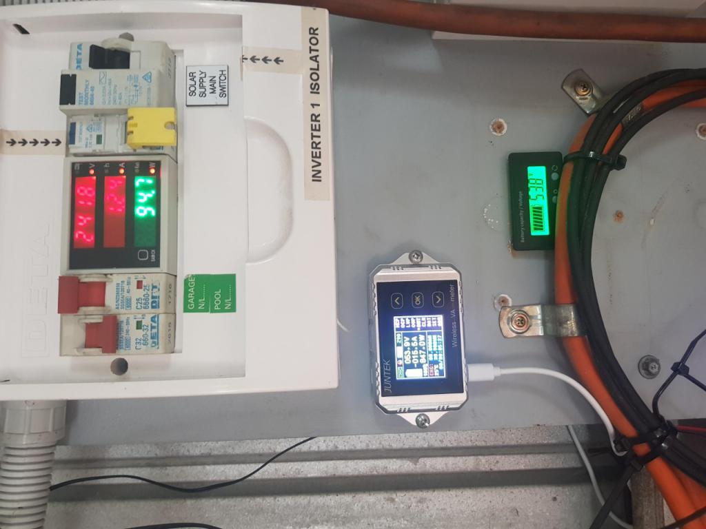

first pic, installed in the "sender " unit, i have 2, one does wired in shed, other is inside house.
Happily transmits inside about 30-40 metres away, with 2 walls.. happy camper
I think it works !!
