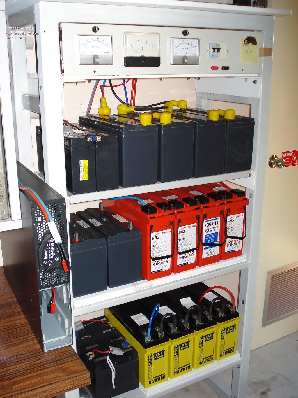

Nice battery shelf BTW.

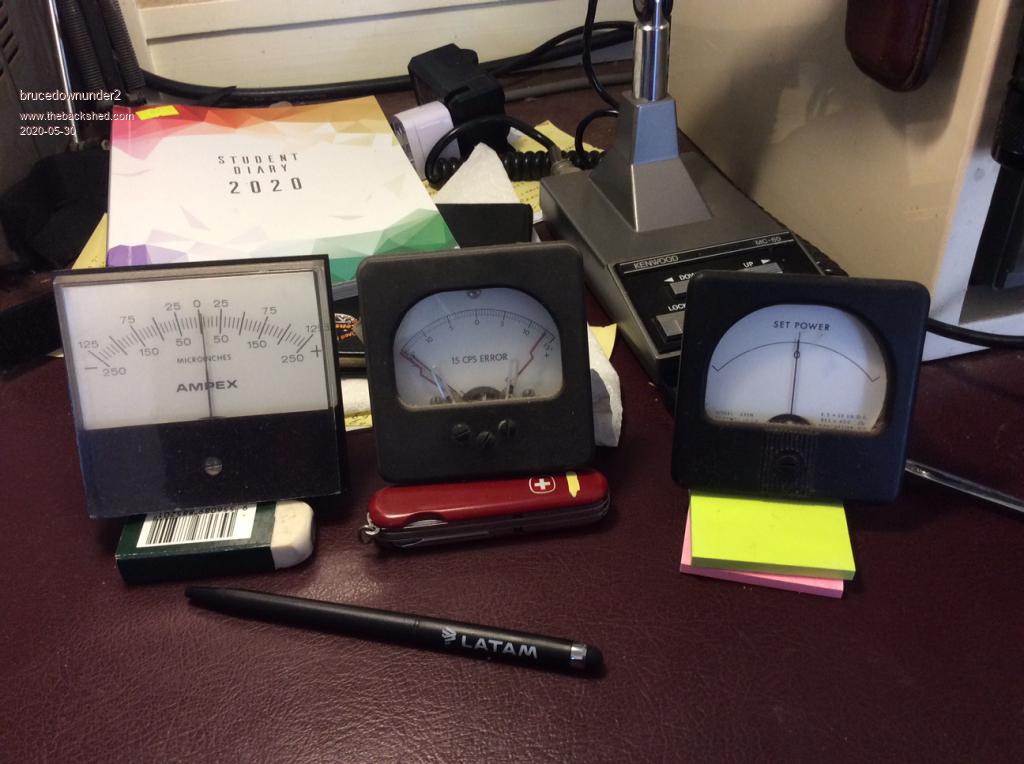

I was thinking of this type of meter for the power "IN'. and "OUT" .  The centre of the dial being Zero.
I have one that even has a set of alarm contacts ,, which would be fancy for "Fiddlers" like me !!.
/Users/bruce/Library/Containers/com.apple.mail/Data/Library/Mail Downloads/2983B561-B834-4C8E-945F-673B26E78F36/IMG_0810.JPG
The meter face could be re-worked and appropriate shunt calibrated for the particular task.

Thanks Tony .   That has always been the messy bit ,can remember drawing out the display and photocopy ing it ,cut and paste parts.

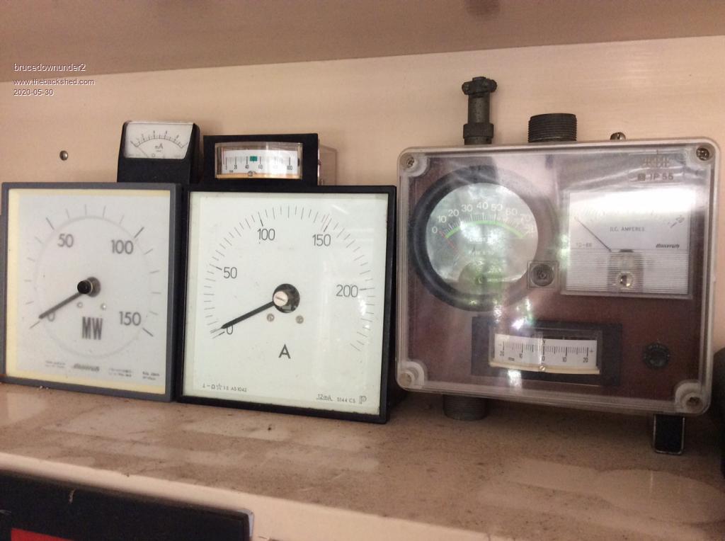

So, I'll fiddle with your link and see what sort of job I can do ??.  Thanks.  (I have some very big meters ,like 6 inch square that one day I was going to recalibrate for a windmill RPM meter .would have been fancy in the living room wall....
/Users/bruce/Desktop/IMG_0811.JPG

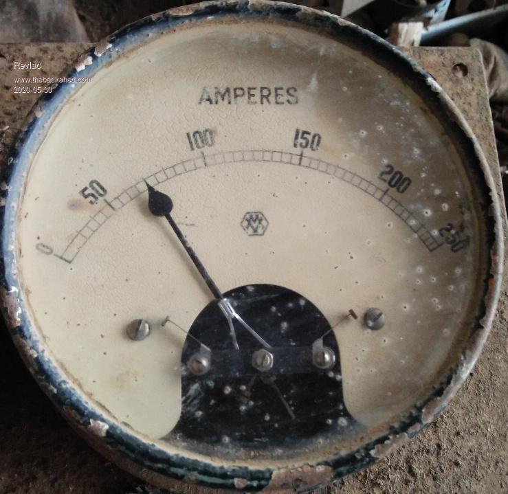

The old Man has a couple of old meters with the face plates looking a bit sad, Had a bit of a play with that Basic meter program, Some of the samples with a few changes look just like the proper job.
Printed face plates will work for a time, unless the sunlight gets to it, I think some of them are painted.
Perhaps these could be laser etched on to the face plate, Perhaps a K40 Could do this.
Not sure if that works.

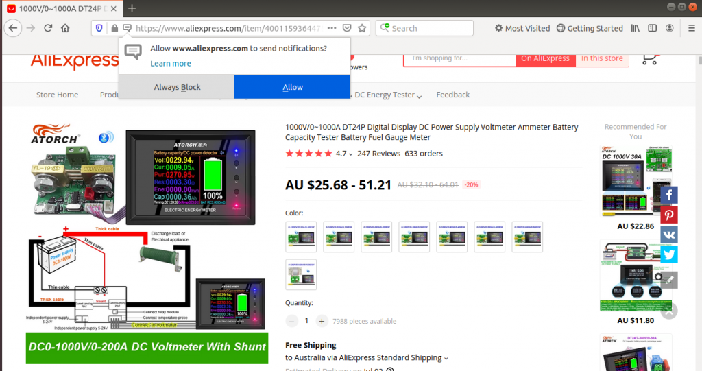

Looking around, I see another energy meter1000V/0~1000A DT24P Digital Display DC Power Supply Voltmeter Ammeter Battery Capacity Tester Battery Fuel Gauge Meter
Anyone have any experience with these, just interesting that it has Bluetooth as well.
Cheers Aaron
Off The Grid
BenandAmber
Joined: 16/02/2019
Posts: 961
Posted: 04:40am 08 Jun 2021
I read about so many meters the other night
One of these meters info BOOK said
if it is not reading in both power in and out then it's not wired correctly
it had a diagram showing how to correct it
I think it was the location of shunt and or current ring
It somehow works right because of the meeters voltage input so closer to batteries or closer to solar in
I am sorry so wishy washy but I hope it helps
Bruce your battery cabinet with those meeters in it is what in the states we call old school COOL!!!

Revlac
Joined: 31/12/2016
Posts: 1310
Posted: 10:47am 08 Jun 2021
The meter looks like it shows (SOC) state of charge, so it should know power in and power out, but might only display it one way, don't know yet.
