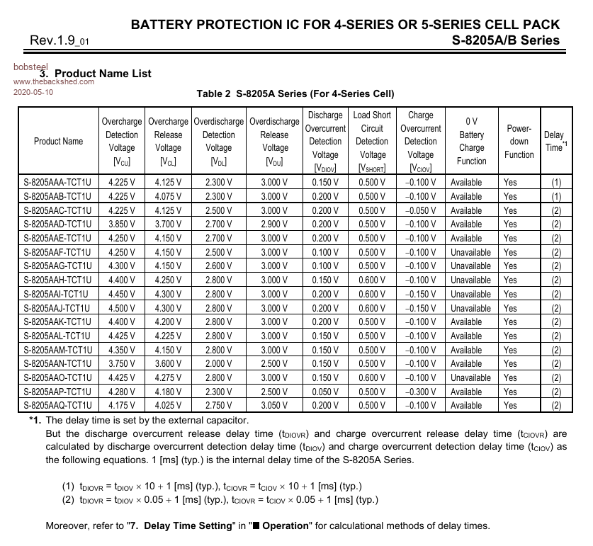

I'd be interested in finding one with some sort of adjustment of the actual charging chip used . IE using a TP4056 designed to cut off at 4.2v exactly but can be adjusted to 4.1v cut off.
People should understand too that LiPo cells are 3.7v nominal but spend most of their charge time at about 3.9v . Its not linea as I understand it. They can be charged easily and safely with a 5v input limiting the current to a quarter of their capacity without damage but when the plates get to 4.2v they are damaged.
A circuit example
So there are many chips available for various cut off voltages but I don't see how I can set them to cut off a bit lower ?
