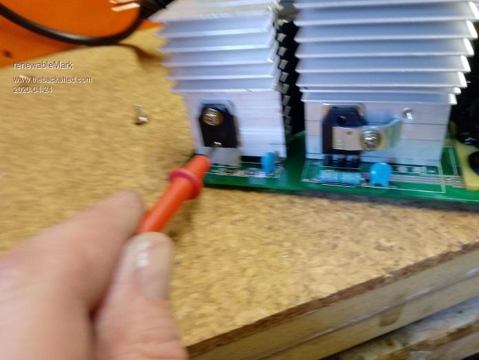

Noneya, I have a similar welder, I tested the output plugs and there is no output, it only seems to work after the electrode has a strike, then it starts welding.
Is there some trick to bypass that?
Cheers Caveman Mark

Hey noneya, can you hook up a multimeter to the connections and get a reading with that unit you showed?
If that's the case, I'll just get one of those, and keep my other one as a welder, I need one anyway.

Yes the output voltage is about 90v sort of like OC voltage on a panel, as soon as load hits it, it drops, but ive never had a problem with it... i just make sure its hooked to battery before turning on..
I know some have that " feature " but that one ( which is the same i have, and pretty sure the likes of oztules etc. ) doesn't have it..
I think it works !!

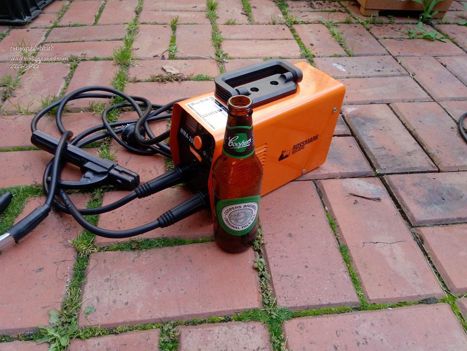

Just looking, the " rossi " ones i have purchased for a friend and was well built too... and cheaper lol.. its actually quite surprising what you get for the price,  oz reckons they weld quite well too..
Check specs in photos,  most have about a 60v OC voltage, full current about 25v... why i suggested adding the extra turns, found you need to, to get the full range of current control, else its limited by voltage ( mine out of box was about 1200watt).

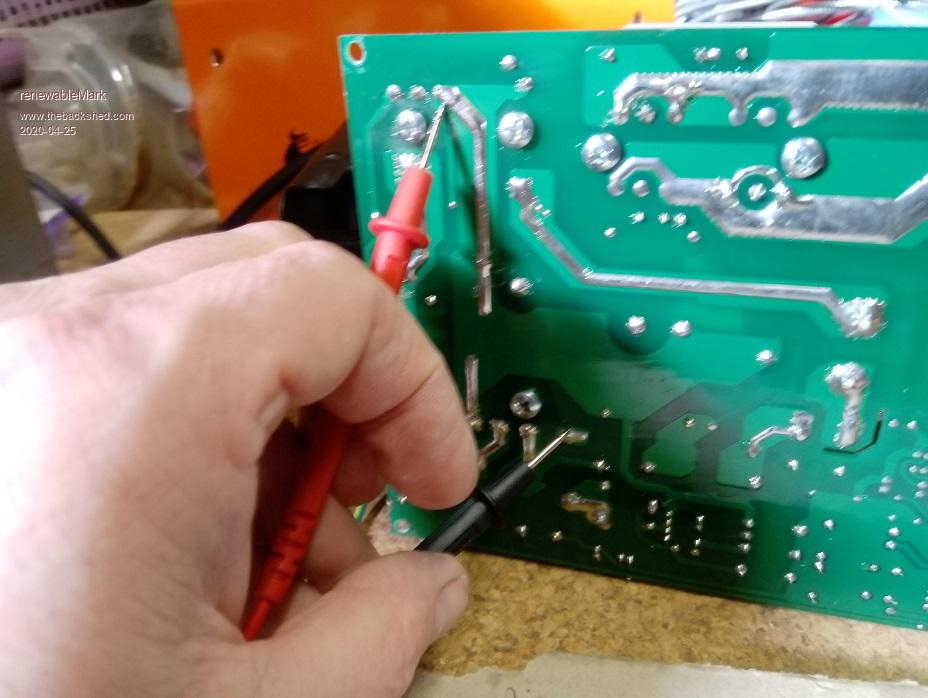

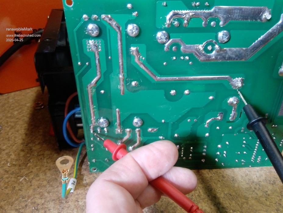

Just checked mine again and it has open circuit voltage!! WTF didn't before. Used another multimeter and nothing.... Grrr swapped probes and it works on that multi now.
One set of probes in the bin then.
Good news it shows 62v O/C, I'll hook it up to 48v battery later and see what it does.

This is the one
The specs say 72v open circuit, but it's actually 62v.
Anyway I hooked it up as is to the battery and it feeds in 1.9 Amps.
So more turns are required.

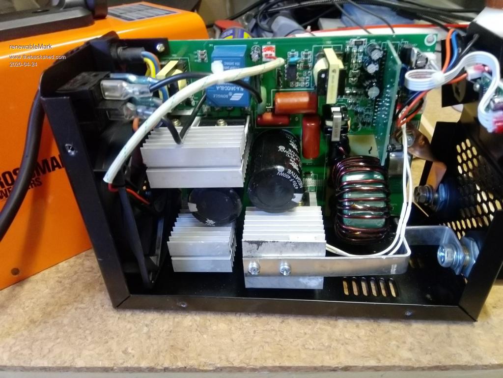

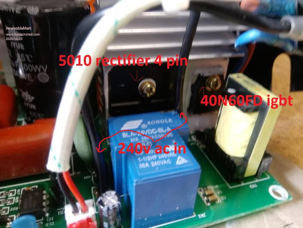

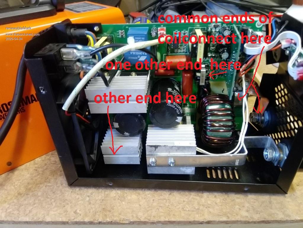

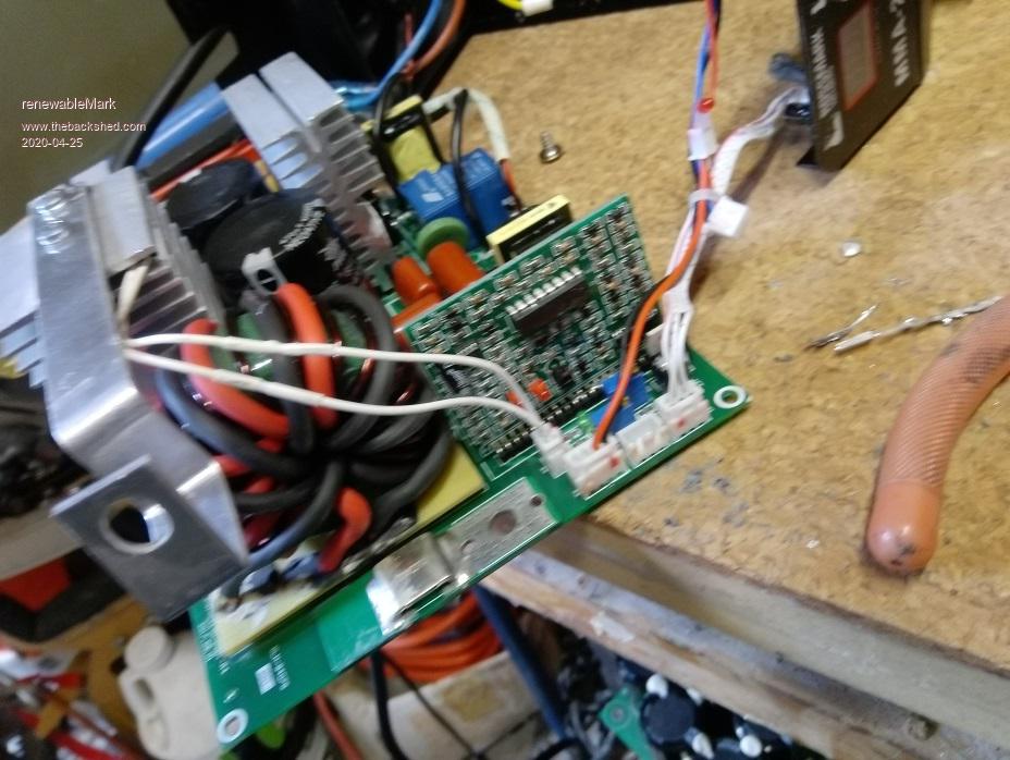

Opened it up and it looks like this.
The coil looks to have two windings on it, one common that goes to the negative lead on the output.
The other ends go to a small transformer about the size of a dice, and the other end goes to the drain of one of the IGBT's
So is the idea to add windings on both?
Edited 2020-04-24 16:17 by renewableMark
Cheers Caveman Mark
Off grid eastern Melb

Hi Mark. First time I've ever seen inside something like that, the "coil" I think is actually a transformer. It looks like it could have 3 windings.
I think you should employ Poida or Warps skills to modify the first unit unless Noneya has that exact unit and can assist you.  If it has 3 windings at least one will probably be the HV power drive (~ 350VDC), the other 2 could be a full wave rectifier for the output.
You are probably correct to add 2 turns to 2 windings, but the winding going to the IGBT drain/collector may not be the right one to touch. Tread warily & good luck!
If there are 2 tracks from windings going to devices on the larger heatsink with the strap on the topside going to the other output terminal they would probably be the windings to add turns to - I cant tell from the pictures.
Edited 2020-04-24 19:42 by wiseguy

Posted: 10:00am 24 Apr 2020
I really cannot help here, as I no nothing about these types of welder. I would need to actually have one in front of me so I could try to figure out what it all does, and then try a few things.
It may not need to have any of the main windings physically changed, perhaps just the feedback or the system that controls the output voltage. It depends how far short the voltage is.
Definitely has possibilities though, but it might also be fairly easy to kill it if you did the wrong thing.

Oh come on Tony wheres your sense of adveture lol.  I looked again at the PCB pictures its just an overgrown PC Power supply with a half bridge drive ?  The two red arrows pointing to the left are actually the drive winding I reckon, the two thick wires you can just see at the top side of the same picture I reckon are the other ends of the common (high current output) winding. I believe there is no voltage feedback only current feedback from the shunt so you need to add sufficient turns until the current limit is working and that it pushes reasonable current as the Batt voltage climb to full.
A mans gotta know his limitations .........
Edited 2020-04-24 20:12 by wiseguy
Cheers Mike
Posted: 10:17am 24 Apr 2020
You could be right Mike, as there is only a single knob that controls current.
There may be more to this though.
That winding on the toroid does not look like capable of 200 amps to me.
