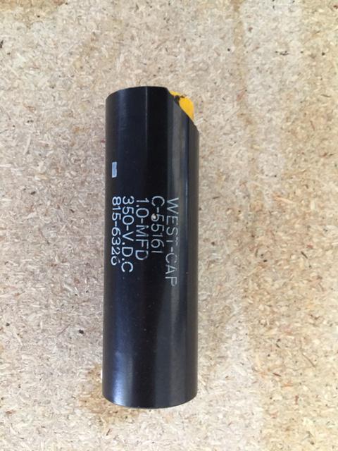

I do have a broken capacitor that I can't identify.
Don't know if the Minus sign before the number indicates it is polarized, but suspect
that it is. So the question is, can I replace it with an electrolytic ?
Haven't got a manual for this but will search for it. It worked very well before I packed it up.

It's hard to tell without a reference to scale, but it looks to be non-polarized (or bipolar, same thing) cap.
This one would probably work just fine:
https://www.ebay.com/itm/CBB60-D12-2uf-450-Volt-Handing-Round-Motor-Run-Capacitor/141712350333?hash=item20feb6dc7d:g:1bMAAOSwFNZWz3yB
If your device can tolerate a bit less voltage, this might be a good one for you:
https://www.ebay.com/itm/2-NOS-Bipolar-Sprague-1uF-300VNP-Aluminum-Axial-Electrolytic-Capacitor-TVAN1560/133362295917?hash=item1f0d03246d:g:eY0AAOSwvGdbmbkb
Posted: 07:17am 06 Apr 2020
I suspect you are right about the minus sign especially as it does say 350VDC so getting the polarity right would have been important or you get a visit from Grogster's genie.
Even so, generally capacitance is capacitance - you can usually go TO bipolar from electrolytic but not the other way around (barring special requirements).
I would chuck a 1uF 400V X type (used in mains filters etc.) in there and see what happens. Can't hurt and they are cheap as...

Many thanks for the responses and links.
Wow I didn't know capacitors could get that expensive.
Spent the money and ordered a manual for it, so once that arrives the circuits should
shed more light on the purpose.
