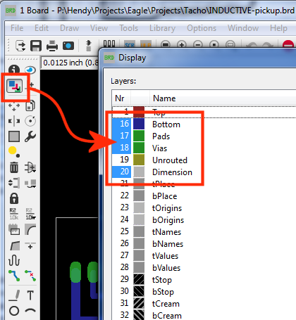

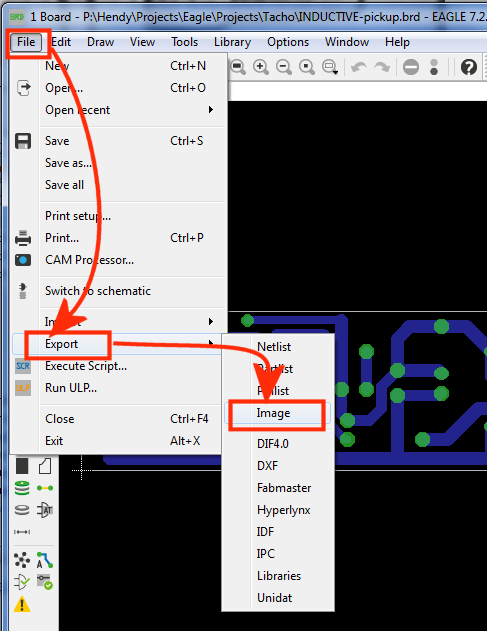

So in Eagle, adjust the view so it only shows the layers for bottom tracks, pad, vias and the outline:
Then export the result as a PNG:

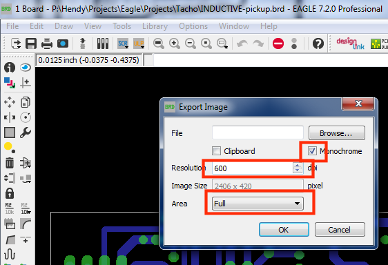

and save it out as a monochrome foil pattern. Use a minimum Dots per inch of 600
So that is the foil saved as a black and white PNG.

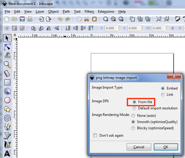

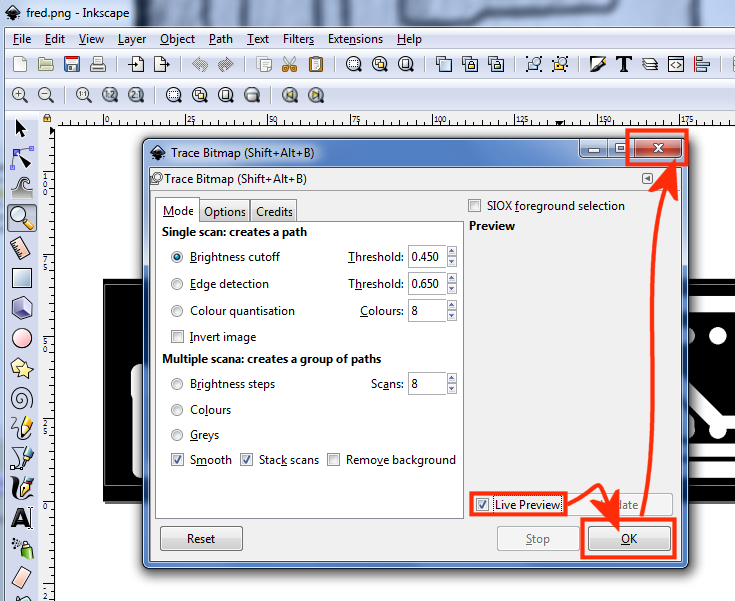

I use InkScape to convert the PNG to an SVG vector file (which is 90% of the way to GeRBL). Open the foil PNG in Inkscape using the DPI from the file - this maintains your dimensions from Eagle:

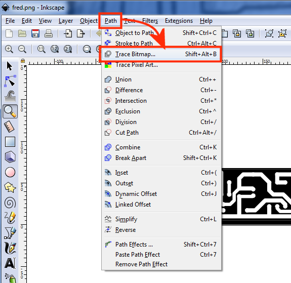

then use the path/Trace bitmap tool to trace the outline of the foil.
Click OK and close the tool window:
Then Save As SVG... I don't know what the difference between "InkScape SVG" and "Plain SVG" is, I always use the InkScape flavour as it comes up first and it's one less thing to change.

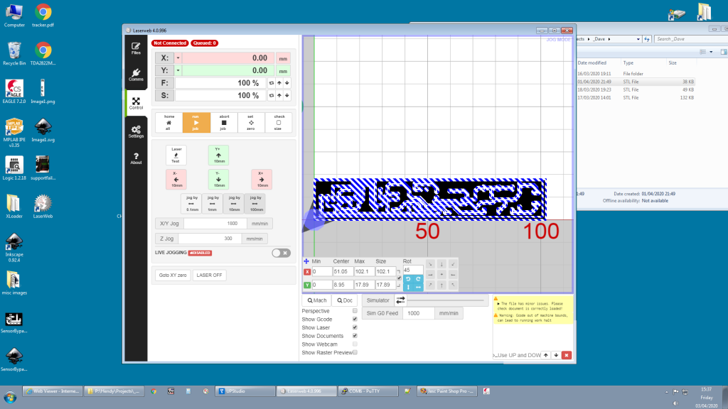

You are know ready to etch the board using your laser. To do this I use LaserWeb.

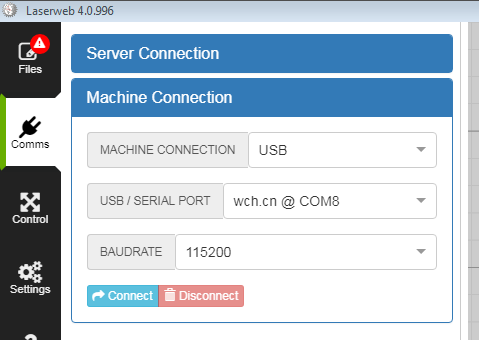

Open LaserWeb and connect to your laser

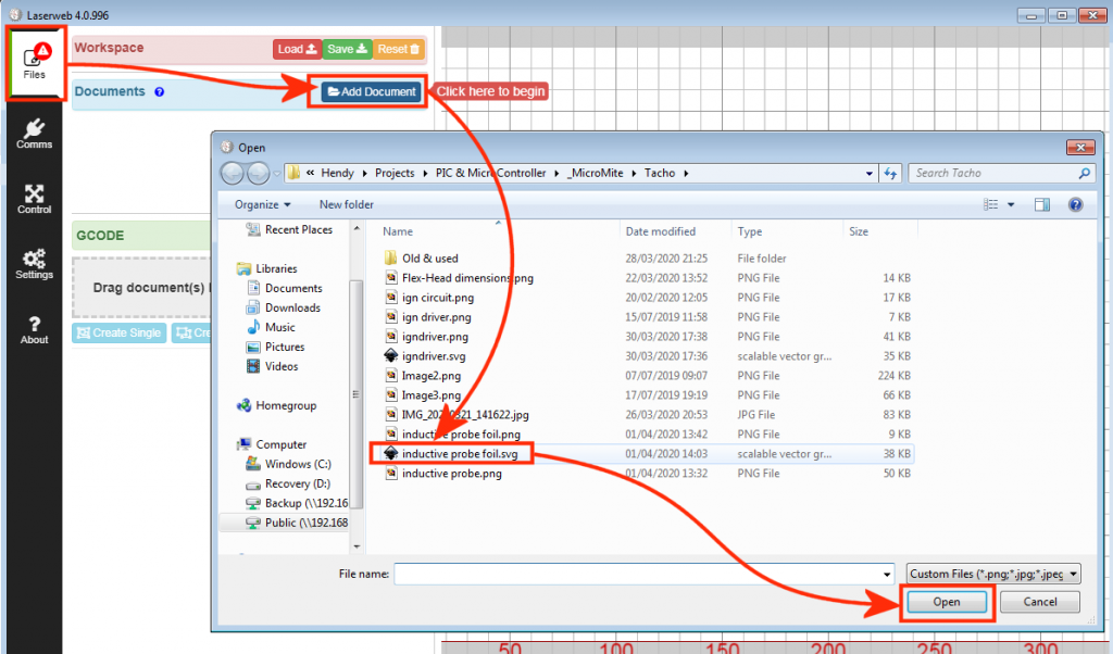

and import the SVG into the Documents control

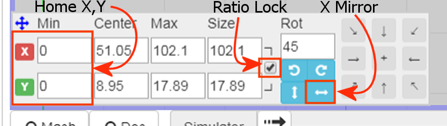

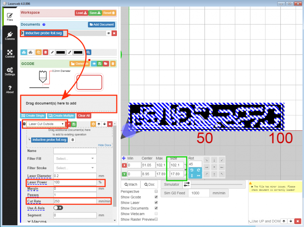

Then drag it to the GRBL generator, note the laser settings (Cut outside/100%/250mm/min) Noye also in the green box... the dimensions have been preserved from Eagle.
Now, my X co-ordinate is reversed which by accident provides the reversing of the foil required to get a true PCB out of the process. If your X & Y increase from south-west to north-east, you need to flip the image horizontally. Ensure the dimensions are locked then use the X-Mirror tool. set your home co-ordinate back to 0,0 afterwards as the flipping might have moved them.

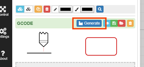

To generate the GRBL code, click the Genrate button - you may get some minor warning about the file (perhaps this is the difference between the two types of SVG?)

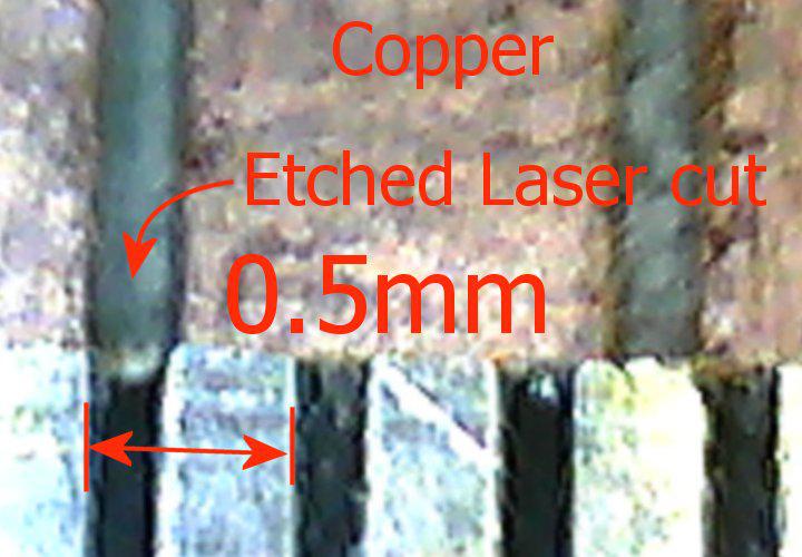

here is a pic from my microscope of an etched copper board with a steel rule across it for measurement... it actually is probably 0.1 - 0.2mm ish in reality.

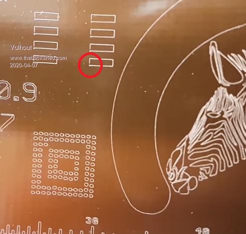

But even after all the improvements, when I saw the result shown in his video, it had the same artefacts that I observed.
I am not sure this is in the EleksLaser hardware, in the Arduino nano grbl code, a setting, or in the code that controls the machine. Could be any of those.
