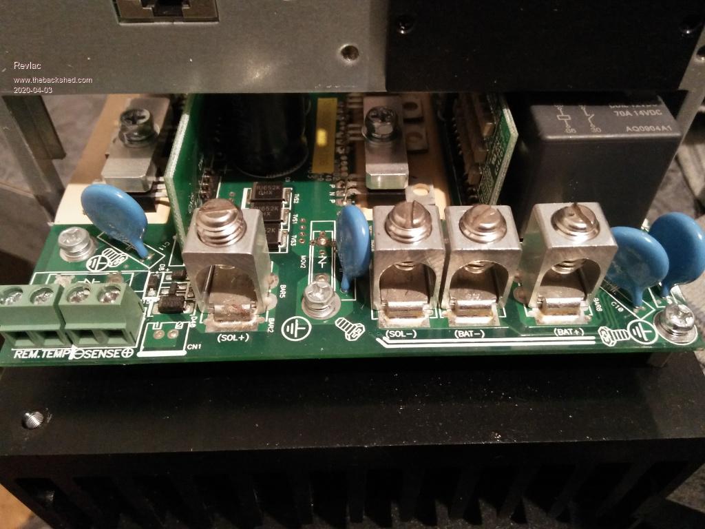

Here is the inputs at the bottom of the controller, on the right is a pair of relays 12v/14v 70A, at least one of them can disconnect the unit from the battery under load without an issue, saw it in action the other day when it tripped with over voltage while charging (my setting were a bit high).
Just left of the relay is a SMD Capacitor board, double sided, don't ask me how many...I didn't,t bother to count the little buggers.

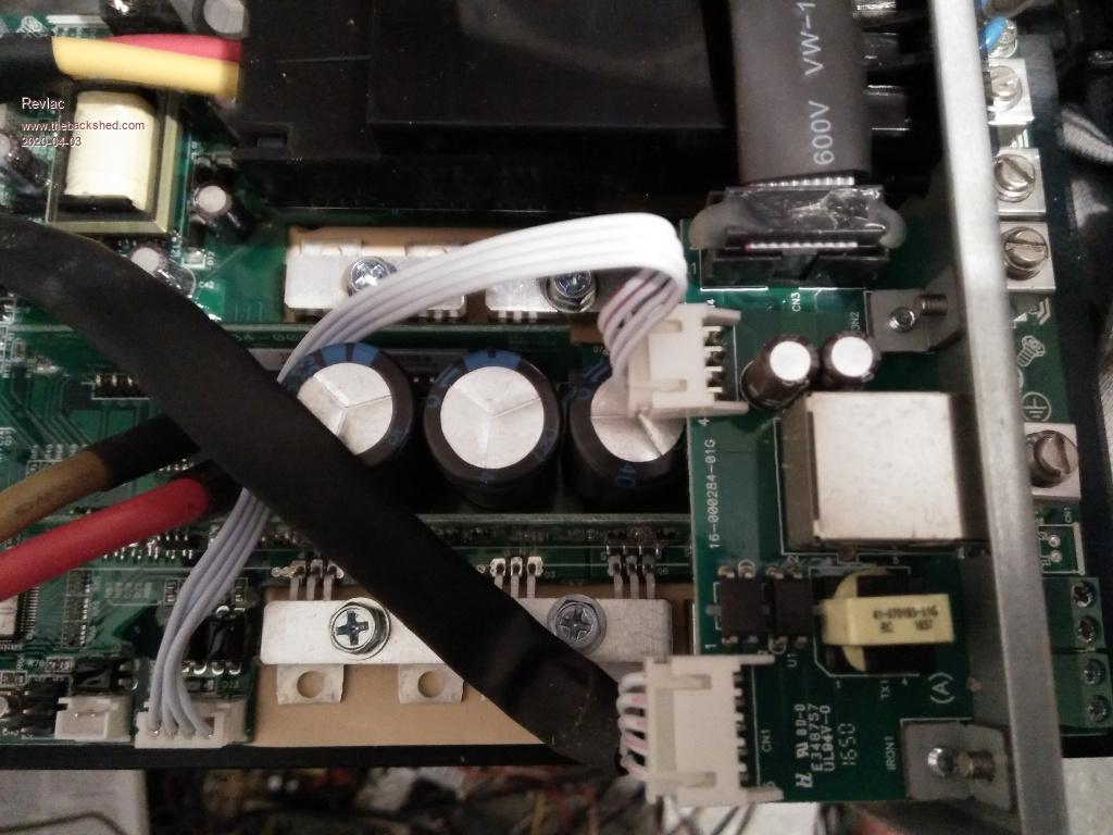

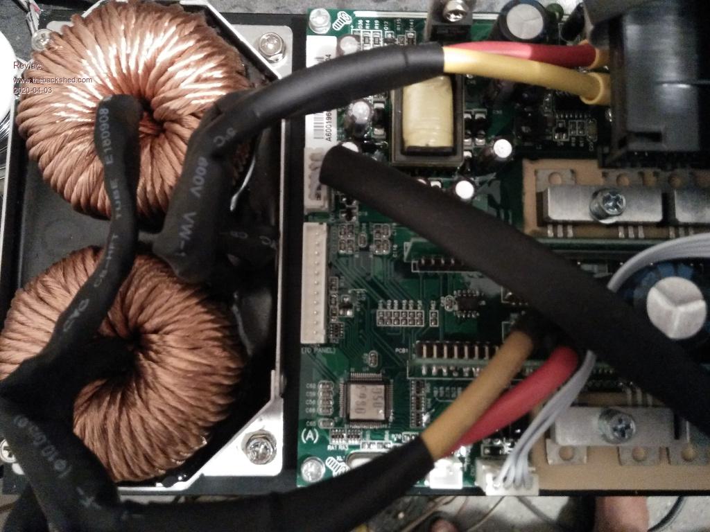

Now there is a pair of inductors, the lower one, the yellow wire I found it to be a little burnt, this was due to the spade terminal been a little loos where connected to the main board, why they didn't put in screw terminals I don't know, they have them at the top connection.
Repaired that and stuck a bit of shrink wrap over that to Finnish it off.
The 4 capacitors are 330uf 160v, just below them is 4 PNP transistors further right just out of sight is 4 mosfets, the row above them is the same just the other way round as its the 4 fets that can be seen above the capacitors.
Didn't have time to check any details on it, needed to get it back into service.
