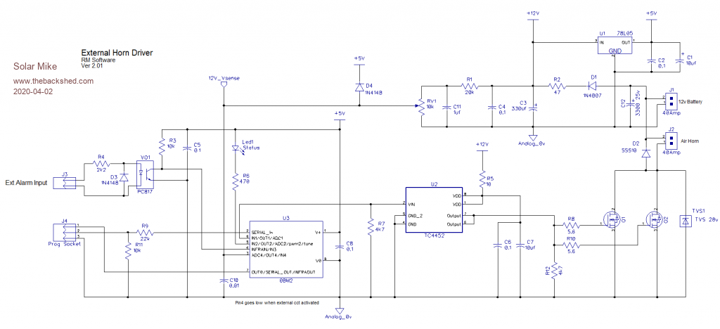

We are adding a very loud truck air horn to our site alarm, this will hopefully help deter would be thieves; it will be driven off the other sonar alerts already fitted to the system.
The horns air compressor runs off 12 volts and draws approx 30 amps, running it for more that 30 seconds seriously over heats the motor. So to avoid this I need something to pulse the motor on\off....on\off in a sequence over a 5 minute period that prevents the motor burning out. A simple timer with a car horn relay may work, but as its continually switching on\off, its contacts would rapidly burn out.
So decided to make a simple intelligent solid state switcher, driven by the continuous input signal from the existing alarm and an optocoupler input. Power this off a separate small 12v sealed lead battery. Replace the relay with two mosfets will give a combined RDSon of approx 1.5mR, and at 30 amps dissipate approx 1.35 watts, virtually no heat-sink required. The 8 pin Picaxe cpu has the brains to pulse the horn and switch off when the input signal stops or the battery starts going flat.
Will create a small pcb next.

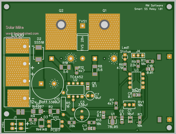

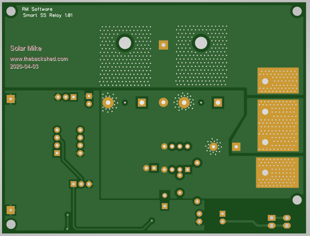

Solar Mike
Joined: 08/02/2015
Posts: 1255
Posted: 02:21am 03 Apr 2020
PCB, 100 x 76mm
Q1,2 have drains joined on pcb, which acts as a heat sink, center pin not connected to pcb.
Have added provision to run off other higher voltages by adding pads for 72-12v psu at the end of the board, maybe useful if we want to power stuff off 48v battery.
Mike
