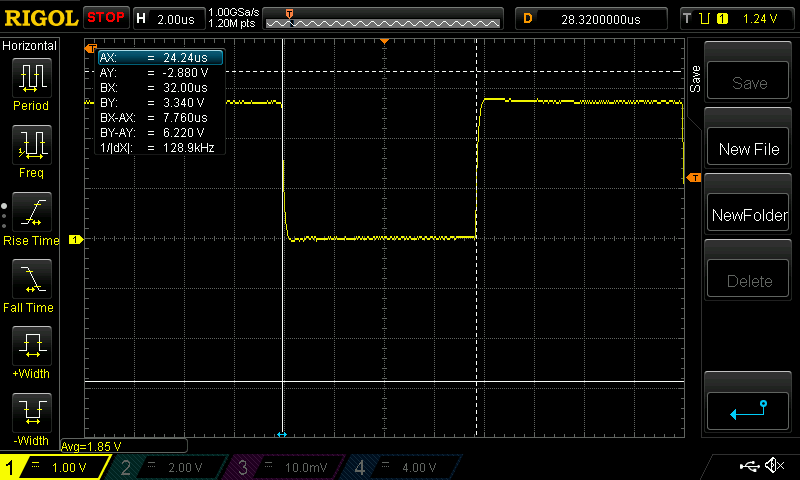

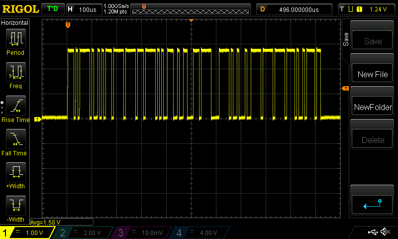

Here is what is on canbus High and low wires. This is output even if the
canbus transceiver is unpowered. I have 200R termination present and when absent
there are spikes in the hi/low or low/hi transitions as well as rounded risetime.
So the termination resistors stay.
it is 125KHz canbus speed.
and the supply spits this particlar data stream out continuously
Here is the signal. No idea what it means.
Anybody here know much about canbus?
Is this signal suitable for input into the MCP2515 canbus transceiver chip
to be detected correctly and converted to data?

Which Rigol do you have? Some of them with "field upgrade" (google your model) can interpret Canbus directly.
https://www.youtube.com/watch?v=METmiiieV6Y
poida
Joined: 02/02/2017
Posts: 1507
Posted: 07:12am 29 Mar 2020
I have the DS1054Z with all options enabled here at home. At work I have a DS2072 with all options.
But decoding canbus is no longer needed. I have some code working now that can talk to and listen from the Eltek.
I just changed the default output voltage to 48.00V
Now to change default current limits...

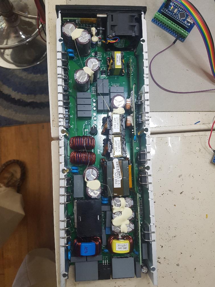

We can get Eltek 2kW HE power supplies for about $70-80 here in AUS
They are very efficient and have near 1.0 power factor.
Input is 240V AC, output 43.5 V to 57.4V with an internal 2kW output limit.
There are no user controls. All settings are done via canbus.

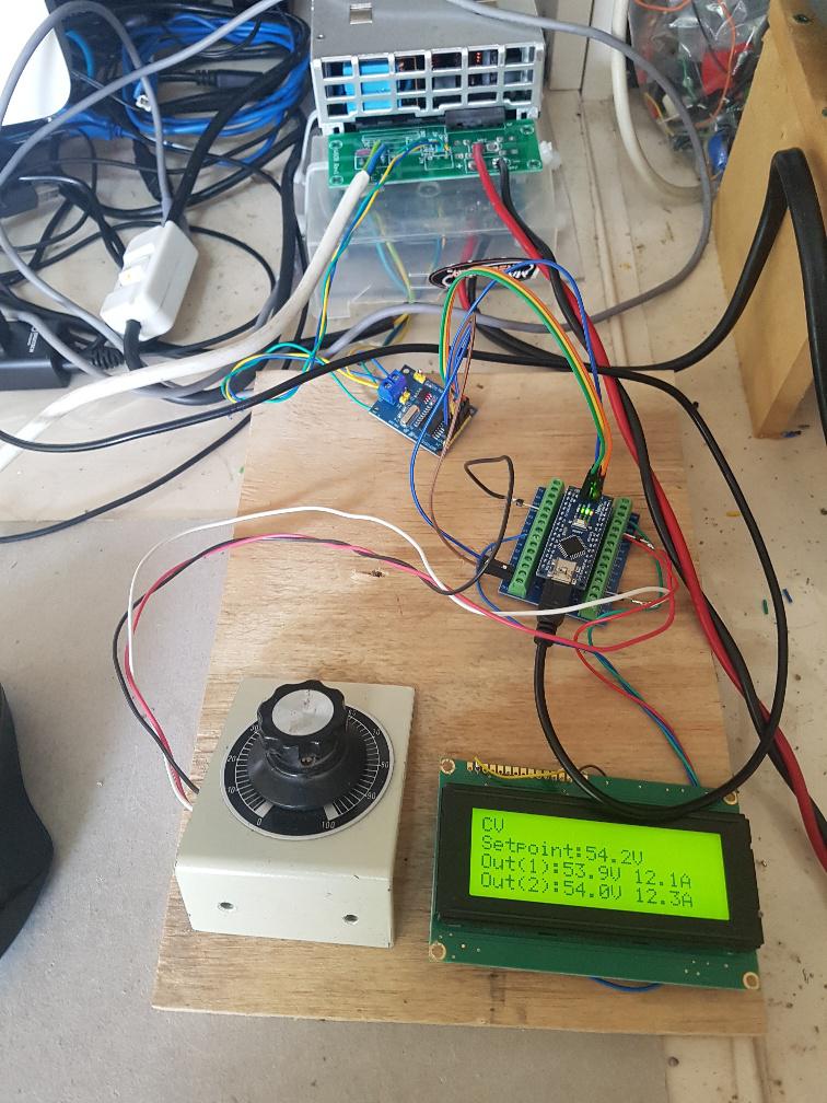

Wiseguy has a need to have 2 or 3 of these PS in parallel with control over
output voltage & current in total and the individual PS.
I was talking with RenewableMark about these things and he wants to use one

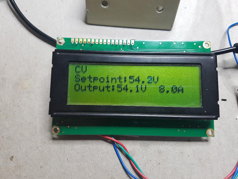

as a battery charger for his 48V (ex. forklift) battery for the home solar.
Today I want to show progress in establishing a basic understanding of control via canbus.

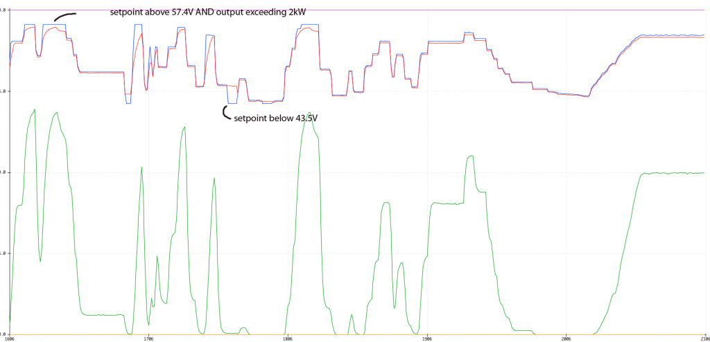

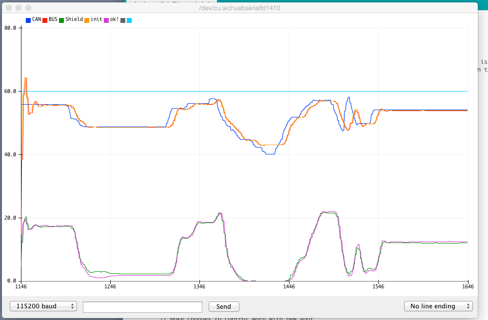

A power supply can be run in constant voltage mode (CV) or constant current mode (CC) or both. I have the Eltek working in both modes now.
First CV:
The Eltek can only output voltage in the range of 43.5 - 57.4V so there is no point
directing it to output voltages outside that range. It continues to run, but will never exceed either ends of the limit.
I hacked up an Arduino Uno with output voltage control via a potentiometer and it works surprisingly well. Load is a solar buck converter and the 1 Ohm 3kW bucket of water.
The code can set the output voltage of course and it can get the Eltek's operating data too, which includes output voltage and output current.
I plot the voltage setpoint, output voltage and output current below
in Blue, Red and Green. There are 500 data points in this graph and data is plotted
at about 5 Hz (5 points a second). This gives you an idea how quickly the PS can respond to changes to the setpoint.
Vertical scale is 0,15,30,45,60.
Output may exceed 2kW for a second but it is quickly brought back to 2kW by
the Eltek's control system.

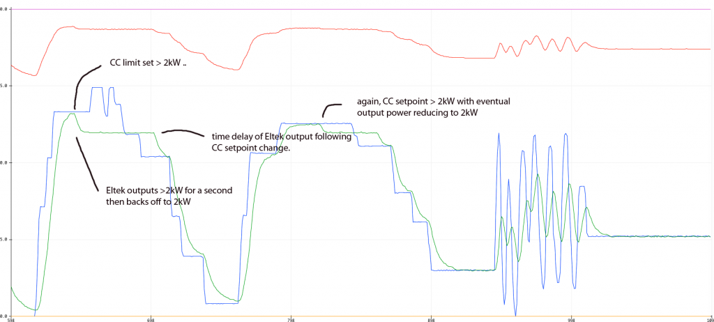

I did some testing to see how the PS operates under CC.
Instead of sending a voltage setpoint, I send a current limit to the PS.
I had to modify the solar buck converter firmware to simulate a discharged battery.
The converter/simulated battery draws maximum power when input voltage is 57V and zero power when
input is 45V. This simulates a lead acid battery quite well I think and more importantly this load permits the Eltek control system to reduce the output voltage
to bring output current down to the setpoint over the entire range of values (0 Amps to 45A)
If I used a resistor I would only have a narrow range of power levels where the Eltek could control output current. The simulated battery load is very non-linear but works as it should.
I vary the output current setpoint via a pot and we can see the Eltek track the changes.
Blue is CURRENT setpoint, Red is output voltage, Green is output current.
It appears the CC tracking is a bit slower than CV.
The above results show I can control both the output voltage and current

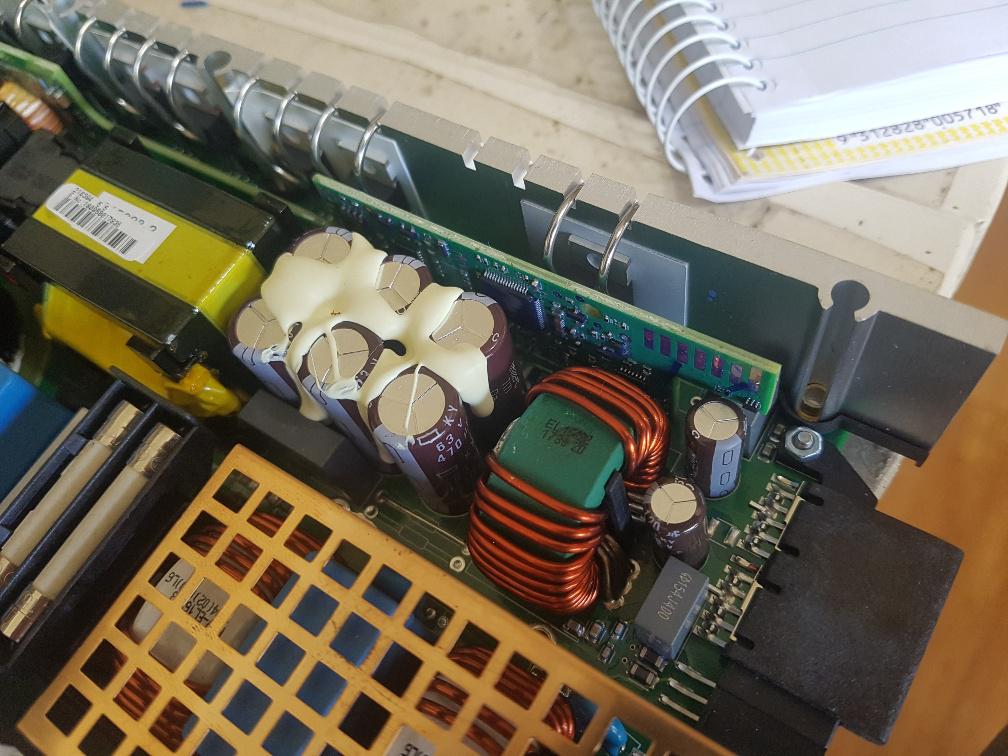

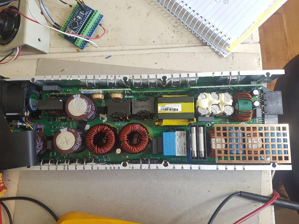

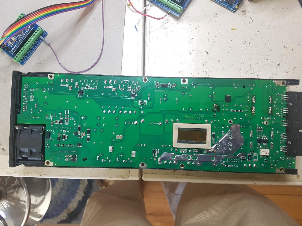

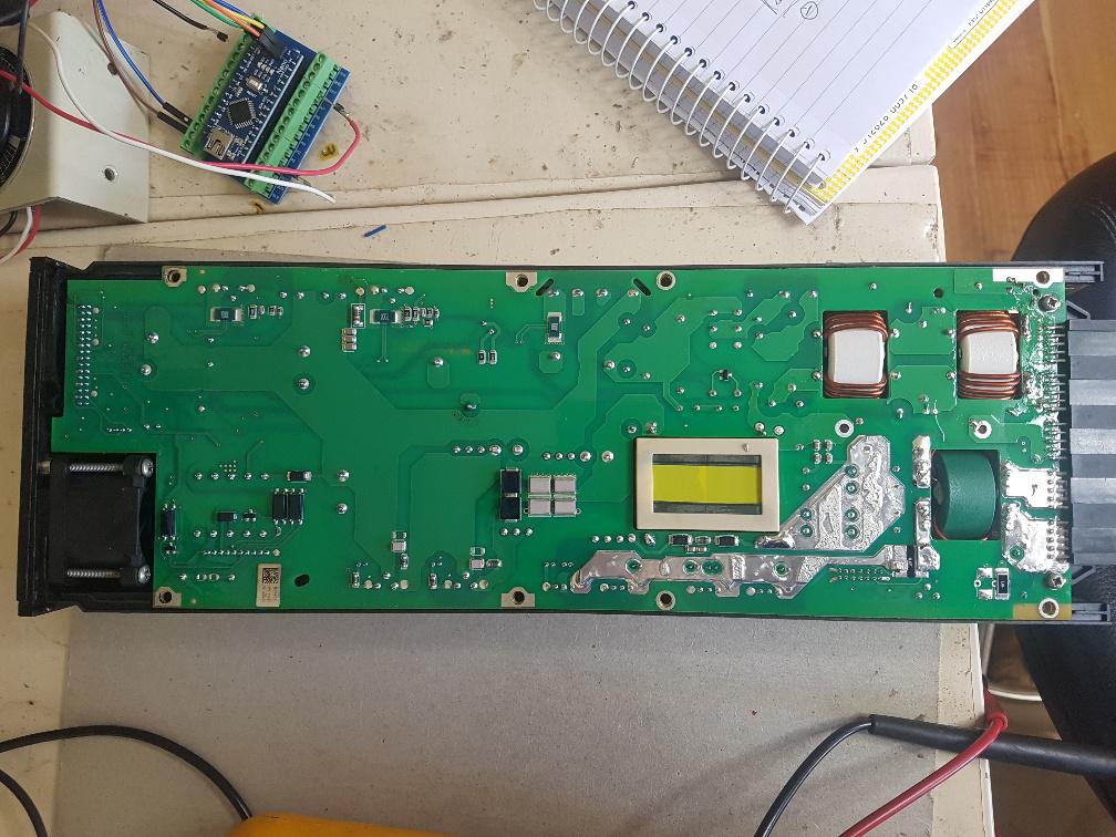

And in the spirit of the EEBLOG (waves to Dave!) I opened the cases up before
I turned them on.
First, the 48/2000 HE
next is the DC-DC converter

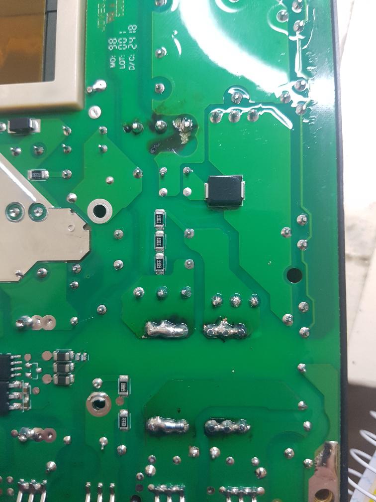

I think there was a repair made to it. Whether the repair was successful is an open question.
a closeup of the repair. I think things got very hot here.
Also, the PCB is 4 layer to my eyes.
All the soldering looks as new, except on the 2 common mode choke terminals
and the very average reworked 3 terminal device. Things got hot there and I doubt
it got hot during soldering. 99% Tin solder is used throughout so the rework temps
will be high...
This area corresponds to the multiple fuse array protecting the output.
There are 2 x 3 fuses in parallel under the black plastic box. I wonder if some are blown.
Anyway, it only owes me $50 so I will not worry too much.

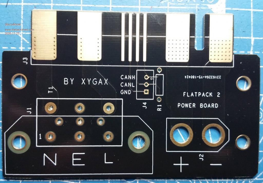

I just received my Flatpack2 48/2000 HE,
What sort of connector did you come up with. I see one made with vero-board on the other forum and also some PCBs made to do the job.
Gerry
F4 H7FotSF4xGT
poida
Joined: 02/02/2017
Posts: 1507
Posted: 09:53am 23 Nov 2020
Wiseguy sent me a PCB connector.
The one shown in your post is probably the same sort of thing.
the 3 pins for canbus are sort of isolated.
When using them, the ground needs to be tied to output negative.
And the canbus transciever needs to terminate can-hi and can-low
with a resistor. There seems not to be any termination resistor within
the Eltek's canbus outputs.

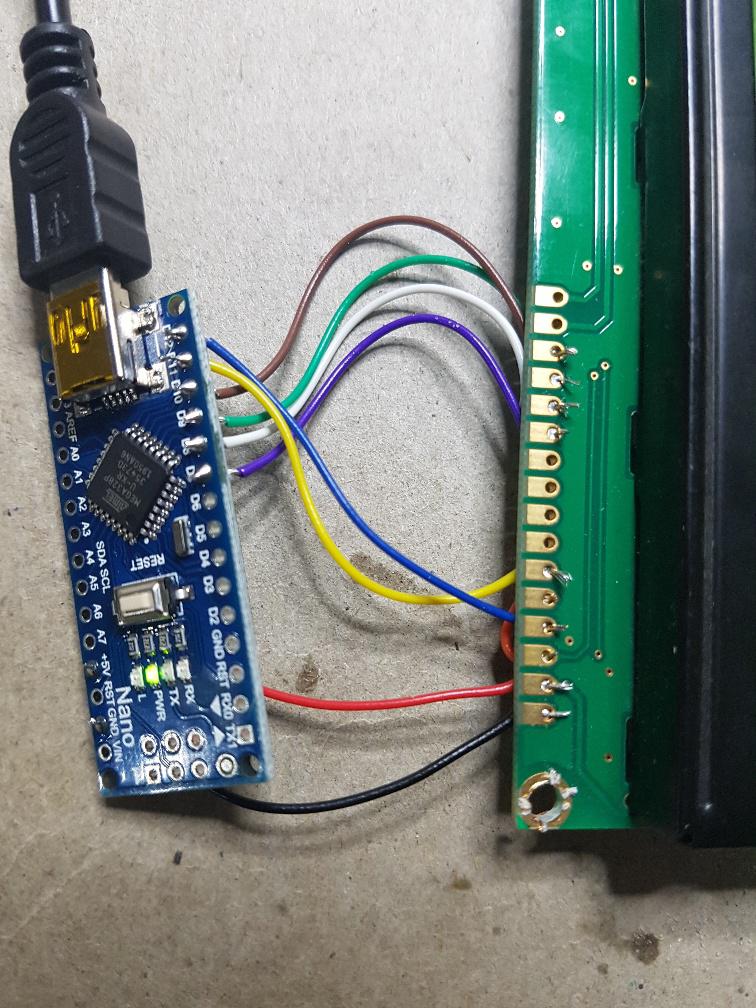

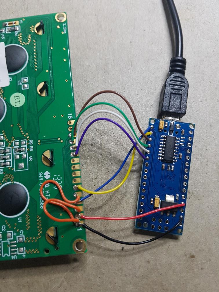

Added an LCD now.
Need to add CV/CC mode switching and some warning and error messages.
These may include:
3 High Mains
4 Low Mains
5 High Temp
6 Low Temp
7 Current Limit
The wiring for my serial LCD is easy to do, took me 10 minutes.
and on the other side..
poida

The PCBs arrived from Wiseguy.
This means it's time to parallel 2 Eltek Flatpack 2kW 48V supplies.
The first test is CV, that is, I set the output voltage and let the current go where it pleases.
The load is a modified mppt dc-dc converter that presents zero current load at
45V and max load at 56.7V input. This makes for about 2500W total load on the converter's output, rapidly bringing the water cooled resistor to a boil.

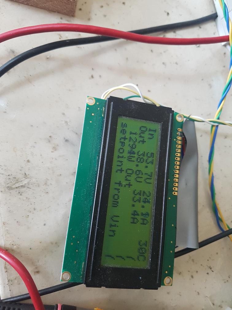

pics or it didn't happen, right?
This shows the 2 Elteks and their output voltages and currents.
The setpoint is in volts and is used to program both Elteks to output that
voltage.
The display shows
Eltek PS #1 reports 53.9V and 12.1A on the output
Eltek PS #2 reports 54.0V and 12.3A
The canbus wiring has both Elteks parallel their can-high, can-low and can-ground
pins, which are then fed into the MCP2515 module.
Talking to one or the other PS is done with different canbus ID.
No need for two (or more!) MCP2515 modules. The canbus standard permits
multiple devices on the single bus.
This is the display from the dc-dc converter. It shows input voltage and current
as well as output information.
It shows 24Amps in at 53.7V
The two PSs are sharing the output.
How does it go dynamically?
Blue is setpoint voltage.
Read and Yellow are output voltages as reported by the PSs
Green and Purple are output currents as reported by the PSs
There are clearly differences in the closed loop control performance
when tracking a voltage setpoint. This will not be able to be remedied
since it's a function of Eltek firmware.
But to me it looks fine. What is a couple of Amps difference in output
going to matter?
There are good reasons why they do not track in lockstep perfection.
1 - different DC output lead lengths
2 - different calibration from PS to PS, factory set calibration too.
3 - possibly a difference in firmware revision yielding altered PID performance.
