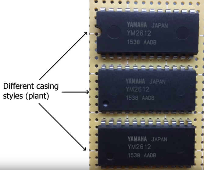

I have no problem with recycling - we should all be doing it, but this vid shows the scale of counterfeiting that goes on where components are recovered from old kit, "recycled" and sold as new stock... in itself that is bad enough but the chips often receive an upgrade in the process and often times they don't even care about the chip so long as its got the right package and pins... You want a 6116 2Kx8 static RAM? You could end up with a 16 channel analogue multiplexer in the same package badged up to look like a 6116.
Check this still from the vid:
three IC's. Identical part number, identical date code, identical batch - DIFFERENT CASINGS this absolutely cannot happen! and the sellers don't care they want your $$$ and will stoop to any cheat necessary to get them.
I know it's not a new phenomenon but it never occurred that a 6116 might be a 4534. You might get lucky and get what you want but new $ for old? and maybe "upcycled" to mil-spec or different speed rating? cheeky basts!
"enjoy" https://youtu.be/k72SFBOZ_lw

Very interesting link, confirming that this sort of thing does indeed happen.

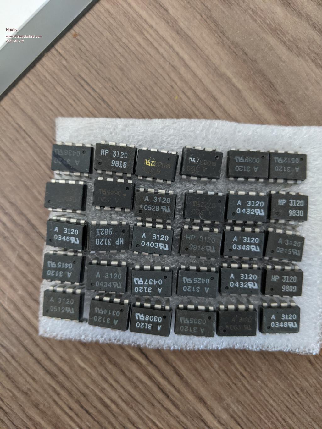

I have never bought chips from dodgy sources till yesterday actually! Always from Digi-Key, rs, mouser,element14.... We will see what comes in the mail in 3 months time.
when you are trying to get a new design going, you don't want that extra unknown variable in your bug fixing stage.
And if you want the design to work reliably over a long time, you just can't be questioning the quality of the components. Especially electrolytic capacitors and power components.
Now in the last week, as I contemplated building a 3 phase warpverter, I thought that since it will be just for fun and I won't be relying on it, won't be selling it, well, might as well try out cheaper components from AliExpress. Also I don't have a deadline to get something going, so waiting 3 months for some crap to arrive isn't going to annoy me too much.
Well the prices are good..... A tenth of the price of Digi-Key. But I'll be checking every component before it gets soldered, that's for sure.
I bought 60 X hcpl3120 opto drivers at $2.18 per 10 pack! The RS price is $2.90 just for one of the suckers!
Same for IGBTs and MOSFETs.
I still can't bring myself to buy electrolytics from anywhere but the quality places. Even for this hobby project. I've seen too many dry out and fail.

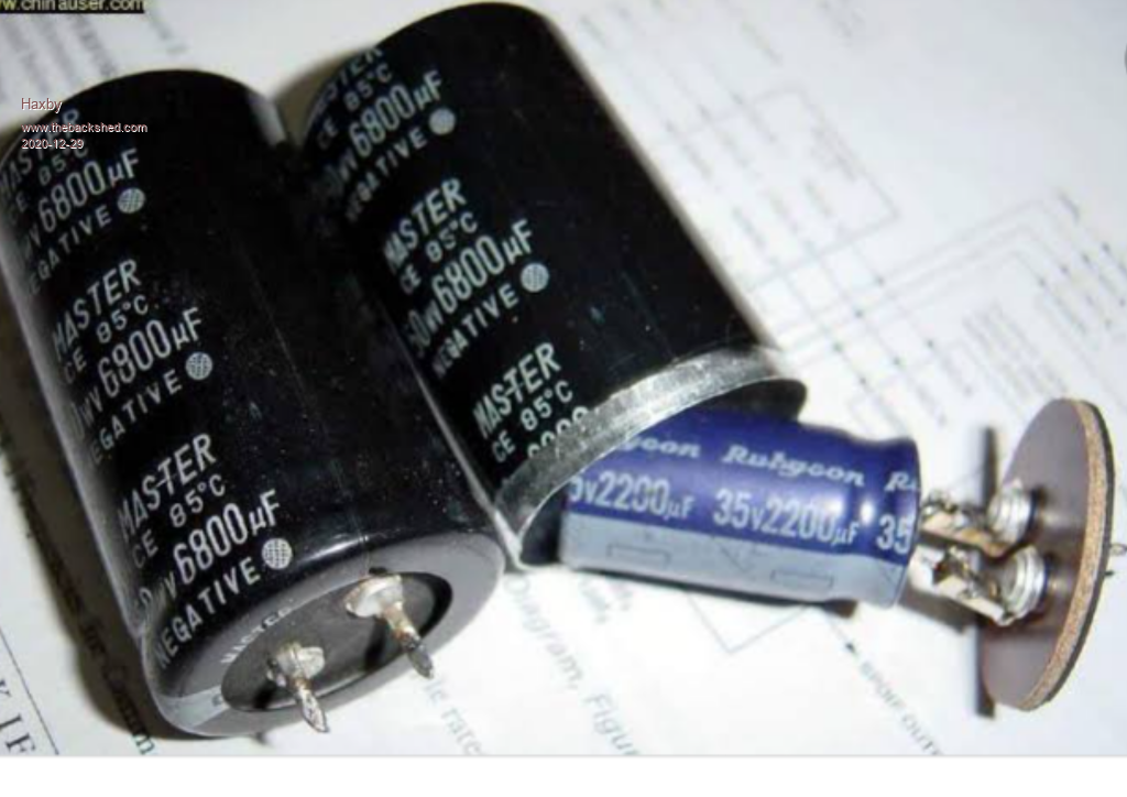

Reminds me of this gem:

    The dirty basts!  Anything for a buck.
