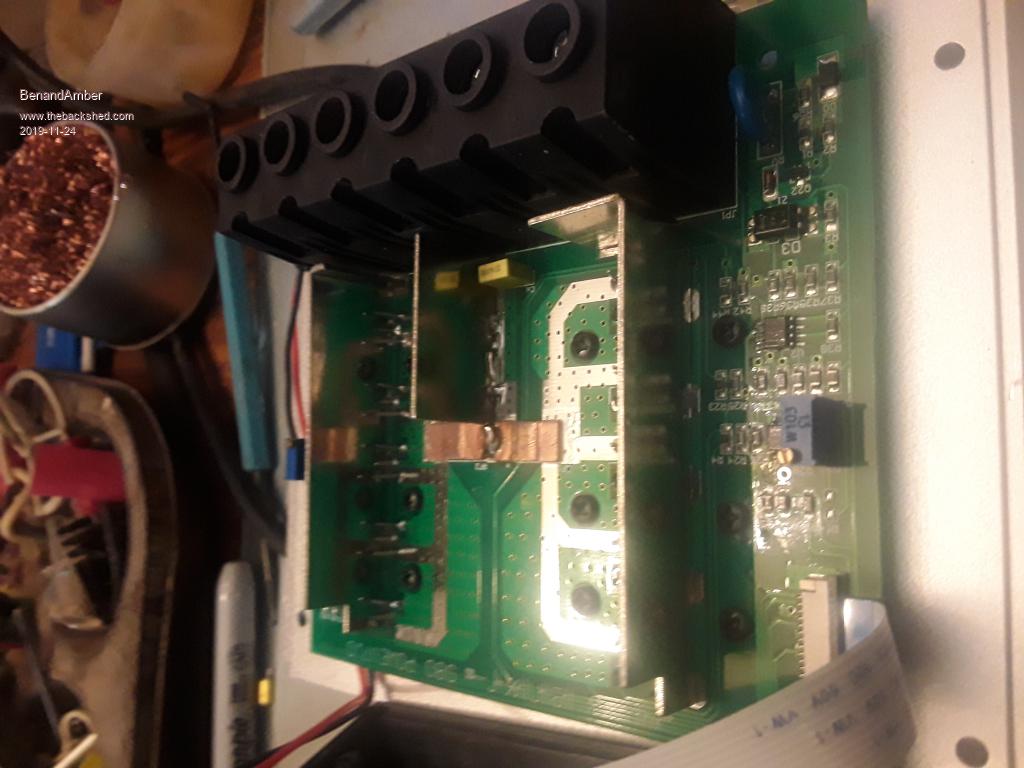

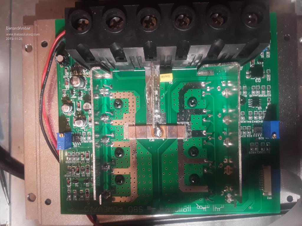

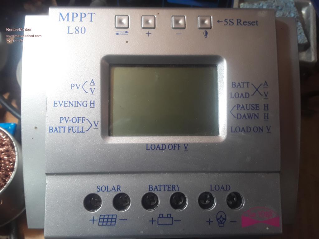

Curiosity got the best of me
I just had to take it apart
So all of you experts can pick it apart lol

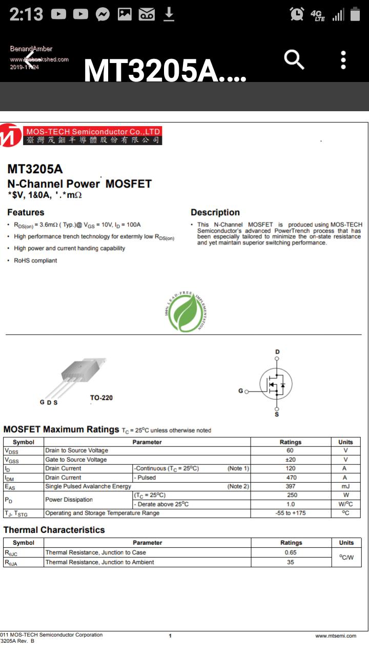

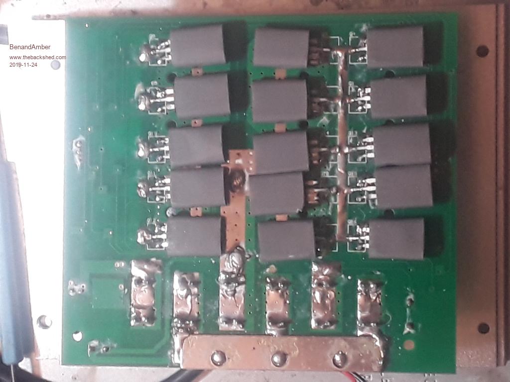

All 15 mosfets are the same mt3205a
BenandAmber
Joined: 16/02/2019
Posts: 961
Posted: 07:41pm 23 Nov 2019
I purchased it off eBay it was on sale for around eighty bucks
I used it down at the bus for about a year
After that my buddy of mine used to it for about a year
The only real complaints I have are
not knowing the highest voltage solar panels that can be used
and it's a little bit complicated to program
I'm actually a little bit impressed with it
fake or not it doesn't really good job
Posted: 08:57pm 23 Nov 2019
The mosfets are rated for only 60v maximum, so that would probably be the highest open circuit panel voltage.
