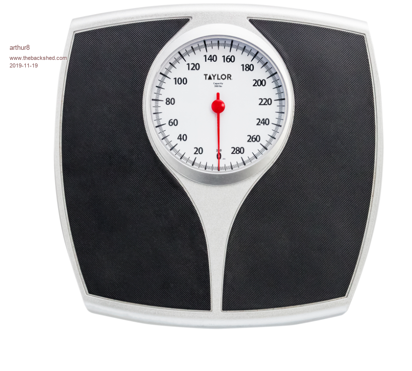

How much gas is left in a cylinder is easy.
Sit the cylinder on some bathroom scales. The cylinder will have stamped on it the weight empty, and the weight when full.

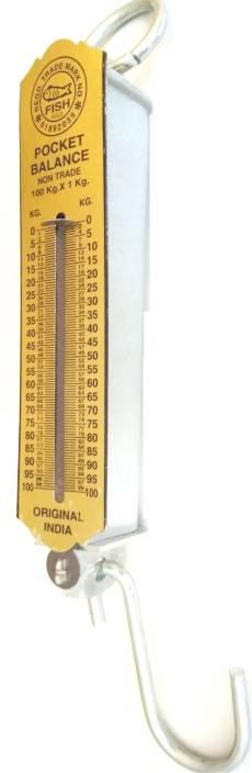

If you want some kind of warning when the gas gets low, a mechanical scale could be pretty easily adapted to do that.

The mechanical scale idea is very good, i will try to find any cheap one.

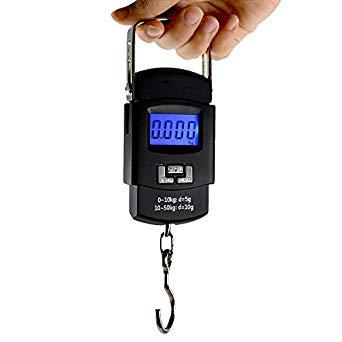

That e-bay strain gauge sensor will only output a few millivolts, its going to require a strain gauge amplifier to amplify up that signal up to something usable with an Arduino.
Another way to do it would be to hang the cylinder from a digital spring scale.

  Warpspeed said  That e-bay strain gauge sensor will only output a few millivolts, its going to require a strain gauge amplifier to amplify up that signal up to something usable with an Arduino.
That's bad. Still don't know a cheap & reliable way to import the Kg value on Arduino.
Maybe this?
I can put a small sensor on the gauge so i can have alarms when the GLP is low.

  renewableMark said  Awesome rig!!! Hell yeah, I'm jealous.
Caveman method to tell the LP level, pour hot water down the side of the tank, then put your hand on the tank and feel for the cold spot, it will be really obvious.
Once again, it's caveman style, not scientific, but it works.
Hey Mark. :-)
Sounds like a good idea, i like it and for sure will test this tomorrow.
But, i would love to get some alarm when the gas is running low.
Bad news is, i can't see any easy way to get the weight info on arduino. Just need some sensor that outputs any analog or digital value, so i can import it on arduino.
The ebay sensor i've been looking before looks too complicated for me.
Any suggestion on this?
