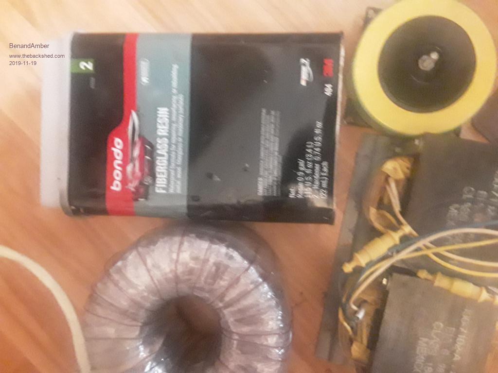

I use automotive clear fiberglass resin with the hardener that comes with it
I also use  fiberglass cloth along with it
I paid around 60 bucks for a gallon of it
I used it to epoxy Transformer core's together
I also use it over the wires on every layer
The chokes and Transformers I have made are completely silent
Although this has worked graet for me I would recommend you research it before you use it
I don't know the lifespan of the product and life expectancy with the heat of a transformer
I had already bought this for another project and had it on hand so I used it
I also used it after I epoxyed magnets on a rotor of a 3-phase motor
I would definitely recommend using the fiber glass cloth with it it gives it a lot more strength

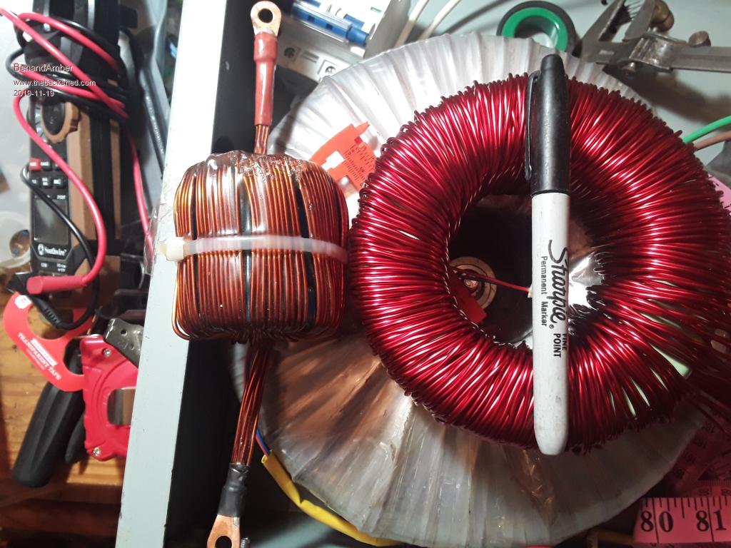

I epoxyed both of these chokes with this type of resin
Both are completely silent
The smaller one on the left shows you what they look like after being epoxied
The larger one on the right got epoxy before I used it in my big inverter
I do not use the fiberglass cloth when coating the wires
Only when bonding things together

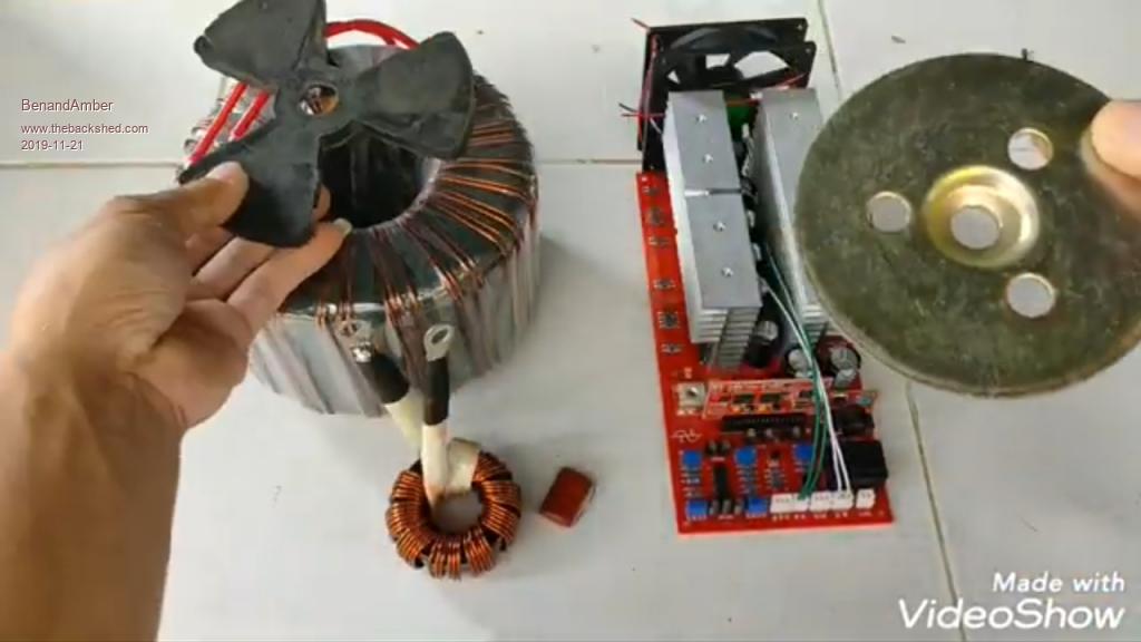

Seen this online thought it was a good idea
By the way after you fiberglass resin a Transformer I wouldn't think there would be any hope of getting it back apart
I honestly think you would be lucky to save the core
I haven't noticed any shrinking problems the one inverter has been running continuously for quite a few months now
But who knows a very legit concern

Thanks BenandAmber. The star shaped washer is what I had in mind  ...  3 or 4 fingers  ...  and cut the metal disc much the same. Will allow at least a bit more air through.
And then address the bottom in a similar fashion so can get some flow through. Will add more height to the assembly, but would be interesting to see how it compares temperature wise.
Regarding rewinding an already epoxied transformer  ...  I agree  ...  I think I'd cut my losses, hacksaw through the windings and start again.
When I used fibreglass resin to pot electronics, it was only about the size of a matchbox  ...  but the shrinkage was significant  ...  especially if I added more catalyst than I was supposed to! Having said that, with the amounts being used in the torroids, I wouldn't expect any issue at all  ...  besides I bet you're not the only one to have used it for this purpose and you all seem to have fared ok.
