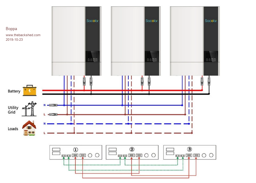

Don't even need to reconfigure the panels these days, there are quite a few offgrid inverters going the HV  panel voltage route
This is one example of these kind of inverters (can run as gridtie, gridtie with battery backup, or straight battery power)
MPPT ranges 120V~450V,  Voc 500V
Input / Output Voltage DC 48V / AC 220V~240V
Plus you can parallel them as well to get more capacity
Not recommending this particular brand or anything, just that they are certainly out there...

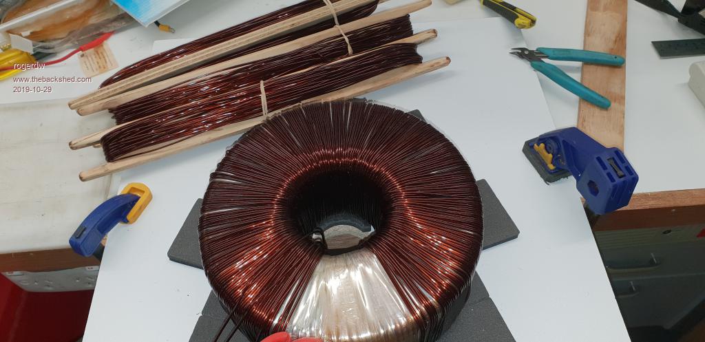

If you plan to build an inverter yourself, how experienced at electronics are you?
It's not an easy job to build one, even Poida and Madness have had multiple blow ups, I have had a lot more than most due to my lack of experience.
If you plan to build one you'll need 2x 3kw torroids to start with and they are like hens teeth these days.
Making the transformer is a pain in the ass itself.
If you can't find suitable torroids to rewind you'll need to get a transformer made, probably $2k maybe more.... dunno.
