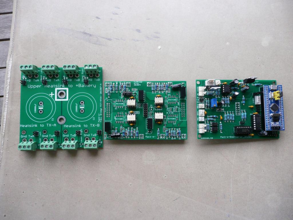

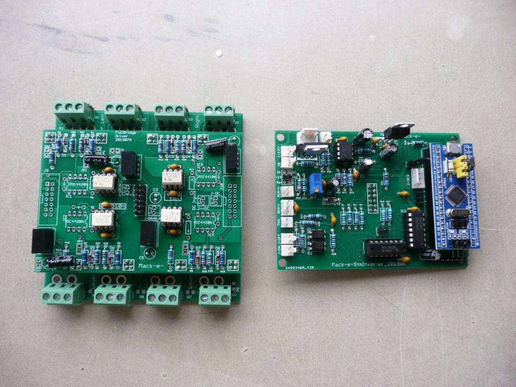

These are the Boards I'm using.

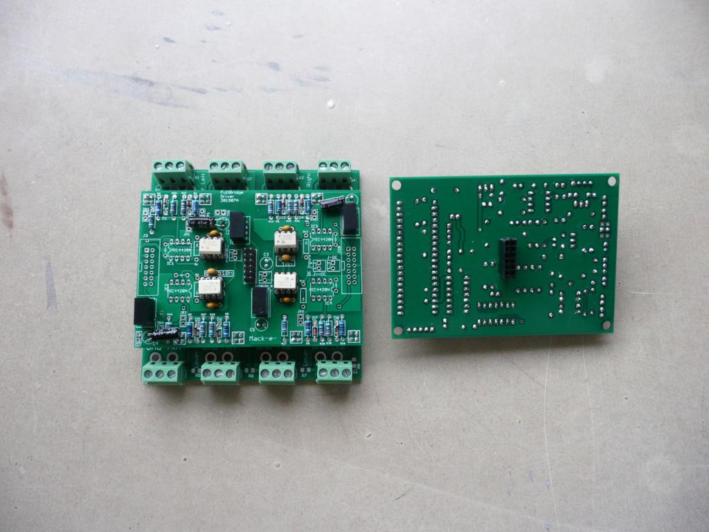

Driver Board plugged onto the Mosfet PCB.
Showing the underside of the STM32 micro board - how it plugs onto the driver board.

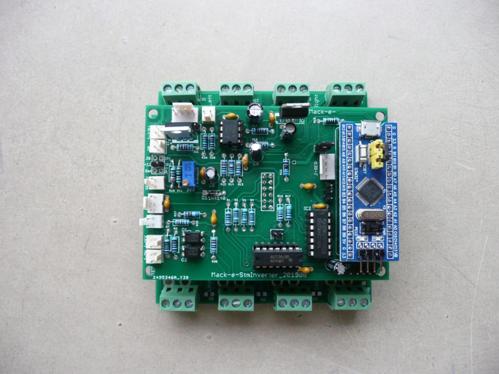

All plugged in.

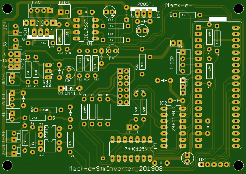

STM32 controller
The STM32 board was designed to be able to work this combination of boards as a full SPWM inverter should I want to.  To add power just add more Mosfet boards as can be seen with Marks warpverter project.  It just so happens with this project that a square wave output is all that is needed.  The controller has all the usual features, battery voltage, Battery Current, Thermistor, Fan control, ON - OFF, Bi-LED, additional analogue inputs available on headers.

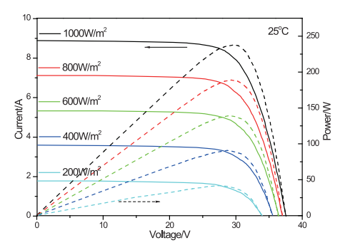

Posted: 07:00am 28 Aug 2019
I did some tests a few months back with a panel with Pmax rated at 32v.
I found power fell by roughly 10% at 26v and 36v.
If rated Pmax is 30v, then my guess would be 24v and 34v.
Power falls off much more steeply at the high voltage end.

Due to how my array is configured etc, I'm going to provide 12 CSUN-250W panels out of the array to supply the inverter.
Resources
 -  The HW element is a 1800W element.
 -  3000 Watts Solar at 1000W/m2
So irradiance drop to 333 W/m2 should still be able to provide my 1000 Watts I desire.
If irradiance drops to where Pmax is below 100 to 200 Watts I'm happy to call it and either stop inverting or not fussed about optimisation.
 -  It looks to me that (on the chart) Vpp @ 333 W/m2 is about 28 Volts ???
R(element) = (240^2)/1800 = 32 ohms
Vrms @ 1000W = sqrt(1000*32) = 178.9 Volts
My feeling for the minimum primary voltage is around the figure you're highlighting, 24 Volts.
So, turns ratio = 178.9 / 24 = 7.12
I could lower input ripple current by raising the primary closer to that 28V minus some voltage drops, or I could chase the MPPT level down to 20Volts, but 24V should do I would think.
