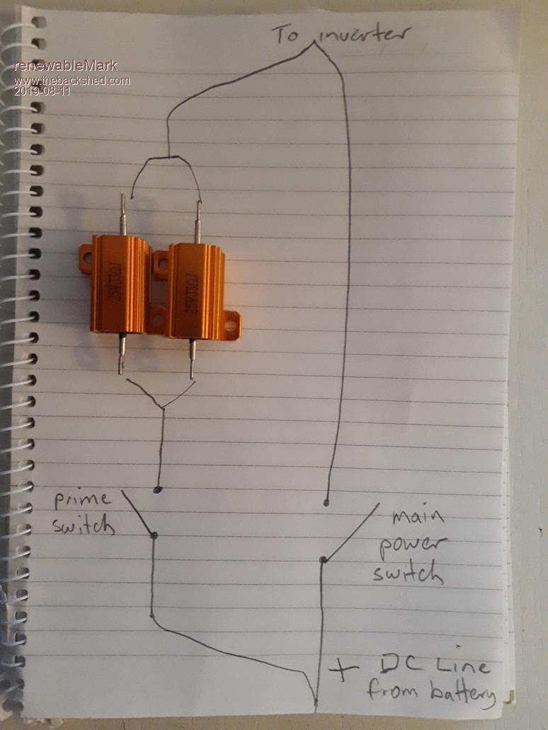

Ben, you can get the 33R finned resistors HERE
One way to wire them is like the drawing.
To start the inverter
1. Turn on the prime breaker, and leave for 30 seconds (to slowly charge up the caps).
2. Turn on the main DC supply breaker.
3. Turn off the prime breaker.
I just used the same style DC breakers for both and fitted them next to each other on the case, with a label on each one, and the start up procedure written on it.
Cheers Caveman Mark

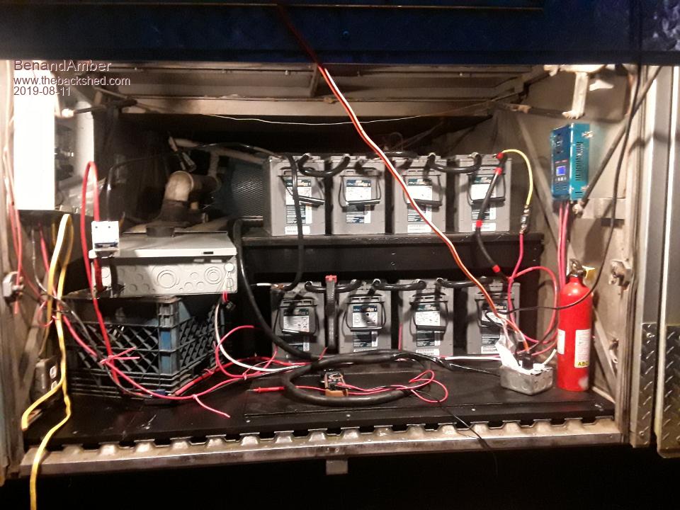

I will get a picture of how I have everything temporarily hooked up and uploaded here after bit

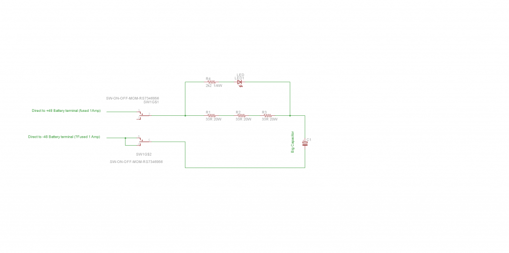

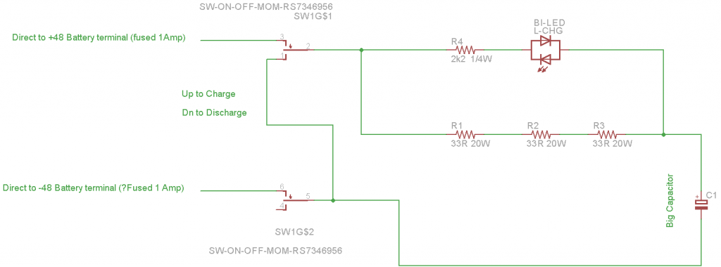

Ben, I've been meaning to do a little schematic snippet to show this.
I put the two 33R 20W resistors in series.
For 48v I'd use three of the above in series.
The simple way to use an LED is to have a LED in series with a 2k 1/4W resistor, this goes in parallel with the power resistor. The led will turn OFF when the Caps are fully charged.
The current to charge the caps this way is in the order of 0.5 Amp so wires and switches need only be light duty.

Awesome Mac do you care to do a little Doodle of the circuit you're talkin about
And another question is how do you guys get these giant wires in these little lugs of Breakers and such

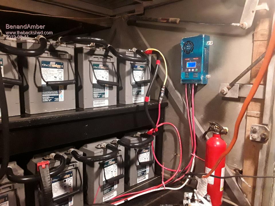

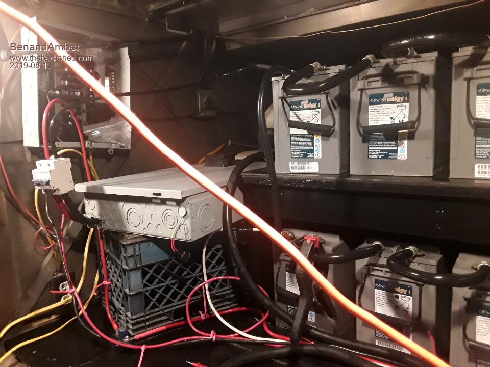

I have giant wire that's going to be going to the inverter when I hook it up permanently right now it just has a AWG 2 wire
That is a hundred amp breaker that's hooked up to it I hate that you can't hardly get big wire into it they make the lugs so small
It also has a hundred amp fuse you may be able to see it on the bottom right-hand side of the crate the inverter is setting on
I have AWG 6 wire going to the charge controllers it also has a fuse in between it and the battery Bank
The breaker box at the top left is for the input of the solar panels each breaker will be hooked up to 3 solar panels in series only have one for now
that large black wire going over the inverter has one of those giant RV 220 plugs on it
it plugs right into the side of my inverter
that wire will be going to the bus breaker box instead of those two receptacles when I'm all done
I can unplug the inverter and plug into Shore power if I ever need to no way of messing that up both cannot be plugged in same time because they use the same plug going to the breaker box
The Big sure power wire is like a giant extension cord female on one side and male on the other
I'm still debating whether to have the charge controllers and the inverter up in the bus or keep them down in the bottom
I think I'm for sure going to put the solar panel breaker box up in the bus alongside of the regular breaker box
All comments and ideals are very welcome

Simple charge circuit, switch and wiring see less than 1 Amp.
This circuit Charge and discharge, which is why you need a Bi-direction led.

You're awesome thanks for the help for me and everyone else needs extra help 2 get it
the more I look at it the more I like it I think I'll build this on a little circuit board and add it to all of my inverters
So simple but so elegant

Posted: 03:56am 11 Aug 2019
That switch is from RS-spares, the part number is on the schematic. I don't know if RS is available in the states.
It's a ON-OFF-Momentary, I use the momentary for discharge. It's not intended to leave it turned on but there is little consequence if you do.

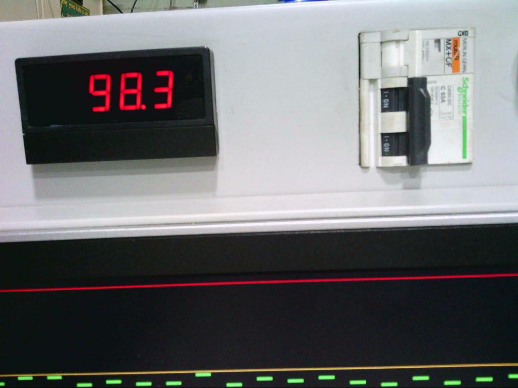

Posted: 06:18am 11 Aug 2019
Mark, I welded up a couple of circuit breakers before I figured all this out, so you are not alone.
What I do now, is push the button, and wait for the waveform on the little oscilloscope to come up, which takes several seconds.
I then know that everything is working perfectly, and I can close the battery circuit breaker, without any loud bangs or surprises, hahaha.
And then the main 230v ac circuit breaker on the inverter output.

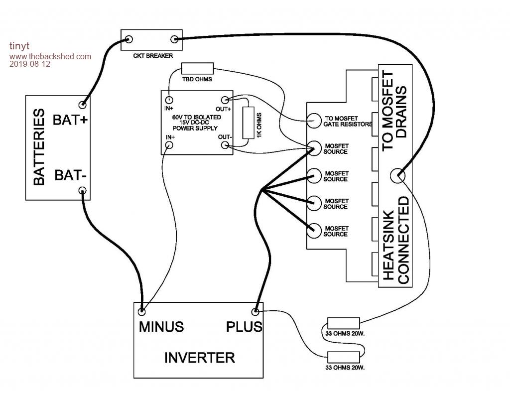

This is un-tested. It uses the following:
1. kentfield's pcb design you posted here
2. A 60V to 15V isolated DC-DC power supply.
3. The two 33 ohms 20 watts resistor.
4. A 1kohms 1/2 watt resistor.
5. A 1 watt tbd resistor (maybe from 100 to 300 ohms).
When the battery ckt breaker is turned on, the DC-DC converter waits for the inverter capacitors to reach sufficient voltage for it to build up to its 15V output. Then the Mosfets turn on, allowing full current to the inverter.
The 1K resistor allows fast discharge of the 15V when the ckt breaker turns off. Of course it also depends on the discharge of the inverter capacitors.
The tbd resistor creates further delay to the build up of the 15 output.
Edited 2019-08-12 04:22 by tinyt

That's something that I want to do, but controlled by a uC. Maybe the second Arduino nano from the Nanoverter has some pins left to be used. It's allready meassuring all that's needed I guess. Then the uC can deside if the charging time is normal, if not give fault.
Then anyone can put the inverter in to duty.
The only (small) issue is the powerloss when switching an AC contactor/relay. Most of them are using +-5W.

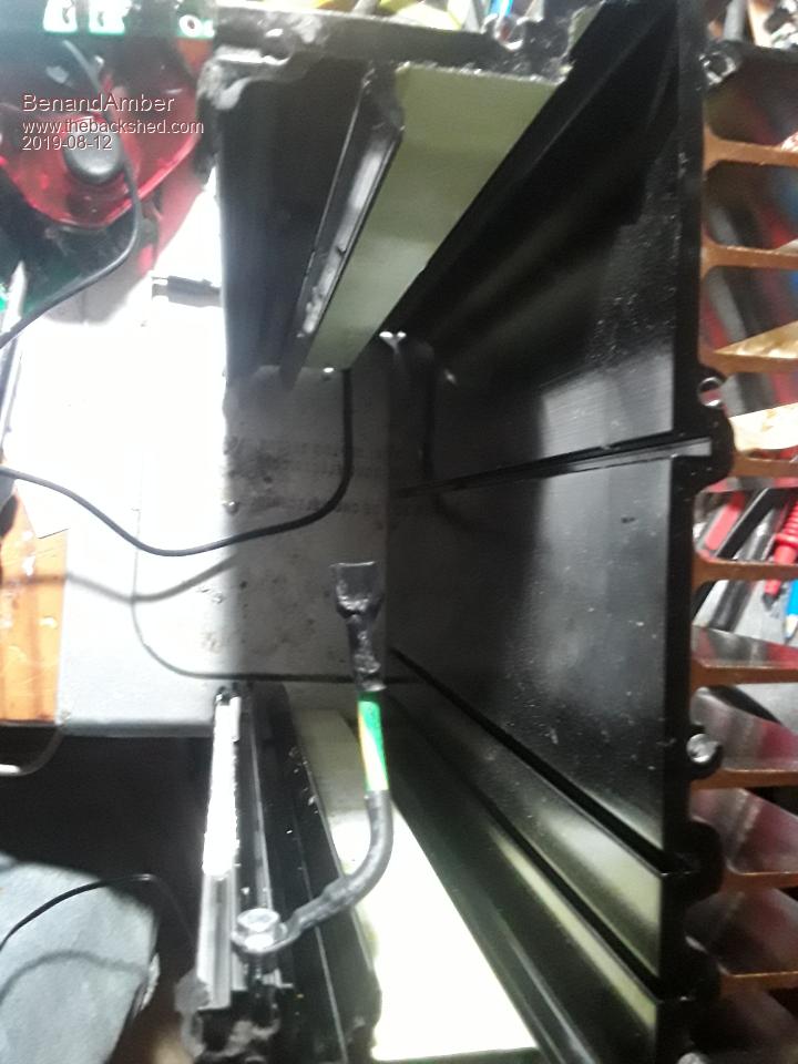

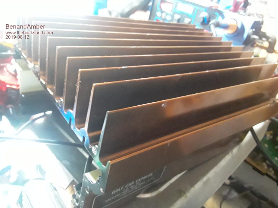

My buddy gave me a 36 volt golf cart charger that fell off the back of the truck going down the interstate
all of the Transformers on the inside where broke off the board
it didn't hurt the heatsink
I would like to use this Heat sync on the next thing I build

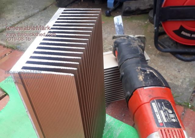

If it can't be used whole what are you guys cutting these aluminum heatsink with
renewableMark
Joined: 09/12/2017
Posts: 1679
Posted: 06:06am 15 Aug 2019
  BenandAmber said  ..................... what are you guys cutting these aluminum heatsink with
You can just use one of these reciprocating saws with a hacksaw metal type blade.
That does a pretty ugly job but it works fine and the inverter won't care.
Now I use a table saw with an aluminium blade.
You get nicer cuts and it's just easier if you have access to a table saw.
If you do it on a table saw beware of the blizzard of tiny filings that get flown EVERYWHERE. I put on full length overalls and use a welding mask (with the dark shade flipped up).
