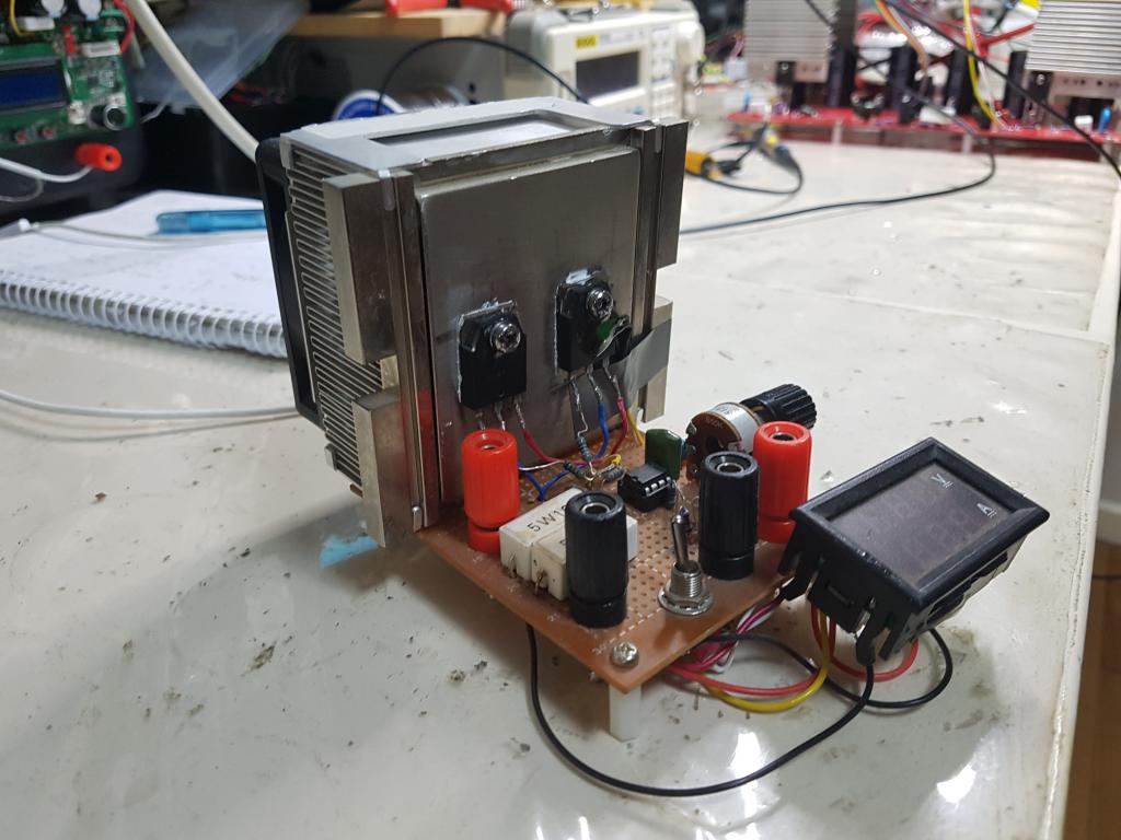

Oh yes, for sure.
I built a constant current DC load using some special mosfets.
I can control the current the device consumes with a potentiomer
from zero to about 8 Amps, and with voltages from about 4V to 50V.
Some MOSFETs are very good switches and others are more useful when used in the intermediate gate drive voltages, becoming the variable resistor.
The constant current device of mine is the latter.
In posts here on the forum I explored how easy it was to destroy the
switching optimised type MOSFETS by running them so that they are partly
switched on.
The HY4008 was very easy to kill in these tests.
The constant current thing I made uses NEC K3304 MOSFETS which are quite happy to
run at any gate voltage, producing large amounts of heat.
I drive the gates via an op-amp output such that the op-amp ensures the voltage drop
across the large resistors equals the voltage out of the potentiometer.
This way I have a current control. (this device has been invaluable in helping me
understand switching power supplies and inverter theory)
In the application of inverters and power conversion & control in general,
MOSFETS are always driven in such a way as to ensure they are either full ON or full OFF and to take as little time as possible when changing states.
When OFF the MOSFET consumes zero energy and when fully ON it also consumes
timy amounts of energy. It's the time spent going from one to the other state
where most of the heat is generated.

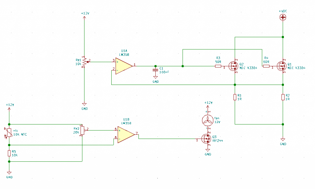

poida
Joined: 02/02/2017
Posts: 1507
Posted: 05:38am 07 Aug 2019
Mack:
two DC terminal pairs, one for 12V supply, one for the DC load.
I use the LM358 as a comparator to control the cooling fan.
And place the NTC on the heatsink, I put it on the top of one of the FETS
This is from memory. Probably only need 50R gate resistors, maybe a 100nF cap.
The power FETS are tricky. You can not use the usual power MOSFET such as HY4008.
They will be weak, and blow ever so quietly under low loads.
(about 1/5 of what you expect from the spec's safe operating area.
The NEC K3304 I salvaged from a dead plasma TV or something are very good for this.
No idea what else to use.
IGBTs were suggested.
I have had 150W continuous on this thing, peaks of 200W
10A at 20V is reasonable, 5A at 30V all day.
