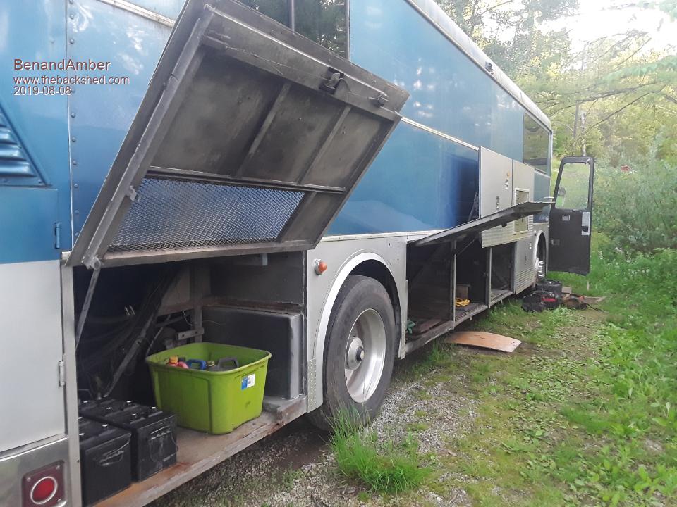

Yes there is giant compartments underneath there
so big I could put a washer and dryer in them
I have an Onan generator also have a second exhaust that goes all the way from the generator Bay to the back of the bus
Problem is I don't want to ever run a generator so I have used the generator Bay for my battery Bank
I took out the big giant stainless steel fuel tank for the generator and have redone that compartment and installed my batteries in it
Between the fuel tank and the generator you're probably looking at well over a thousand pounds and took up all kinds of space
I have a small power washer (without pump) that I will be putting some kind of generator on also I want a backup for my backup
on the back of the 6 V 92 supercharged and turbocharged Detroit Diesel there is a big spot on the right where in the Greyhound versions of this have a big air conditioner pump
there's already another belt space that would be used for the air conditioner pump on the same pulley as the hydraulic pump that goes to the hydraulic motor for the big radiator fan
So there is a big space there just begging to be used for a second alternator for the battery Bank
When I'm sitting still I'll be able to put my awning out and have another 2 to 3000 watts of solar and this will not be needed
When driving down the road I'm only going to have a little over 3000 watts of solar and I'm not sure if this will be enough to keep the air conditioning going in the bus without depleting my battery Bank
So even a thousand Watts alternator wood probably give me that extra little bit of wattage I need to run air conditioning going down the road
Sorry so long I will get a few pictures today when I go down to the bus pictures might describe it better then I can

I have 330watt solar panels 10 will fit on top the bus
can only use 9 of them 3 series connected
and parallel those sets of three gives me around 115 volts to my mppt charge controllers
I will have another set of 9 on my awning
so around 6,000 Watts when parked but only around 3,000 watch when driving down the road
The buses electrical system is 12 volts and I have two very large batteries hooked up to that it will only be used for starting and running the bus
All of the rest of us is 110 volts ac
Thanks to the good people on this form
I have a home built inverter with a 52-pound 5000 continuous watt Transformer the board that's in the inverter can do up to 10000 Watts continuous
The interior of the bus is 100% 110 volt electric
I am Universal HVAC certified and would be no problem for me to put a pump on the motor
I just didn't want to have a whole other system for just going down the road
