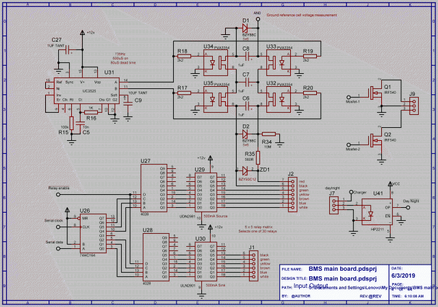

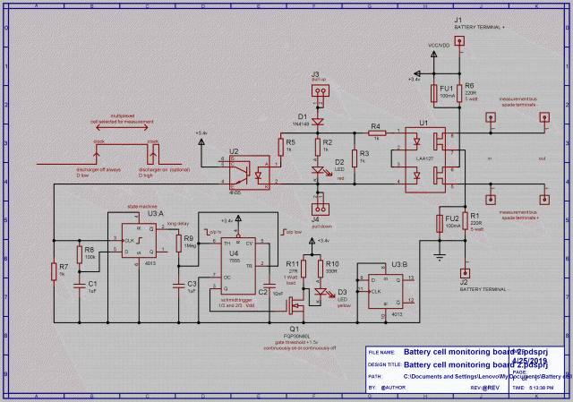

Ah..... This has been a very long ongoing saga, but here is the short version.
I have thirty series connected Winston 50Ah lithium cells that I wish to both monitor individually and balance individually. To get a consistently accurate comparison of individual cell voltages, a single floating voltmeter appears to be the only reliable way to do this.
That involves switching each cell sequentially onto a common 3v monitoring bus, to which a floating voltmeter is attached. The individual cells are stacked physically 6x5 which fits very nicely into a standard filing cabinet drawer.
To minimise the cell selection wiring, the individual cell monitoring boards are multiplexed into six columns and five rows. That only requires eleven wires to select any one of thirty cells for voltage measurement.
Each cell monitoring board originally had the usual cell balancing discharge load resistor and a voltage comparator (TL431) and a potentiometer for very fine calibration adjustment. It worked but I could never get all thirty cells to balance within the very few millivolts I was striving for, mainly because the thirty discharge loads could never all be set to work the same exact precise voltages.
So I needed a way to turn each of these discharge loads on and off individually by software based on the voltage measured by the common voltmeter. I really did not want to add more wiring to the cell monitoring boards, so I worked out a way to do it through the original multiplexer wiring without adding any more hardware to what was already there, except for the revised cell monitoring boards themselves.
The way the system works, a particular cell is selected for voltage measurement by sourcing +12v to a row, and sinking current to a particular column. This activated a couple of opto isolated analog switches to connect the selected cell to the common measurement bus.
A third opto isolator sends a logic signal to clock a D type flip flop.
Whenever a particular cell is selected, its flip flop gets clocked on the rising edge.
The data input to the flip flop comes from a long time constant RC integrator fed off the same opto isolator.
The result of this is, that every time a cell is accessed the flip flop turns off and would normally stay turned off because the D input has been low for a very long time while the other 29 cells are being measured.
While the selected cell is having its voltage measured, the integrator at the D input to the flip flop slowly rises logic high. If the multiplexing to the cell is quickly removed and replaced, the flip flop goes logic high, and stays high.
So I can quickly glitch the multiplexing on the trailing edge which turns on the flip flop. No glitch, the flip flop stays off. By that means I can control each cell discharging load with software not requiring any extra wiring or hardware at the BMS end of the system.
To prevent the discharge load from winking on and off every time a cell is being measured, I used another long time constant and a 7555 timer to control the discharge load. This switches very cleanly and at an accurate voltage theshold and provides a very nice 3v logic signal for the FET which switches the discharge load resistor.
Its quite a complex circuit for what it does, but it draws very little power and required no extra wiring from what was previously there.
I can now switch my balancing loads on and off individually with one bit resolution from the measurement voltmeter, knowing every cell will have exactly the same voltage balancing thresholds set by software. VERY happy with the improved cell balance this system produced.

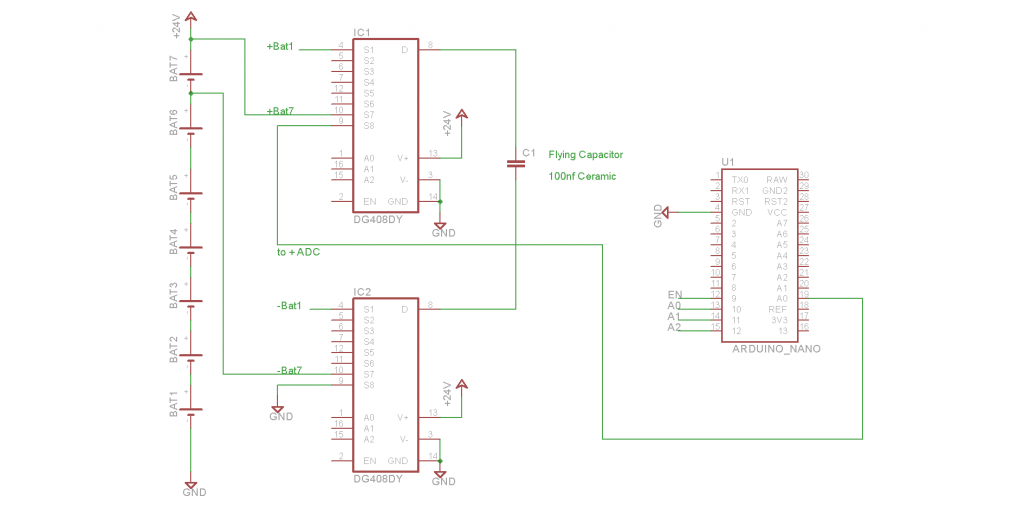

I'm thinking of trying the flying capacitor idea, but only in a small 7 cell array.
I don't need opto isolation and the DG408s will handle over 30V supply.  I can use Enable of the DG408s as a dead time and switch in up to 7 cells.  The DG408 does have an impedance of ~100R.
I can't quite read all of your schematic but my in-complete schematic is close in principle?
As there is heaps of time available to scan the batteries, inserting a 10k resistor from the + and - legs of the Flying cap wouldn't hurt?
Andrew
Posted: 07:42am 06 Sep 2019
Yes, that looks fine in principle.
Just select the required cell by enabling the appropriate input, wait for the flying capacitor to fully charge. Maybe at least five time constants. (20us ?)
Then connect the flying capacitor to the Nano, allowing sufficient dead time. And then read the voltage with the a/d converter.
Now you may need to fiddle with this a bit to get absolute optimum performance. Try different values of flying capacitor, if its too big it will be slow to charge, if its too small it may lose some charge through leakage and the switching process.
You may gain some accuracy and stability by fitting a second capacitor between the Nano a/d input and ground. It will then take several flying capacitor cycles to get that a/d input capacitor to charge up to the exact precise cell voltage, but there is plenty of time to do that.
You can check with a multimeter.  Measure the cell direct, then measure the voltage at the Nano, they should be identical. If its out by a millivolt or two, you can try a few things to get it right.
If the inverter is working really hard, there will likely be some significant 100Hz ripple voltage on the battery.
Another thing you can play with is averaging multiple a/d readings over a ten or twenty millisecond period. I take 256 readings over 20mS, add those together to get a sixteen bit result. The highest eight bits will be noise free and immune to 100Hz inverter ripple voltage, no one bit measurement ambiguity either.
With a bit of experimentation and stuffing around, its possible to get completely noise free cell voltage readings to one bit (millivolt) resolution that does not jump around from reading to reading.

Thanks Tony
As I said I haven't used a flying capacitor before and I just wanted to make sure I hadn't missed something.
All good ideas     The ADC capacitor is worth a try and the 256 sampling over the 20ms cycle is a good idea as well.
I hope to test this idea soon.  I'll let you know how I go.

Posted: 05:49pm 06 Sep 2019
That DG408 looks like the ideal device as it can work up to 44v single supply, and the control inputs are logic level shifted to suit, and are also compatible with 3v logic.
