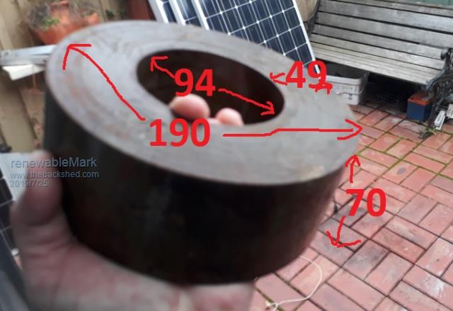

Hey guys,
my HF inverter in the van went pop so will build a small Mad power board run by the nano control board.
Highest load will be a small microwave, which is 1800w I think.
Would prefer not to have a start up procedure, just want to turn it on without the need to charge caps.
I have seen Poida's little bench one do that easily time and time again.
That unit has small caps on it though. Maybe it will need to have only 2 fitted?
Also the torroid will need to be wound differently to normal Ozinverters.
So blank canvas, any suggestions on how this should get wound?

So, I seem to remember the Ozinverter likes a nominal 16v primary for a battery voltage of 24v. ??
I would wonder if going for a low Flux density (1T at 16v) would result in a more reliable unit. Again ??
1T @ 16v
So I make that a turns ratio of 15
Np = 21 turns of 50mm2
Ns = 315 turns of 2.5mm2
1.4T @ 16v
Np = 15 turns of 50mm2
Ns = 225 turns of 2.5mm2
But I've never built a OzInverter so I'm probably wrong
Nice to see what others come up with.
Andrew
Posted: 02:17am 25 Jul 2019
Cross sectional area 49 x 70 = 34.3 cm sq
Using our trusty flux calculator
https://www.daycounter.com/Calculators/Max-Flux-Density-Calculator.phtml
230v
.00005 Mhz (four zeros)
300 turns
34.3 cm sq
Result 10,068 gauss (1.0068 Teslas in metric)
1800w = 230v x 7.8 amps
At 4amps per mm sq, we need 1.96mm sq wire
1.6mm diameter wire = 2.0mm sq, so 300 turns of that for our secondary.
Hole diameter 94mm circumference about 295mm
In theory 184 turns on first layer and 178 on second layer.
Should be possible to fit on 300 turns if you do two full laps of the core.
Primary would be 18 or 19 turns of 32mm sq, giving a ratio of about 16:1 which should work down to about 20v dc or so.
Posted: 02:28am 25 Jul 2019
Yup,
You beat me to the draw Andrew.
Slight differences I designed for 230v you for 240v
Primary turns depend on how low you plan to push your battery voltage.
Andrew prefers 1.8mm wire which is going to be better, and it should also fit better with two laps around the core.
Thicker primary would be better to, if it will fit.

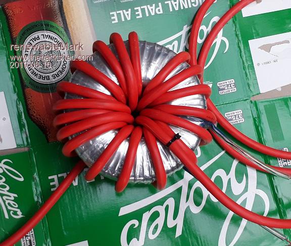

Well that makes it easy with just one secondary, I'll have to mylar the crap out of it before overlapping.

It ended up using 1.8mm diameter, that's 2.5mm2, so good for 10amps.
That will be way more than enough as the van usually runs some CFL's and a small tv, occasional micro.
Thankfully it has a gas oven and cooktop and heating is with a diesel unit, so it will get a very easy life.
300 secondary windings and 19 primary

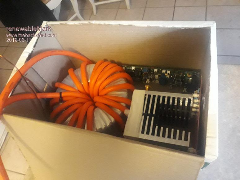

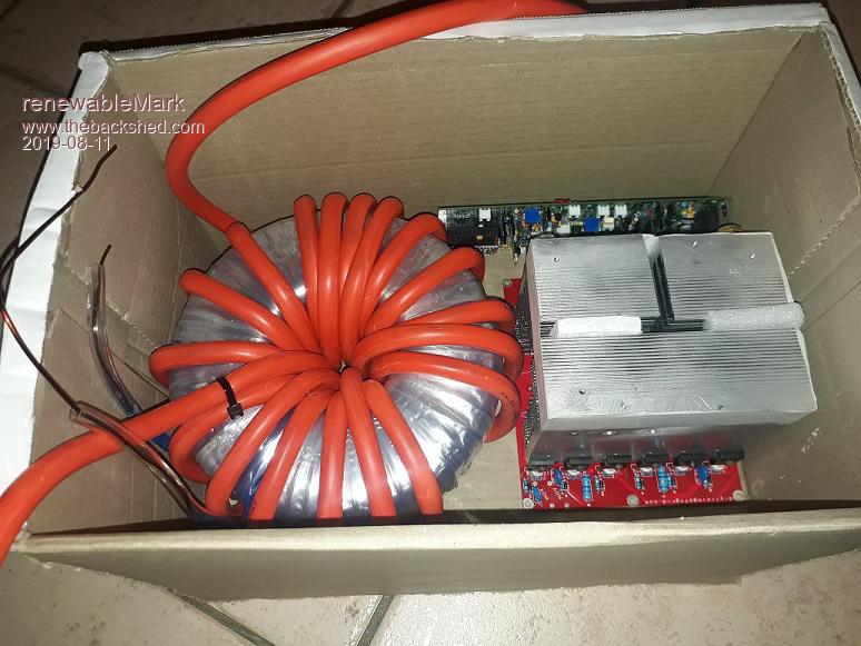

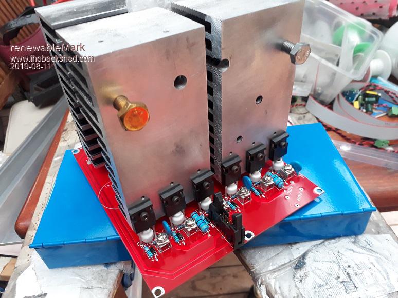

Trying to work out a layout, this thing is still going to be quite a big size, way bigger than the high frequency unit it's replacing.
There is a shelf under the kitchen bench where the other one was and the wiring and two batteries are. Hopefully it can squeeze in there.
Considering it will normally be loaded with 100-200 watts and run 1800 watts for microwave (and it doesn't always get used on a trip anyway) I was thinking the flat version of heatsinks like this.
Under 99% of loads it will cop max 200w so this should be just fine.
Temp sensors and push pull fans would be fitted to the left and right of the case. No natural convection, but with such small loads it shouldn't matter hey?
Next layout would be the more normal way to layout the heatsinks, but they will need a hole cut in the shelf to run a fan from underneath.
This also increases the overall height of the unit.
BTW I was just mocking it up in a beer box, it's not going to actually get fitted in one.
This was going to get some 10,000uf 100v caps that are already on hand, but since this is 24v it could use 35v caps correct?
So then it could run 47,000uf caps that would still fit in nicely and not cost a lot.
Edited 2019-08-11 21:02 by renewableMark
Cheers Caveman Mark
Off grid eastern Melb

Posted: 11:55am 11 Aug 2019
Caps sound ok.
I wouldn't worry about orientation to much from a cooling perspective. At an average of a couple of hundred watts, and those heatsinks, the fans will only come on when you run your uwave.
Andrew

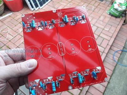

Posted: 02:56pm 11 Aug 2019
That looks awesome mark almost a work of art
I really like that small board
I'm going to try to build a new small board design this winter hopefully if I can get this Nano programming down

Thanks Ben, it's a really good size actually, and at 4kw constant it's probably more than enough for a lot of homes.
This one is 24v though and will only be rated to 2kw constant.
Now it's a work of art.

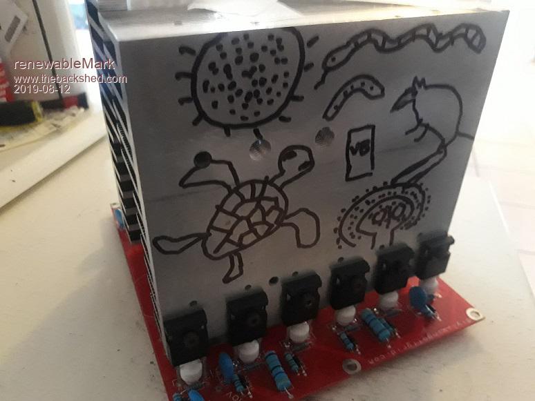

Posted: 10:29pm 11 Aug 2019
It truly is
you even doodle good what can you not do
How wide is that board I have a unique heatsink I would like to use
Edited 2019-08-12 08:31 by BenandAmber
renewableMark
Joined: 09/12/2017
Posts: 1679
Posted: 10:33pm 11 Aug 2019
6 inches by 7 inches
Or 150mm by 177mm
The actual heatsinks are 140mm wide for the single big one and the 2 smaller ones are 65mm wide. You can of course hang them over the sides more if you want. This one got done as compact as it could.
BTW Ben I was just clowning around with the "art" pictures on the inverter.
I wonder if the wanjina or the sacred VB can will protect it from blowing up.
Edited 2019-08-12 17:33 by renewableMark
