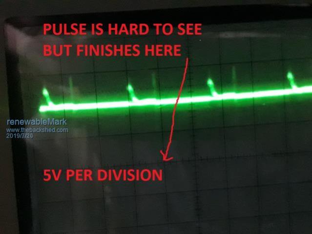

Ben, you may have been a tad confused about what I referred to when cautioning you about buss bars.
Myself and John here have both experienced issues when connecting the inverter AND solar charge controller output to a buss bar that were too far away from the battery.
Both of us changed our wiring to have the solar charge input direct to the battery terminals and all our problems went away.
I can't remember how far John's buss bar was from his battery, but mine was around 60cm, it was connected with 90mm2 copper.
I know Mad has a similar setup, but he uses a GTI to back charge a lot of his power and 5kw or so of DC input to a similar buss bar and distance from the battery.
From what I have seen exceeding 8kw of DC into a buss bar of a distance of 60cm or more away from the battery will cause problems.
These are just my and John's experiences.
Everything I have done is with copper btw, last thing I want to do is introduce another variable.
So use buss bars if you want to (for discharge), but when charging (with solar) I have found it's best to connect that charge feed direct to the battery.

  mackoffgrid said
I don't use a PWM charge controller, but I would have thought a buss bar ought to be fine unless it's not filtered , then you have a problem of injecting lots of noise - totally possible.
Exactly.
I probed my DC input line at the inverter power board and saw those pulses.
Moved connection to the battery and it didn't disappear, but it's very minimal now.
So it's not really about the buss bar, it's more about what you put INTO it.Edited by renewableMark 2019-07-21

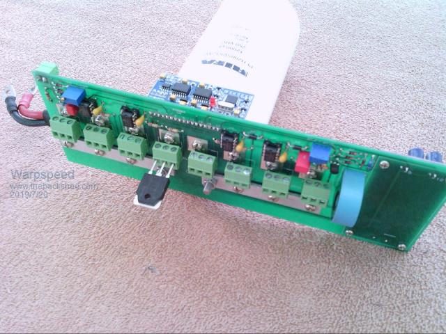

I like to use busbars inside equipment, they are an excellent way to tie many different points together with very low voltage drops, and the busbars can also sometimes provide useful mechanical support.
Heavy wiring between pieces of equipment is less of a problem where there is enough length to provide some flexibility.
Very short heavy wiring inside equipment can be very stiff and place great mechanical strain on some parts, without providing any useful mechanical support.
If you can bolt things such as current shunts, large electrolytic capacitors, and heat sinks directly onto busbars, it can be made very neat and compact, and very efficient.
Busbars bolted directly on top (or underneath) circuit boards can provide a very effective current path between multiple high current mosfets if the whole thing is planned right.

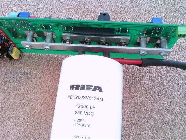

This is the last PWM inverter I made using a Chinese EGS board.
Negative bus bar on the left connecting to all the mosfet sources, positive busbar on the right connecting to all the mosfet drains.
If I was going to build a low voltage Warpverter using multiple HY4008s, instead of individual high voltage IGBT blocks, this would be the basis of how I would probably go about it.
This is the other ac side, where the drains and sources of one side of the bridge pass over the top of the drains and sources on the other side of the bridge.
It makes a fairly compact package, and it would be capable of carrying enormous fault currents without blowing the tracks off the board if it ever does go bang.

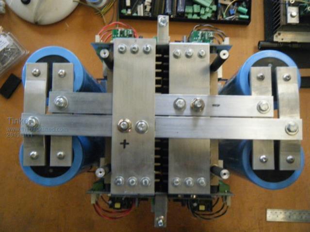

Klaus it the unchallenged busbar King with his modular Warpverter.
Well worth studying exactly how he did it.
