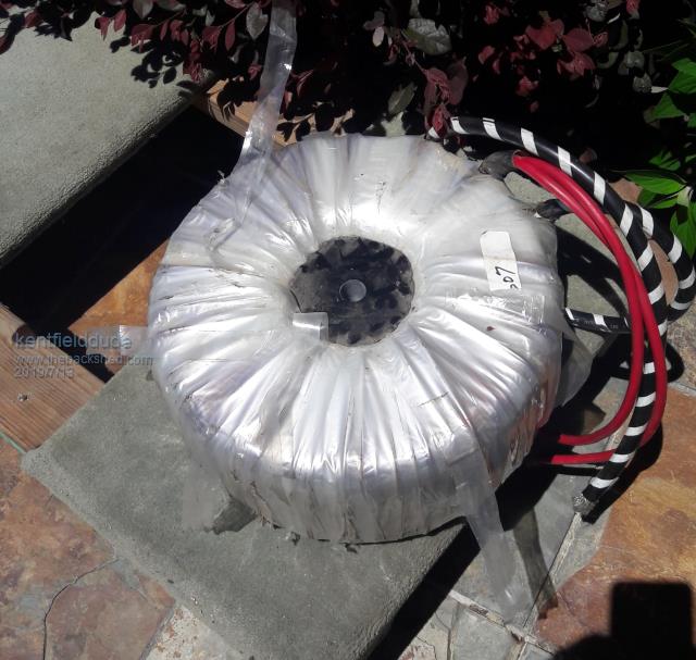

This is going to be my first inverter build. I'm going big or going home. I want to have 220v and 120v output on the toroid. I please need some help with the calculations for modifying/rewinding the toroid. I have the datasheet for the toroid but not for the core.

As it is now, no load current (at 240v) is 505mA or 121 watts.
That is is 2.9 Kwh per day loss just in idling power.
What are you trying to do exactly ?

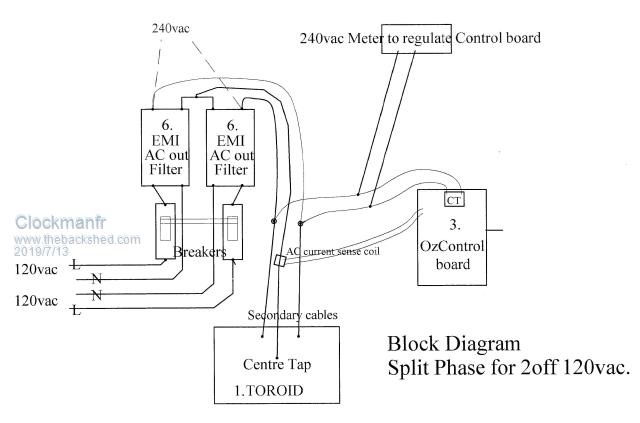

I want to make an inverter to power my house. So I need two 120v legs with a neutral so I can get 220v and 110v
Do you think I can rewind it to get lower losses?Edited by kentfielddude 2019-07-14

I have built 8kW Ozinverters where the toroid is about 32Kg of bare core and fully wound toroid at about 50Kg.
6kW running and your bare core wants to be about 18kg to 22kg. Its all about mass in the core for long term power pulling, that's if your batteries can handle that drain.
After many years of running, I do not recommend the 8kW as the 6kW can cope with everything I throw at it. As Warpspeed says the bigger the core the more power from your batteries is wasted just idling away. In general 20w to 35w for the 6kW Ozinverter and 40w to 80w for the my 8kW OzInverter.
Above a 8kW toroid the weights become serious and assistance is required just to turn the toroid with out damaging it, enamel/insulation, mylar, joints etc.

Below block diagram of a split phase for 120vac and 120vac. please ensure that your breaker is linked and shuts down the other breaker at the same time.

Yes you possibly can.
Lowering the flux density will reduce idling losses, but it requires more turns to do that.
If it was just for 220v only, adding some extra turns to the secondary would be fairly easy. But you will require an exact centre tap for 110v/110v.
That requires a complete removal of the secondary so a known number of turns tapped in the middle can be wound back on.
How easy that is going to be, depends on how it has been wound. If the secondary is one single winding of massively thick wire its going to be a real problem. If there are multiple thinner strands wound in parallel it will be much easier, and the extra total wire length will be an advantage.

Hmm. Well I'm not sure what to do anymore. This is the only toroid I have. Maybe 120w idle is okay if I have massive battery bank and lots of solar.
Posted: 07:05am 13 Jul 2019
Well you can always build your inverter and revisit the toroid question later on.

He got a really good deal on that toroid he got it cheaper than what you could get a smaller one
He could always make the Transformer a little bit smaller if he wanted to
He's going to have to rewind it anyway so he can make it any size he wants
The Transformer is a massive hundred and forty-four lb he really has to Transformers there
And used solar panels are 20 or $25 a piece where he lives
And he also can do like warp speed says to do to I think it lower the Tesla by rapping more Turns on it
And I would guarantee you that the metal core of that Transformer is the best metal you can get
I have been eyeballing that exact same transformer for a year-and-a-half
I even offered the people twice as much as what he paid for it before I came across the 52-pound one I'm using now
The people would never respond to me
In my opinion he's very lucky and he can either have two very big transformers
3 good size ones or
one gigantic one
and have to buy an extra battery extra solar panel to make up for losses
He is a engineering student and this is hands-on experience for him
I think it's just wonderful I think he will come up with something fantastic
It is the people just like him that is the future of this world we live in
I have three young boys that will be living in the same world so I'm going to cheer him on all the way
There is so much wisdom on this form that he could learn from
there is some of the world's greats on here and this is exactly where that young man needs to beEdited by BenandAmber 2019-07-15

John, I read that as just being for the eighteen inch long tails.
The actual windings themselves may be multiple strands, the way most of the grid tie inverters toroids are wound.
What I am thinking, is that the secondary may be for instance four strands.
That could be rewound as three strands with 33% extra turns with a centre tap using the original wire.
That would create the extra turns without taking up any more space on the core.
Max continuous rated power would reduce to 3/4, but 7.5Kw continuous is still a lot.
As Clockman says, it will easily do multiples of 7.5Kw for short bursts.
As it now is, the idling current is supposed to be 504mA.
Try running it at 3/4 of that voltage (180v) off a variac, and see by how much the idling current falls. I would expect it might drop to one half or even less.
The massive turn on current surge will greatly reduce as well.Edited by Warpspeed 2019-07-15

I'll take off the outer Mylar and upload some more pictures
