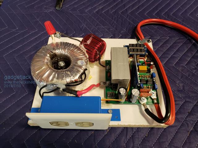

Here is the same board wired up for a 600-700 watt inverter , but at 24vdc.
Ben is correct. It is a very tough little board.

gadgetjack - thank you for the nice picture. If we break it down to components:
1. on the left you have the toroidal transformer
2. in the middle you have a choke
3. on the right you have the brains and control board. The ESG002 (which I call "brains") is standing up vertically alongside the heatsink
4. offscreen you have the power source
I. Is that correct?
II. If so, where does control board come from?
III. Can the control board be modified to input 120V DC?

LADYN
1. yes that is correct.
2. Ebay
3. It is a stock board , you order for 12,24,48v input.
No modes to the EGS002 other than to make it 60HZ.
