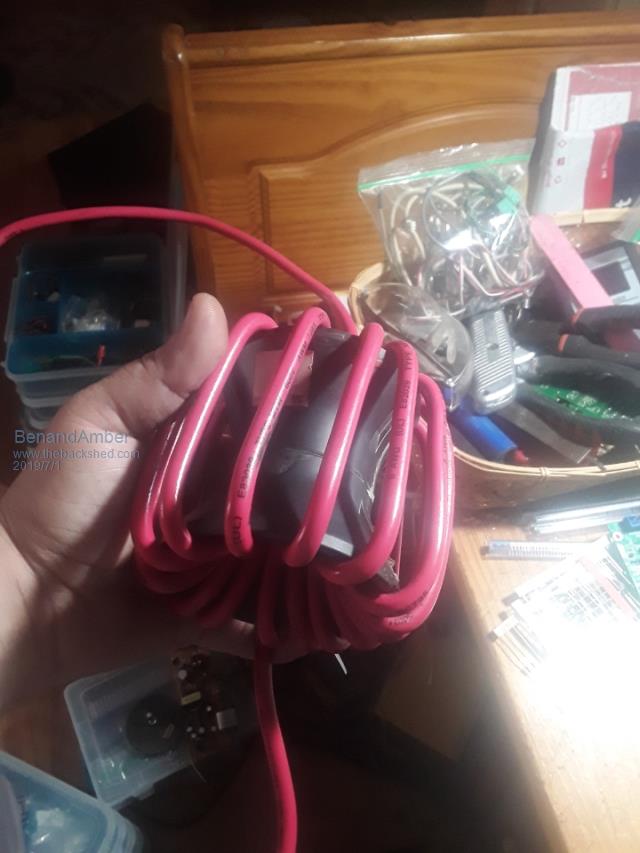

I wound this choke 15 turns of 6awg
This gave me around 220 uh
What would be the effect of using a choke with more than the recommended uh
And what have you guys figured out about chokesEdited by BenandAmber 2019-07-02

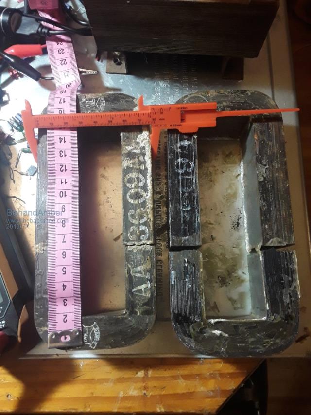

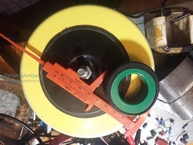

That green one there is out of a 2018 Power Jack
I I guess I'm going to try winding them both of these
Now that I have extra wire might as well have a few extra chokes
I am truly scared to death to run the one
I'm using everyday without a ferrite choke
But I will soon have one for experimenting
with
I was thinking of using two like Mark does
My big inverter has a little over 40 watt idle current
If I remember correctly my little one is 29
That was some good reading Mack off Grid
Warp speed is awesome thanks to you two renewable Mark but this one's awful big
I still like to have all of your guys's opinions too though
So what do you guys think of these two besides them being very very dirty they will clean up nicely
That swinging choke is pretty awesome by the wayEdited by BenandAmber 2019-07-02

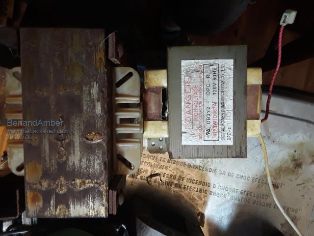

Nice looking C cores. Is that E core from a microwave oven?
BenandAmber
Joined: 16/02/2019
Posts: 961

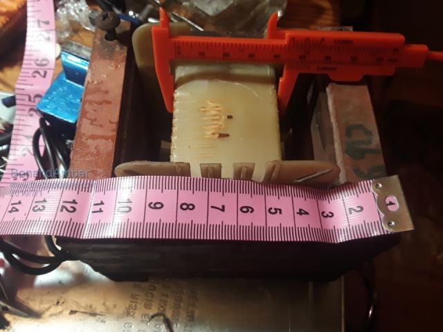

Posted: 02:30am 02 Jul 2019
It's the choke out of a Hobart welder
it don't have any welds on the E I pieces
It's about two and a half times bigger than the microwave Transformer
And it's easy to take apart
So you don't think the C cores will be too big
They are all very dirty but all of them will clean up and look almost like new
I was thinking that might be out of a century welding machine
If so I have the Hobart one out there
1200 Watt microwave oven Transformer and Hobart choke TransformerEdited by BenandAmber 2019-07-03
