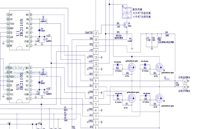

The manufacturer won’t release the schematic. But the dc-ac side is exactly the same as supplied in the egs002 manual bar a few slight differences in resistors values
It’s a reliable 3000w. 12v 50hz 230v

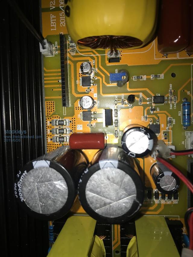

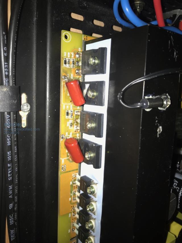

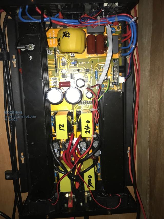

the schematic i upoaded was taken from the egs002 manual but i modified the diodes and resistors to match my inverter. the only thing not shown on it are the 2 capacitors by the igbt,s.
please ignore the poor soldering, i need a new tip for my soldering iron due to replacing soo many igbt's

  stockleys said   the schematic i upoaded was taken from the egs002 manual but i modified the diodes and resistors to match my inverter. the only thing not shown on it are the 2 capacitors by the igbt,s.
If the schematic is from fig 2-1 of the egs002 manual, there is a 0.1 ohms resistor (r24). Maybe it is also damaged.
Also, I think there is a mod on the egs002 board that removes the LM393. Maybe it also applies to this inverter.
