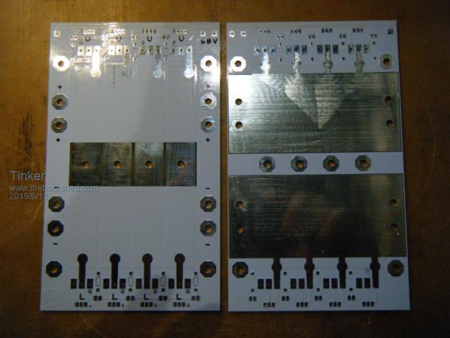

I started this project by winding the big transformer but that turned out in a disaster So I tackled this project from the electronic side first .

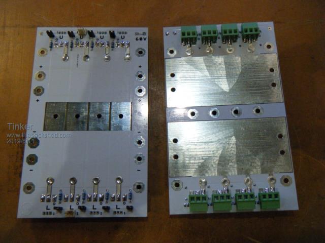

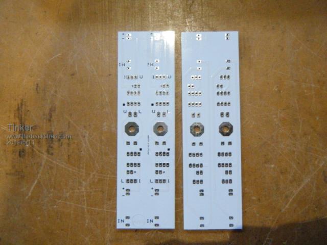

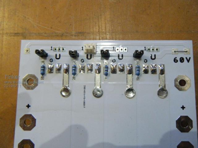

PCB's were first on the list, here is my version of the half bridge board:
Top and bottom side are shown. There are 4 identical boards required. Each can accommodate 4 individual half bridges or be linked to fewer parallel bridges.
Since 2oz PCB's are expensive it made sense to have smaller boards, as one has to order 5 boards minimum anyway. So I have a spare board now.

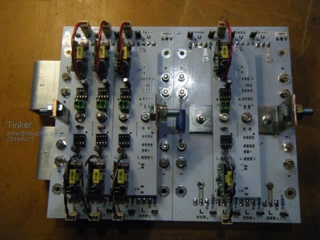

Here is one board populated with its few parts, top & bottom side are shown:
And here is a close up showing warpspeed's clever method of boosting narrow tracks with the help of solder lugs:

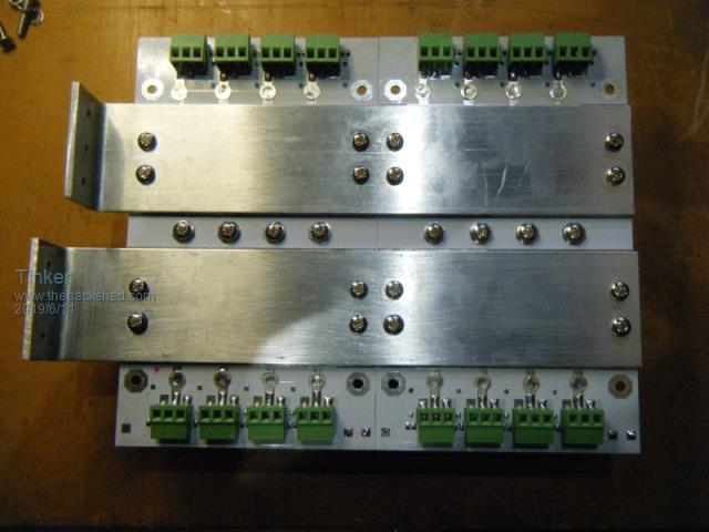

Now I have added the50x3mm alu bus bars for the power rails on the bottom side:

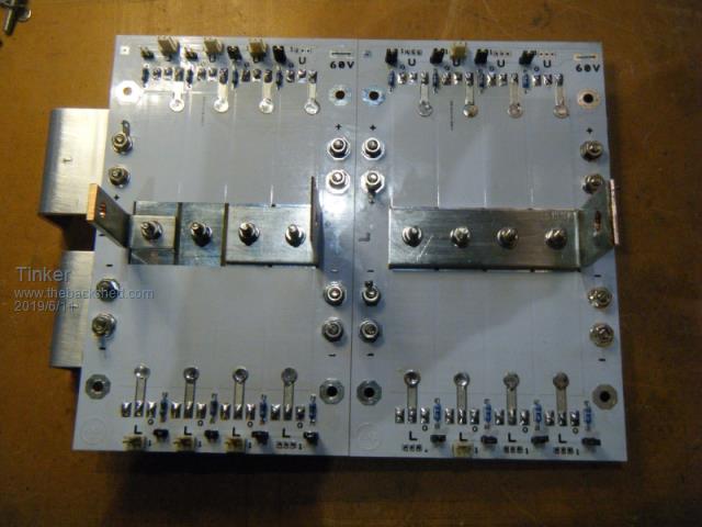

On top are tinned copper bus bars for the transformer connection. The sequence of the drivers is, from left to right: No. 3 transformer, No. 4 transformer, No. 2 transformer, No. 1 transformer. No.1 is the biggest transformer and has 4 x 4 parallel mosfets. No. 2 transformer has 4 x 2 parallel mosfets.
So that shows two of the half bridge boards, the other two are identical.

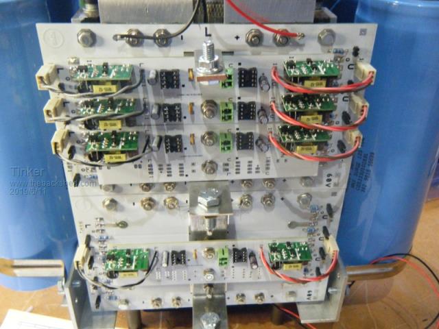

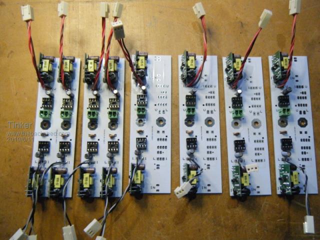

Now I also need some driver boards:
Top & bottom side shown, I made these boards as double half bridge drivers for space reasons which can be seen on the next pictures.
Here is the full complement of driver boards for my warpinverter:
Some are fully populated with parts, on others only half the board is used. The next picture shows why, The power boards have a simple way to parallel Mosfets by inserting a header shunt to link the gates and by bridging VS tracks with a busbar.

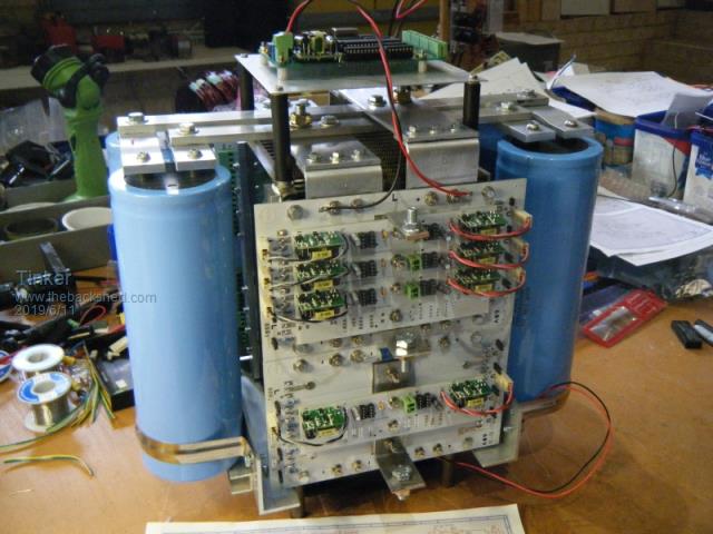

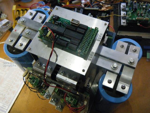

So that were the PCB's I designed. There is another, the control board, which is warp's design and shown on the final pics below.

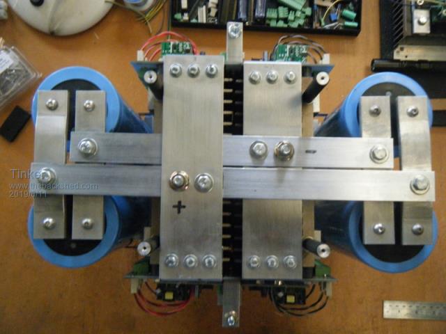

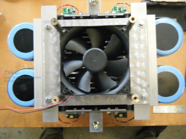

Now the lot was assembled to two identical size heat sinks (one 3KW Aerosharp heat sink cut exactly in half). First is a picture looking from the bottom end, showing the 120mm fan:
And to connect all those busbars together we have 'busbar junction' at the top view:
BTW, I used 'Alminox' to prevent the mating alu surfaces from oxydising.
Now a side view to show how it all fits together. The view from the other side is identical:
Here is a close up of the boards:
And a top view with the control board in place:

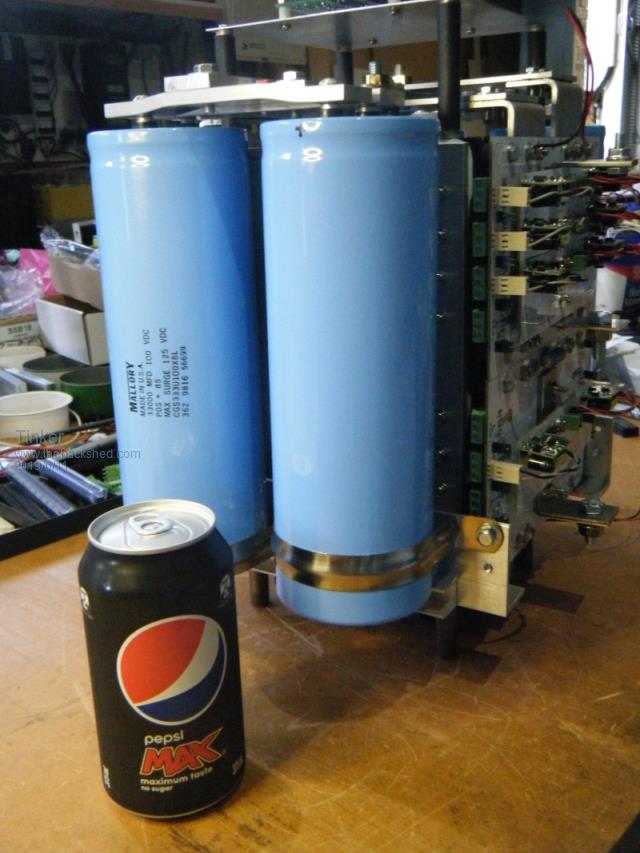

And lastly a picture to compare the size of those gigantic capacitors with a Pepsi can:

Very unlikely Mark, At a guess it will weigh well north of 50kg when its finished. But it does look like a satellite with rocket boosters eh?

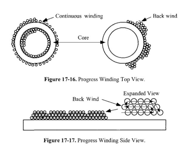

Tony has mentioned that the way the secondary wound tightly to the large toroid core may make the capacitance so much higher. Below is one method of reducing winding to core capacitance.
Transformer & inductor design handbook ch17
