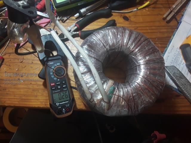

This Transformer is the one that I made out of several small ones
I unwound all the small ones and rewound this bigger one on a sewer pipe as a form for the center
Here is the chicken scratch on it
I fired it up with a light bulb no low side primary on it yet
The clamp meter said 0.37 amps
Me and another friend on here thought this was really high
So I found a scrap piece of wire and wrapped nine more turns on it just to see what would happen
Here are the results

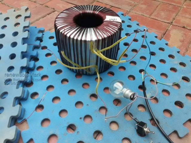

Ben, when I have wound toroids, I wound the secondary (240v output) with 2mm2 wire.
To get the amp rating up 4 secondary winding's got used.
And the output of each one got paralleled.
Fortunately all 128 windings fitted on one layer, so it ended up with 4 neat layers of 4 secondary windings all exactly the same number of turns.
Each secondary had exactly the same number of turns, (128 secondaries to suit 240v)
That toroid ended up with 14 turns for the primary(48vdc) winding.
That is the idea of doing the light bulb test for soft start and making sure the voltages across the loose ends are the same before you solder them together.
This is the instructions from Oz I went by to wind my toroids.

I wound 10 more turns to the 9 turns I wound previously and got it down to .21
so for 10 turns I got .04 more reduction
Seems like diminishing returns to me

I wound the toroid until it got completely filled up
this was my first layer
I epoxy it and then wound two layers of Transformer tape
then wound my second layer epoxy it and then wound 2 layers of Transformer tape
I wound it like one single long winding of big wire Square wire not round
I think it was a little over two mm by 2 mm
So it should handle more amps than the core

Are you shorting out the light bulb after the soft start?
You should have a switch fitted across the bulb terminals.
Have it open to do the soft start, then close/short the switch to eliminate that from the circuit.
BE CAREFUL DOING THIS, VERY EASY TO ZAP YOURSELF.Edited by renewableMark 2019-06-15
