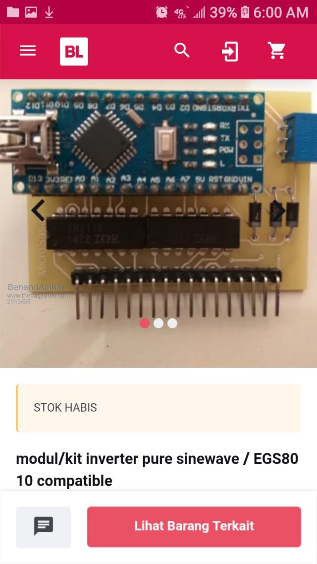

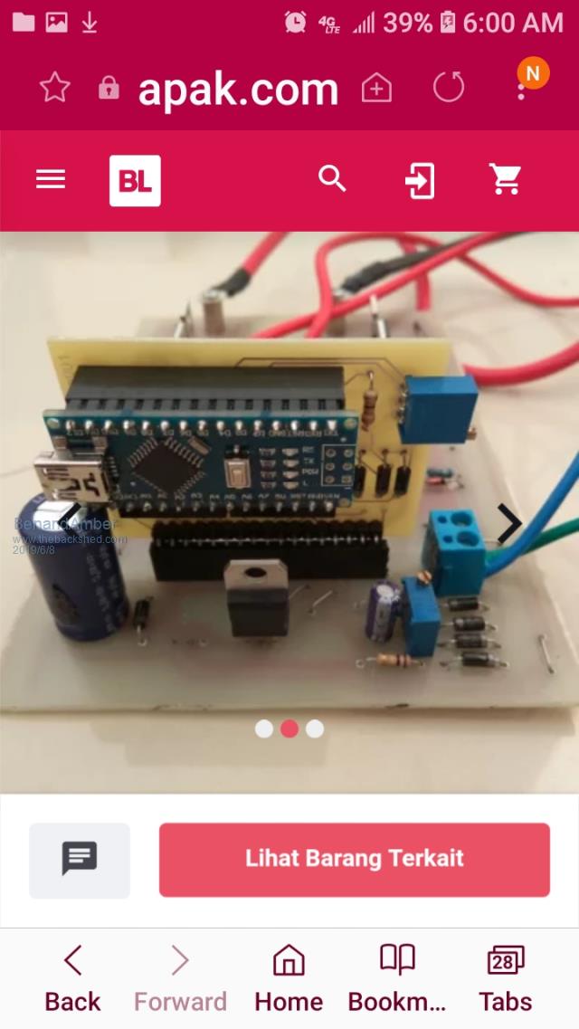

I don't know nothing about this one it was in a different language
the ad said this oo2 board had totem pole drivers built in
Funny what you come across when looking for capacitors

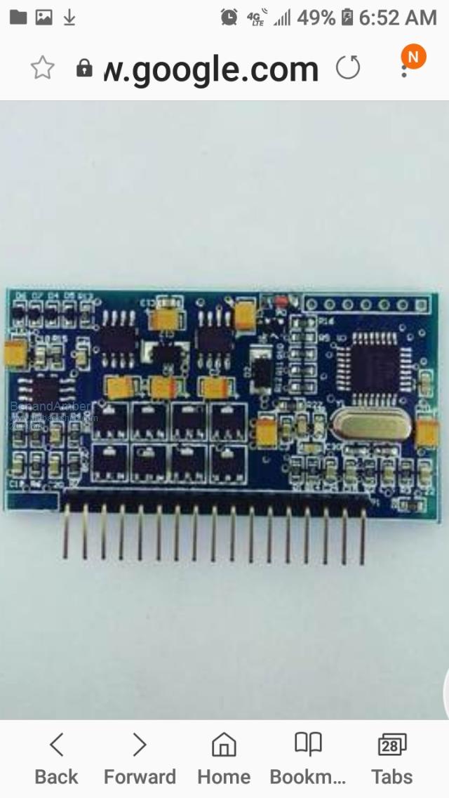

I think everybody already looked at this post and didn't have anything to say
I was interested in what you guys thought about the one with the totem pole drivers build on to the little oo2 board

Good find Ben - Looks like the Chinese guys are watching the Back Shed to decide what to come up with next. I wonder if they have also improved the code in their micro-controller.
I note that it doesn't have the anti cross conduction transistors now so maybe some of the poorer behaviour has been fixed or improved. The second one probably has Poidas code in it.....

Found it here
Crafty little bugger, yeah, bet it does have Poidas code.
They should have put the 2110's in sockets.
$15 AUD
BTW if you right click on a page with a different language there is an option to translate to English. (That's Indonesian.)
Just noticed it said item has been deleted.Edited by renewableMark 2019-06-10

I'd like to find out some info on the other one the oo2 board with the totem poles drivers on it

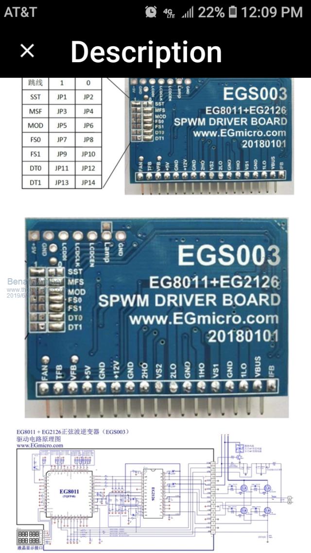

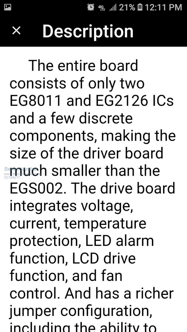

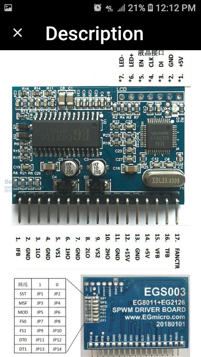

They've came up with another control board

Here is the Link
and the manual download
MikeEdited by Solar Mike 2019-06-18

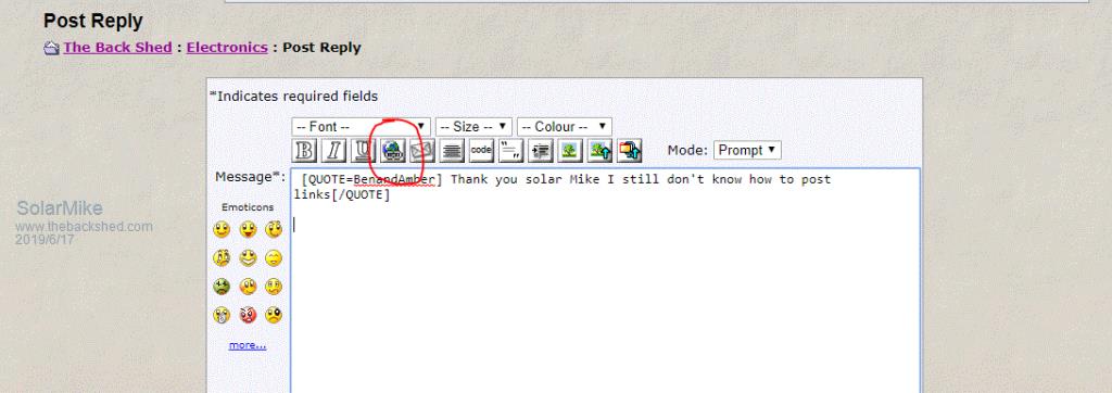

Thank you solar Mike I still don't know how to post links

Not difficult, see the menu button highlighted with the red circle, click that and a popup window appears; enter the text that will be underlined as the Link; then click OK.... another window pops up, place a copy of the URL address from your web browser and press ok.

Thanks for posting the initial post, that board uses a new version of the older EG8010, its now a 48 pin chip running from a 20 Mhz crystal and new software, now called the EG8011, the HBridge driver has all 4 drivers inside it. PWM frequency is now 20Khz.
I have ordered one to have a play.
Mike

Very interested in your results from your study of this new 002 board
If you have the time please post it

egs002 compatible
Another with totems built in. ..
I think it works !!

They are learning, however the totems should be near the mosfets, not on the control board, and the tant caps on it are not really suitable for this application.
