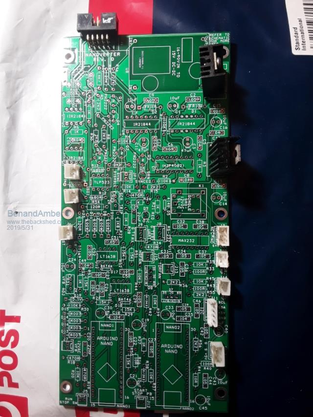

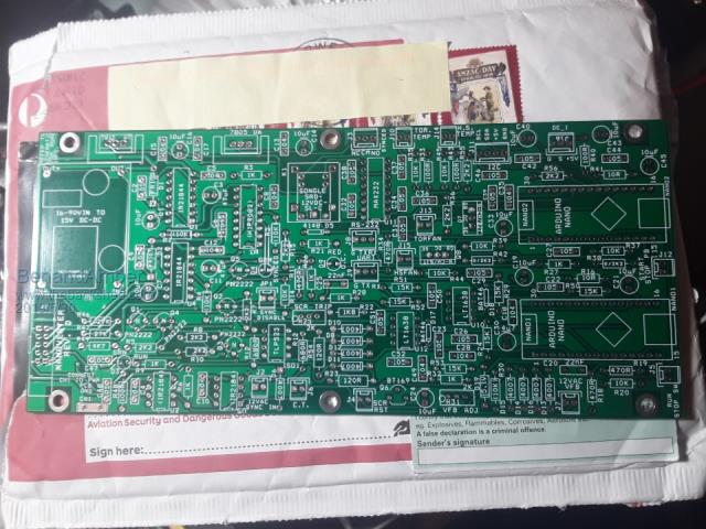

Got my Nano control boards in today
thank you much poida the great
They look absolutely perfect in every way
As you can see every last bit of the board was used
It looks like all the component values are on the board
That should make it a lot easier for someone like me to put it together
I'm so excited and overwhelmed at the same time
I've never done anything like this before
I do have a few questions
Is there a list of all the components somewhere that I can copy to make sure that I don't forget anything
And I've heard that there are a few different versions of the Nano is there a certain one I need to buy
And will I need to buy something to program the Nanos
I sure hope I'm not in over my head
I got a lot of determination and I want this really bad
Happy happy joy joy so excited

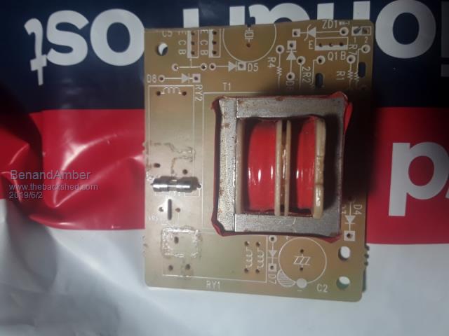

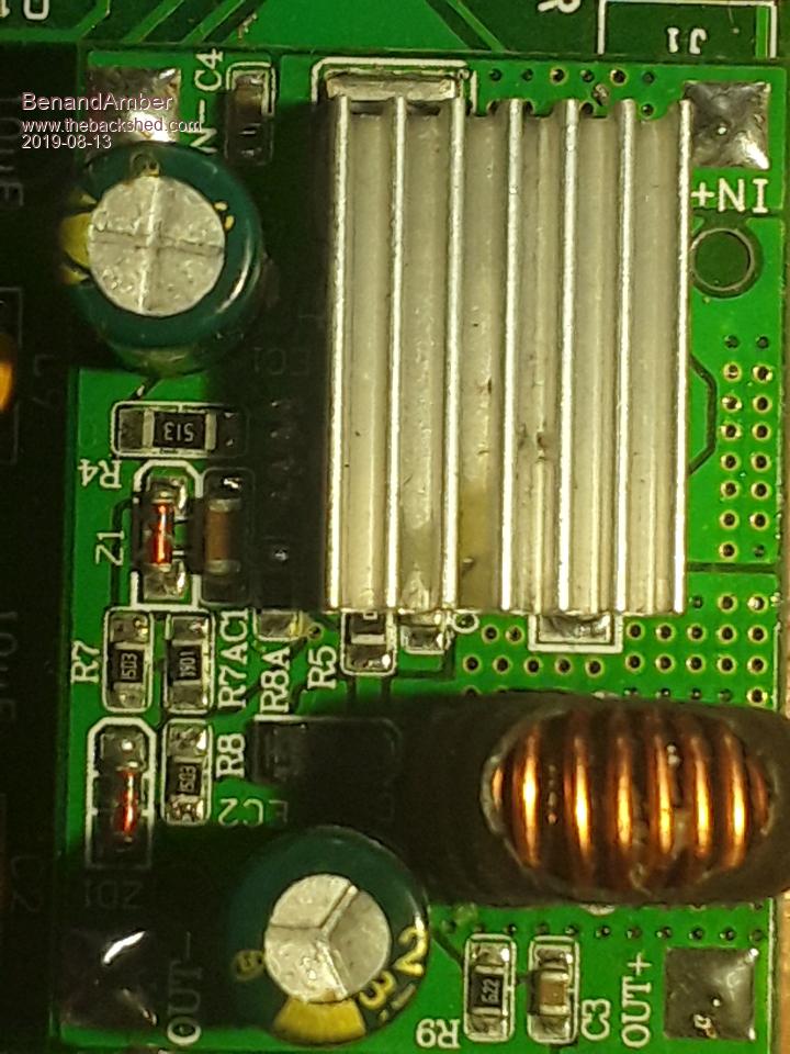

This is part of a air conditioner control board the little Transformer puts out 12 volts
I was thinking about using it four voltage feedback I put a little 1 amp fuse in there just in case

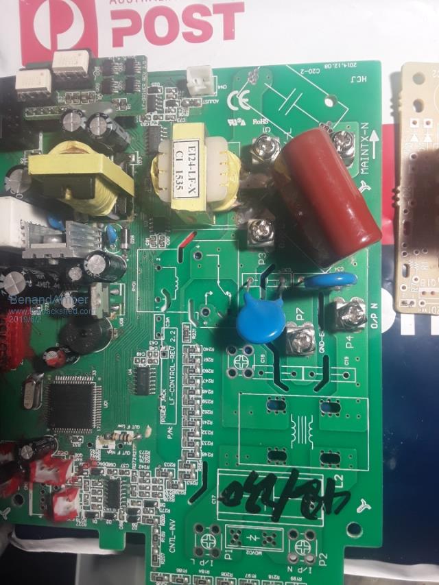

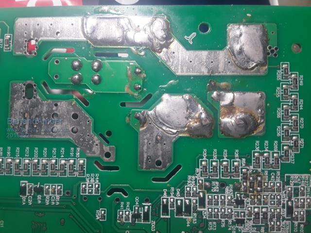

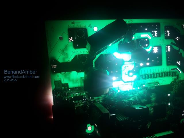

This is the control board out of the Power Jack 8000 watt inverter
I'm building this control board for
It looks to me like one side of the AC output goes through that little Transformer
If I'm not wrong about this then this is just nuts
The only reason I was looking at it again was to maybe Rob the little heatsink off of it
There's nothing wrong with this control board besides it being 230-volt and it being a power jack poor designEdited by BenandAmber 2019-06-03

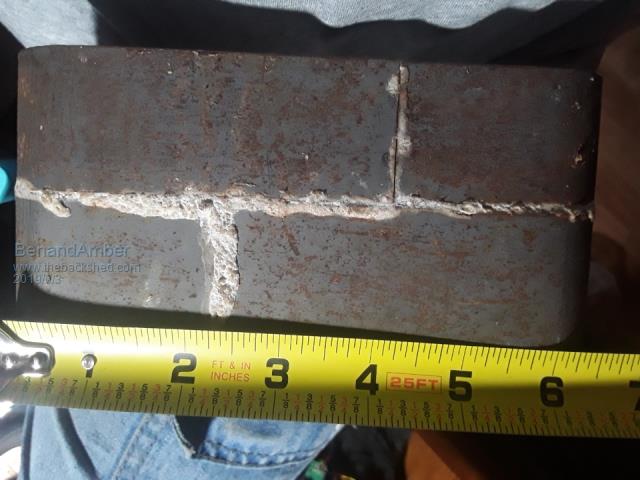

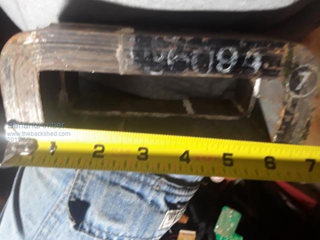

Does anybody have a idea on what to use this Transformer core four
It is super glued with baking soda together
I can get it back apart without damaging it
the baking soda makes
the super glue dry instantly
It was originally two cores side by side with the windings going around the two Center legs
It was in a container full of oil
Several years ago I was thinking I was going to wind it like a toroid
To experiment with but never got around to winding itEdited by BenandAmber 2019-06-04

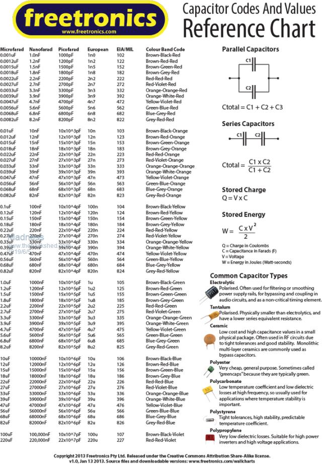

105 is the caps value (1uf) so yeal all 105 caps are 1uf.
I don't know if they are all 50v, I would assume not though, just type in what you need and it should pop up.
Monolithic and ceramic are different types BTW.
Lead spacing probably doesn't matter much as long as it's not ridiculously different.
