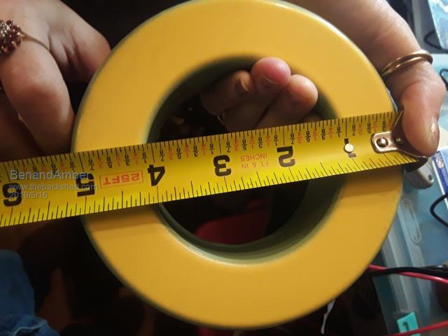

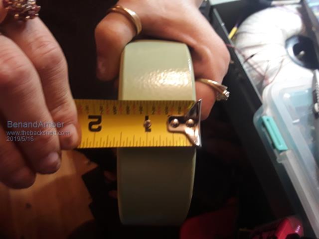

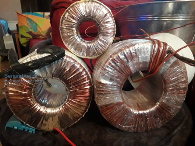

would this Transformer be good 4 a
warpspeed inverter
It came out of Amber's 8000 Watt 230 volt Power jack inverter
And if so which one of the three Transformers that a warp speed inverter uses
would it be good for and how many wattsEdited by BenandAmber 2019-05-16
Posted: 10:45pm 14 May 2019

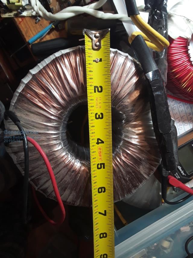

Very difficult to judge.
You would need to strip off all the wire and measure up the bare core.
From that you can then calculate the required number of turns on both the primary and the secondary.
Then its a case of working out what wire sizes will actually fit onto that core while still being able to reach the required number of turns.
Trying to guess all of that from just a picture is not really possible.

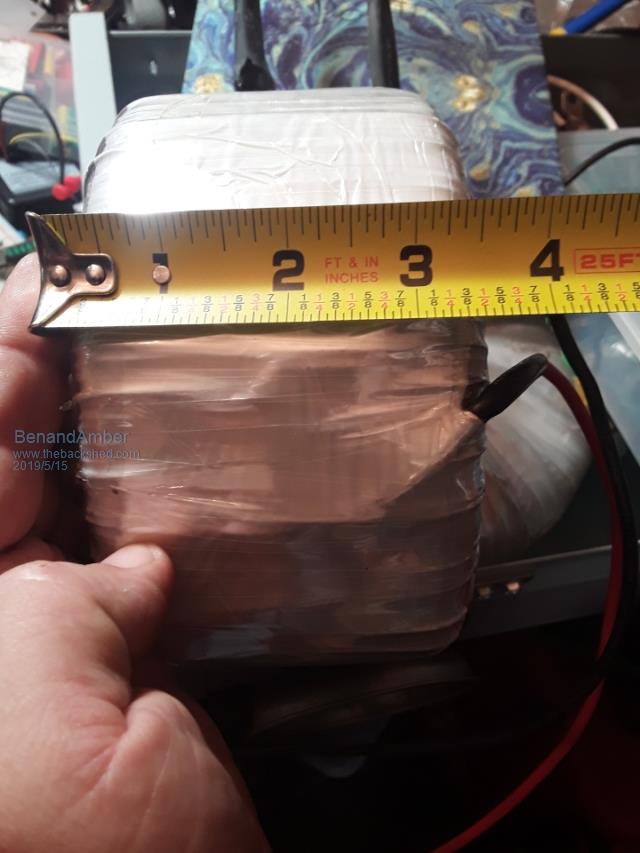

The core itself does not really have a direct power rating.
Power rating only refers to the allowable maximum "safe" temperature rise, and its the wire that gets hot, not the core.
How you decide to use that core will determine the final continuous power capability, and thermal mass will pretty much set the surge limit, assuming your mosfets or something else does not blow up first.
Its fun to speculate, but it really comes down to measuring it all up and deciding what is practical as far as the number of turns required, and the wire sizes that will actually fit through the available hole size.
There is no simple one step formula to tie all these variables together. Its an iterative process where you try a whole lot of different combinations, juggle the figures around, to try and reach something you feel is practical to finally build.
I can only suggest that you base your design on 1.0 Tesla (10,000 Gauss) flux density in the core, and 4 amps per mm squared current density in the wire, or figures reasonably close to those.
Those figures will tell you the number of turns and the required wire sizes. If it will fit onto the core, fine.
If not you will need to change something until it will fit.
Its no good showing me a picture of some transformer and asking me will this handle xxx watts ? I have absolutely no idea.

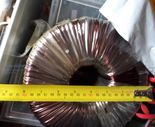

Looks like a decent size Ben.

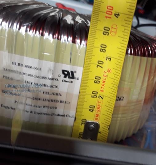

Here are some pics of a fully wound 3kw aerosharp 240v for size reference.
Like Tony said it will depend on stripping it, doing calculations and rewinding it to know exactly what you have.
Looks like a reasonable size and there is still a 2.5 inch hole in the centre on yours.

Once you have stripped all of the wire off a candidate toroidal core, you then at least have a fighting chance of making a GUESS about the power capability.
First thing is to measure the core cross sectional area (height x width).
If we decide to use 1 Tesla as our design flux density, we can use one of the many on line flux calculators to give us a figure for volts per turn.
It might be somewhere between 0.2 volts per turn for something small, and 1.0 volts per turn for a monster toroid. Or even something outside that range.
Let's assume 0.5 volts per turn in this example.
Second step is to measure the hole diameter, and convert that to area using pi R squared. This might be a three inch hole, say 76.2mm diameter. That works out to 4,561 square mm hole area.
The only thing we can say for sure, is that a well designed transformer has equal copper areas in the primary and secondary. The turns and wire sizes will be different, but the total copper area (turns x wire areas) should be close to being the same.
So if our hole has 4,561 square mm total area, we can allow half of that or say 2,280 square area for each winding.
Now here it starts to get a bit hairy, because we cannot totally fill all of that available area with copper. The wires are round and there will be a lot of wasted space between turns, and also layers of necessary insulation to account for.
A single perfect winding can approach 60% copper fill. For home brew it will probably be closer to 50% copper fill, and if we allow for some layers of mylar tape it could fall as low as 40% copper fill.
So we place our bets and to be safe assume 40% copper fill of our 2,280 square mm of available hole area.
Now we are only trying to guess the power capability of this core, not design an actual transformer.
So let's start with 40% of 2,280 sq mm = 912 sq mm of actual copper in one winding.
And lets further assume we fill that space with 912 turns of 1.0mm squared copper wire.
Now we have already worked out in the very first step that we can run the core at 0.5 volts per turn, so we will have a 456 volt winding with 912 turns.
And if we make our wire current density 4 amps per mm squared, we can safely load our 912 turn winding to 4 amps. S 456 volts x 4 amps = 1,824 watts (or more precisely 1.824Kva).
Now we might not want a 456 volt winding.
But we can fit fewer turns of larger wire to get the voltage we want, but it still can have no more than 2,280 copper area.
One third the turns of 3mm squared wire will still work out as 1.8Kva, as all we wanted to do here is get a rough power estimate. If it all looks good, we then start to work out our final correct turns and wire sizes.
Now maybe 40% copper fill is pessimistic and it will all fit easily with room to spare. Maybe we could have risked 50% fill and got away with it, or maybe not.
It all involves a lot of guessing even if you have the exact toriod dimensions.
Being shown a picture of a fully wound transformer and having no idea of the core dimensions its just not possible to come even close to guessing.

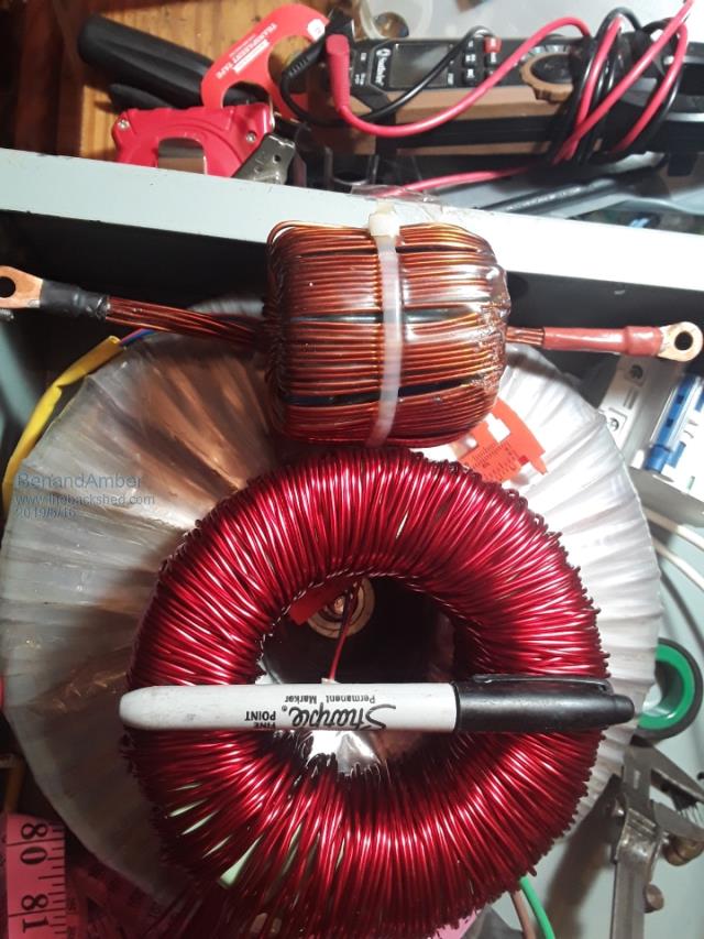

The Transformer on the left is the Transformer out of the 8000 watt power Jack
the Transformer on the right is the one I'm in the process of winding
it will be replacing the one that's on the left and be put back into the Power Jack
it only has 44 turns on it so far and it will have 100 to 110 turns when done
it's the one I made from a bunch of little ones
the one on the top is almost identical to the ones I tore apart to make the big one
The really nice Big tin in the background was a gift from a really awesome person

Yes its complicated.
And its why when you ask what can a particular transformer do, nobody is going to be able to be able to give an exact answer from just a picture.
If you are serious, strip it down to the bare core, measure it all up, and THEN ask the question.

Did nobody see those ginormous ferrite choke
I got worried that the wire wasn't big enough on the original one I made for my 10000 watt inverter board
The little one in this pic is the first one I made it has 10 2 mm wires as one
The big one has 16 in hand or whatever you call it made in one
I hope that wires big enough I don't know how to do pie squared so 2mm is just the single measurement
And it's round wire
The Transformers wires are still way bigger yeah it has two 2awg wires in hand
So four all together for the low side of the Transformer
I am hoping to get 4 to 5000 watt continuous
Even though I probably won't be using over 1500 watts most the timeEdited by BenandAmber 2019-05-18
