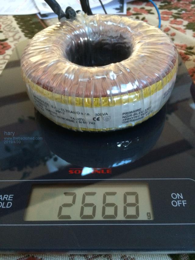

I found a small toroid 230V/12.6V 300VA transformer that weight 2.6kg with copper wiring (if that information is of any use).
As I'm planning to make a small DC24V/AC230V inverter, I think the secondary and primary are very close to what is needed for my need.
What do youthink and what power inverter can I expect from this transformer ?

I had a little under 20 them just about the same size as yours
I gave a few of them to friends
And a few of the other ones I unwrapped and made a bigger toroid
I've been told by some of the greats on here that wire size has the largest part in how many watts you can get out of a transformer
With that being said most Transformers ratings in watts are a little under the VA
if I had to guess and by the way there's a lot better people on here to guess
I'm guessing 250 watts
I've had people on here tell me all about my Transformer with just a picture no info
And it would be very very close
If you can get your hands on a few more of these you can unwind them
and make you a big Transformer with a big hole in the center for big wire

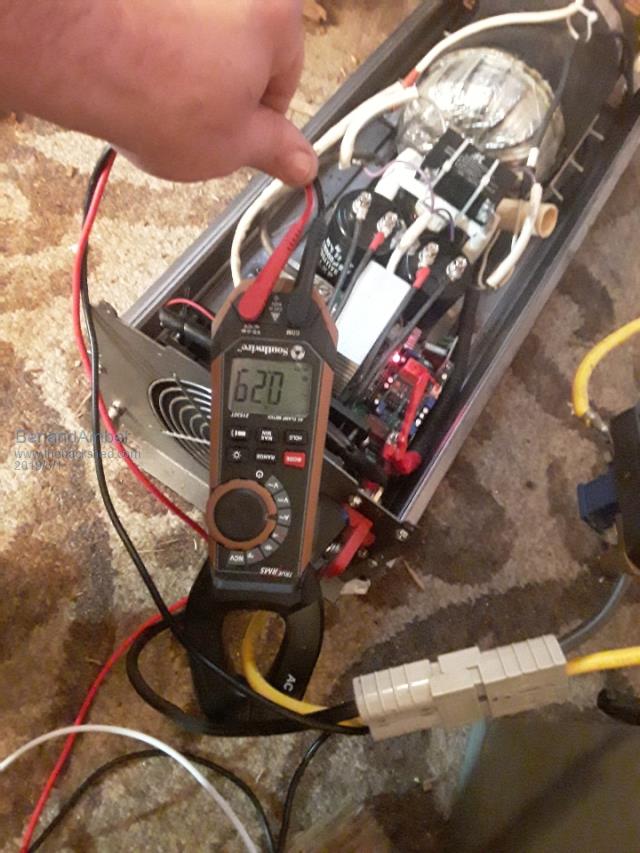

I've been using the heck out of this little four mosfet inverter I have
thanks poida

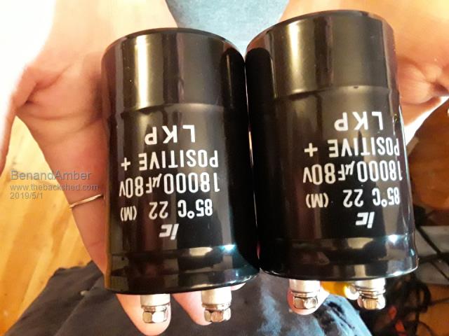

I ran a small air conditioner about 2 hour couple days ago that's along with a chop saw occasionally circlesaw occasionally Sawzall occasionally
I put two big caps in mine
How long it'll last before it goes pop I don't know but I am surely impressed with it so far

I've ordered this one
But it's already with caps ! Should I get bigger ones ?

I've the board
I've the toroid I've shown you.
I'm now trying to figure out the right TVS diode I need.
Any thing else ?
BenandAmber
Joined: 16/02/2019
Posts: 961
Posted: 06:51am 01 May 2019
I have a post called Little China inverter board got to go read
Poida tells how to make it Bulletproof
I put Hy 4008 mosfets in mine along with everything poida told me to do
It has for Transformer cores about the size of yours stacked up made into one
That's pretty good idle current also I thinkEdited by BenandAmber 2019-05-02

hary
Joined: 15/04/2019
Posts: 89
Posted: 07:09am 01 May 2019
  BenandAmber said   I wonder how much postage would be to France the USA West Virginia I bought extra diodes and mosfets
Really nice from you but I think postage from USA to EUROPE is quite expensive.
I'd better get electronic component from China often with free shipping !
At the moment I'm wondering if I absolutely need unidirectional 15V TVS diode or if I could put bidirectional instead as they are easier to find ?
I was not thinking replacing the EGS002's mosfets china power board with HY4008 by now.
Should I order some ?
I remember from some reading from your post about the small china board it was not on the "must do" list. I remember more about TVS diode to protect mosfets' gate driver and disabling all the overcurrent protection to avoid fast damageable STOP/START behavior.
My main problem is toroid availability for now. I've only a small one and don't know where to source some more and/or bigger ones.
BenandAmber
Joined: 16/02/2019
Posts: 961
Posted: 07:35am 01 May 2019
Poida is the man what he says is the gospel
Make buddies with him and he'll tell you anything you need to know
If it was me I would definitely go with h y 4008 or bigger
You'd have to ask poida but I think you're going to be surprised at what you can start with that if you have big enough caps
From my little bit of almost no experience I would put the biggest wire I could on that little toroid that's if I couldn't find another one
The power jack units you here people talking about a lot of times have big capacitors and a small toroid
they start some pretty big loads they just get hot pretty quick
a lot of the times you won't be needing to run a big load very long just mainly to get a big load started
So big wire and big capacitors and big mosfets if you can't get big toroid
Just remember before you do anything or spend any money you better ask somebody else because I am literally just a hilljack hillbilly with no experienceEdited by BenandAmber 2019-05-02
