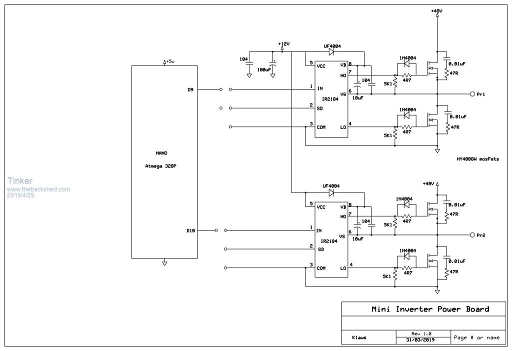

This is the nano inverter without totem pole drivers:

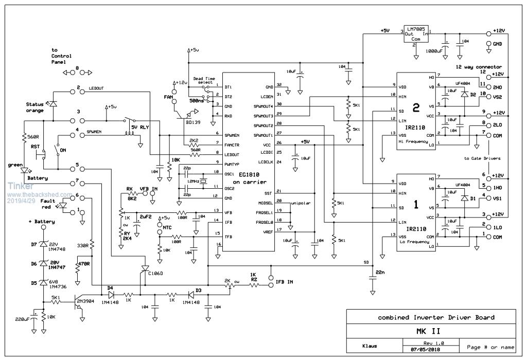

And here is the original EG8010/IR2110 control board.

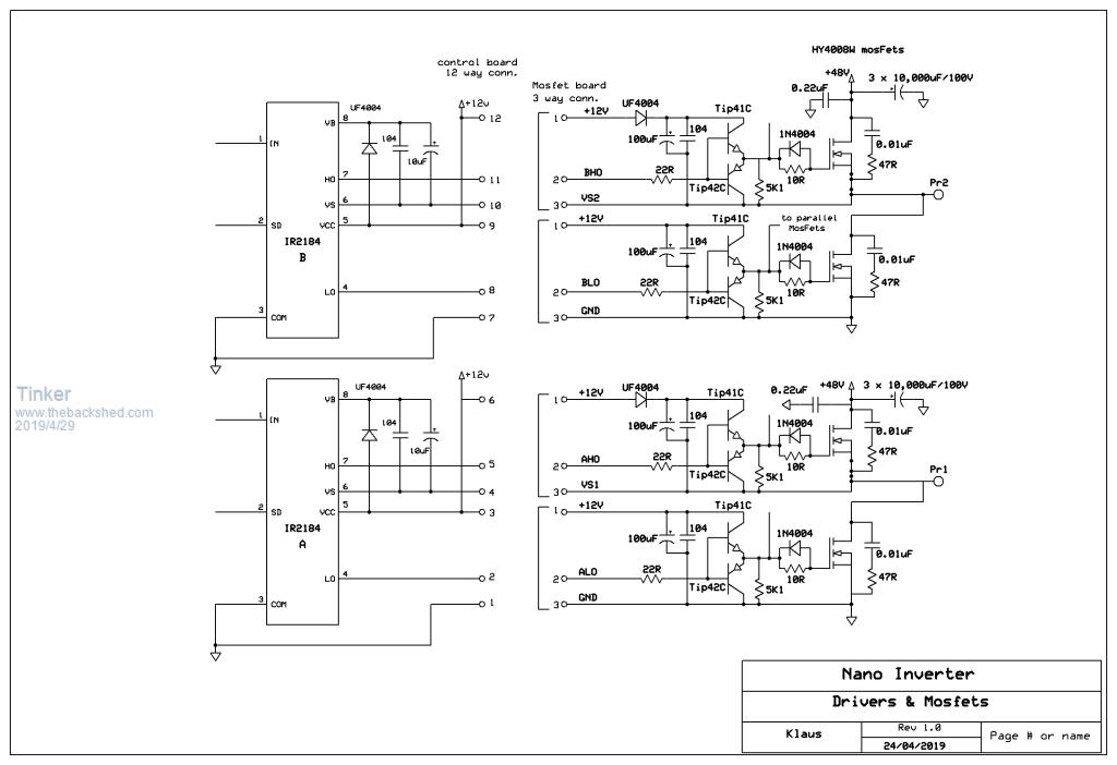

To be replaced by the nano board, the totem pole drivers are at the right side and these are the same the EG8010/IR2110 board connected to:
Note the connections are done via a 12way header cable that has 4 x 3way headers at the far end. I use the same cable, making sure the connections on the new nano control board correspond.
I copied the charge pump +12V supply as it was at the IR2110 drivers, did I go wrong there?

Looks like the A\B H0 totem pole V+ 12 volts supply if derived via the charge pump should go to the VB output of the IR drivers (Pin8), you have it wired to Vcc +12v.

Thanks for that Mike, you confirmed my suspicion. Unfortunately have to wait now until the next batch of HY4008's arrives to confirm. This gives me time to modify that PCB, its a blessing they are so cheap in the 100x100 size.
The strange thing is, if you look at the original EG8010/IR2110 schematic, the totem pole used there (not shown on drawing) has its own +12V and not from the VB at the IR2110's. It works fine there.
I guess the IR2184's are different.

I dont concur that you made an error by not joining the VB to the totem pole+.
If both charge pump diodes are installed, both nodes should be near identical as they should both charge to the same +level - it cant do any harm, but I am not confident it is actually fixing a problem.
The buffer stage only needs a ground referred input drive level to function correctly IMO.
Whilst a buffer stage helps to drive the FETs better, the TIP41/42 would not be my first choice either, they have a turn on time of 0.6uS, turn off 1uS, storage time is not given but would also be slow at >1uS.
When dealing with FETs I dont like stuff switching too slowly as dead times can be impacted. For instance the 2SA2210 has turn on 60nS, storage time 220nS and turn off 20nS. That is 10 times faster on, 50 times faster off, 5 times faster in between, a gain ~ 100 and 20A current capability all for $1.50.Edited by wiseguy 2019-05-01

I agree, those Tip 41/42 are pretty slow, they really were only used in older style audio amplifiers and are now dirt cheap. Faster devices would be beneficial, initially their use was suggested as the circuit was cloned from an existing Chinese 6KW inverter board, which used a pair mounted a CM or so away from each group of parallel mosfets, all of which were many CM's away from the IR driver chips, giving at least some improvement in drive; I think we can do better...

And I agree with you Mike, yes I did just copy the totem pole arrangement I saw posted on this forum somewhere sometime ago.
Can you suggest a suitable fast TO220 NPN, PNP replacement with a BCE pinout? If they are easy to get and not cost too much I'm happy to swap those slow transistors.

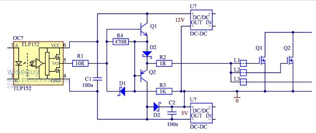

Here is the gate drive that drives the gate to ~ 11.5V and when off it holds the gate at ~ -4.5 (note a 12V supply in lieu of the 5V could be substituted for more serious neg bias). I will breadboard it soon to prove the concept and switching speed etc.
I decided to do a discrete buffer instead of using the MIC4452 so I could incorporate a gate clamp in the absence of power. Only the Low side FETs for both lower legs of the Bridge stage will have the negative bias/clamp circuit and they would both share the same bias supplies.
I know its a bit ugly but all the bits actually do stuff. It is essentially an emitter follower current driver and an active gate clamp. I believe it will survive a turn on event without charging the caps first (cant say how the contactor would like it though)
Edited by wiseguy 2019-05-02
